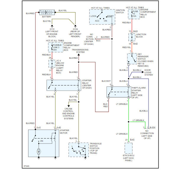

Now, what would be really helpful is when it doesn't start, is to check if the starter is getting power at the solenoid when the key is in the start position. If you can do that, it will really be helpful. Here is a link that shows how it is done:
If that isn't the issue, we need to check the starter relay. Keep in mind, a starter can work one time and not the next. I attached a picture showing which one is the correct one to test. Here is a link that explains how to check a relay:
To be honest, my first suspect is a weak connection at the battery which is improved when a jumper cable clamp is put on it. So, check that first.
Here are a few links that may be helpful to you. I figured I would add them in case you need them.
Check out the diagrams (Below). Let us know what happens and please upload pictures or videos of the problem.

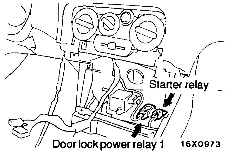

And behind my radio there are two relays which relays are they? I was thinking the power door locks and maybe starter relay?

Okay, do you have a voltmeter to do some testing in the starting circuit?
Check the fuses listed for power on both sides.

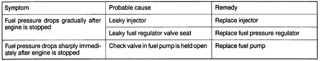

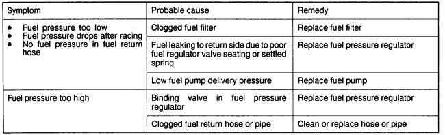

Could it be maybe the fuel filter? I have had the car for five years now and never replaced it. Before I bought it had been sitting him the guys driveway for five years before I bought it so I was thinking could be that.
Jan 26, 2021 at 12:50 AM (Merged)
  • 110,248 POSTS
Welcome back:
Most certainly it could be the filter preventing pressure issues. Here is a general description showing how to check fuel pressure:
The pictures below show common causes of low fuel pressure or why pressure can drop. Note that one possibility is a clogged fuel filter.
The fuel pressure your vehicle should have is the following:
Measure fuel pressure while the engine is running at idle.
Standard value: 324 - 343 kPa (47 - 50 psi)
