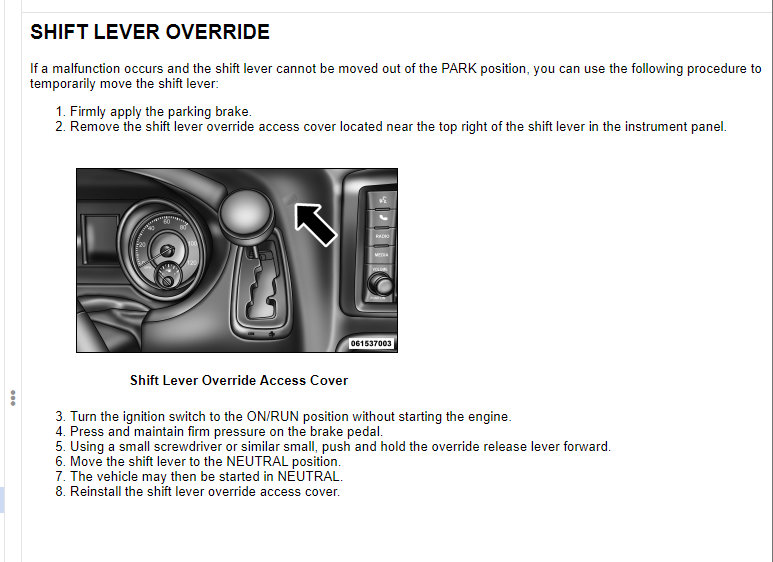

my daughter made a turn in my van after making the turn the van lost power steering then the temperature light, the oil light, the battery light, and the lightning bolt turned on. I had her pull over and shut it off and now the van will not start again. The tow truck pushed the repo key and put in gear now the van is telling me that the van is not in park when it is in park. anti-theft is flashing, and the battery light remains on. please help
Mar 26, 2022 at 9:27 AM
This sounds like we have a couple of issues going on now. First is the shift lever. It sounds like he wanted to put it in gear due to it being stuck in park in order to tow it. If that is the case, then he should have used this override that I attached below.
If he did, then as soon as the screwdriver is removed the lock is re-engaged and it will start operating again.
However, if he removed the shift cable and manually put it in neutral then that is why when the shifter is in park the vehicle doesn't recognize it because the manual valve is still in the gear that he put in.
Next with the theft light on and the check engine light, we should start with scanning for codes.
However, the engine is not going to start unless it is in park or neutral so let's scan for codes after we address the shift override issue.
Please let me know if you know how he moved the shifter, and we can go from there. Maybe get a picture of the way they did it.

Also, he pushed it with a pen and kept moving it straight up and down then put back in park and towed it in park.
