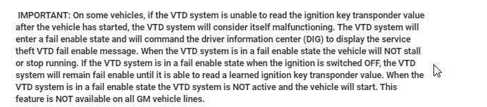

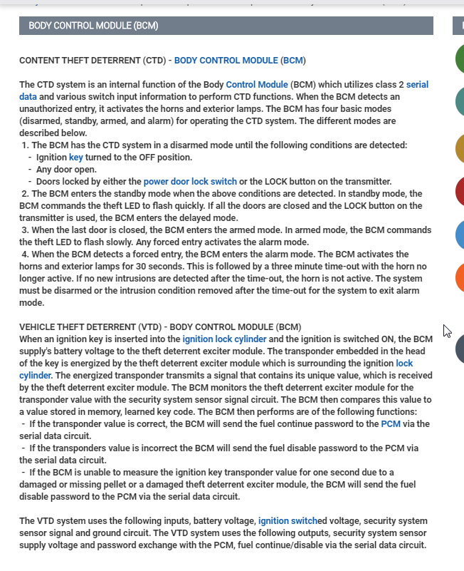

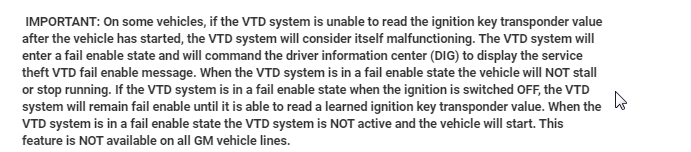

Sure can.
The BCM is called the Body Control Module. Basically this is the brains of the electrical system. It takes inputs from different sensors and then tells other things what to do by sending power to them. For example, if you open one of the doors, there is a door ajar switch in the door jam. This switch is the input to the BCM and sends voltage to it to tell it that the door is now open. The BCM then sends a signal to the cluster to tell it to turn on the indicator on that shows a door is open. It also then sends a signal to the lighting circuits to turn the lights on when the door is open.
In essence, anything electrical on the vehicle has some association with the BCM either directly or indirectly.
