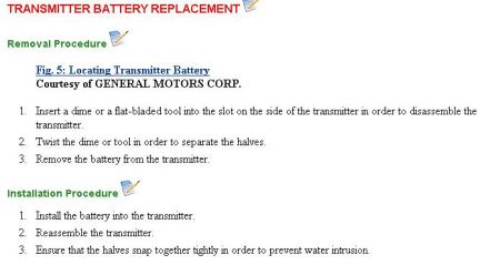

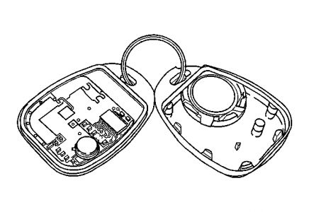

Hello.I have a remote for my alarm/keyless entry/automatic start and the battery has died. Am I able to replace it? Or does the dealer have to do it?
If I am, how do I open it? I've tried prying the sides apart with no luck.

https://www.2carpros.com/forum/automotive_pictures/55316_07grandprixremote_1.jpg
https://www.2carpros.com/forum/automotive_pictures/55316_07grandprixremote_2.jpg

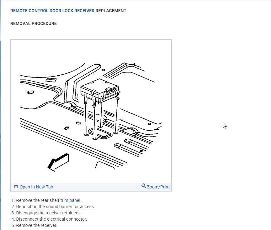

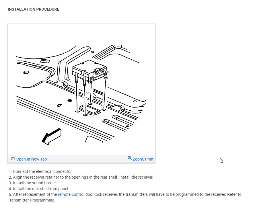

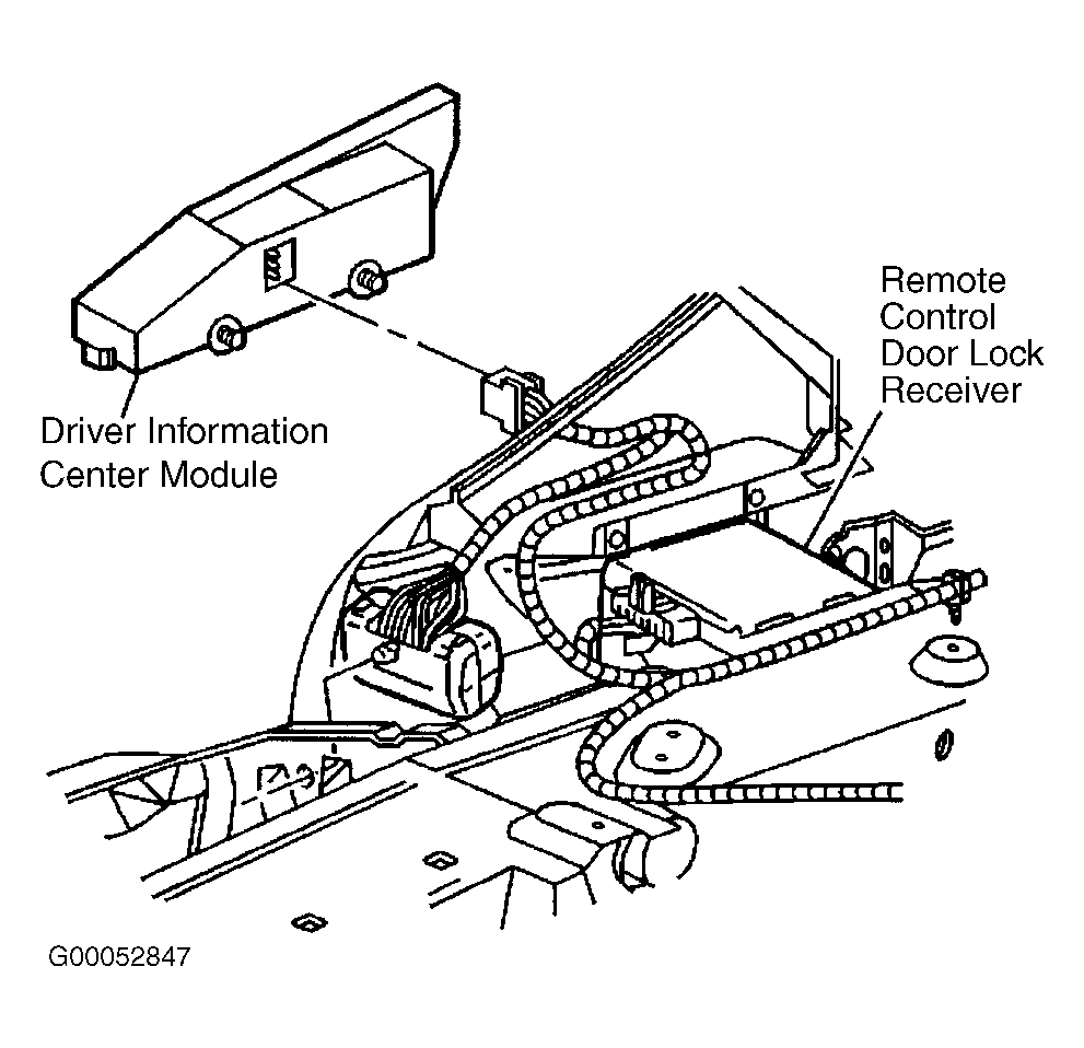

Where is the keyless fob receiver located? I bought an aftermarket remote key entry system from Amazon and need to locate transmitter to swap it out. I've been told it was near the hud, I was told it was by the passenger airbag and also in behind backseat as well as behind or under instrument cluster. Please help I would be so grateful.
Monday, January 11th, 2021 AT 10:52 AM (Merged)
I attached the replacement information which shows where it is. It is on the rear shelf by the back glass. Check out the diagrams (Below). Please let us know if you need anything else to get the problem fixed. Let us know what else you need. Thanks

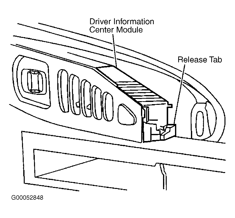

I just bought this car as a first car for my daughter. The car did not come with any keyless remote entry transmitters. I bought some and upon trying to program the transmitters, the car did not respond. I have done a bit of online searching and attempted to locate the keyless remote entry receiver, but it does not appear to be behind the driver infomation center. Some of my reading sounds like the receiver could be located somewhere else but I am not sure how to find it. I am attempting to determine if the receiver exists on this car, or if it was not equipped originally for keyless remote entry. Where else should I look for the receiver? If there is no receiver, is it possible to add it to a car that was not originally equipped with one?

My keyless entry is no longer working. It worked sporadically for a few weeks the totally stopped. I believe it to be a loose or broken wire somewhere. I have been to the dealer and they looked up my car by VIN number and printed a schematic showing me where the part is. I also had my remotes tested while I was there. The part is suppose to be behind the info display above the center vent. The receiver is not located there on my car.
Any info on where the receiver could be? Or ever here of a wire breaking anywhere that would cause the problem?

DOCFIXIT
  • 18,828 POSTS
Right side dash behind inflatable restraint module
+1

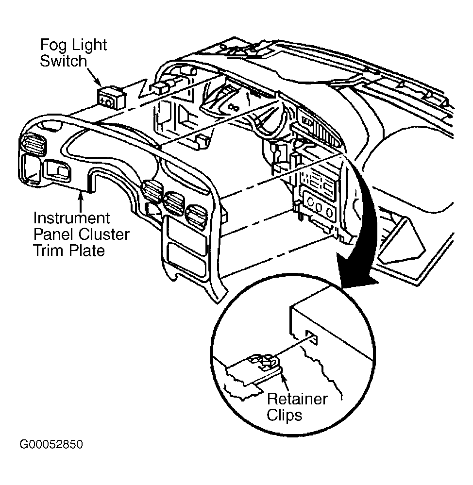

CANADACANDLE
  • 8 POSTS
Thank you for the reply.
Do you know if I can get at it from under the dash without messing with the airbag?
DOCFIXIT
  • 18,828 POSTS
Disconnect NEG BATT terminal see diagrams

CANADACANDLE
  • 8 POSTS
That is where my dealer told me it was and gave me a similar diagram.
My problem is that the part is not there. All that is there is my vent with nothing else. It looks like there is a space where it should be but it is not there.

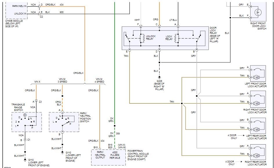

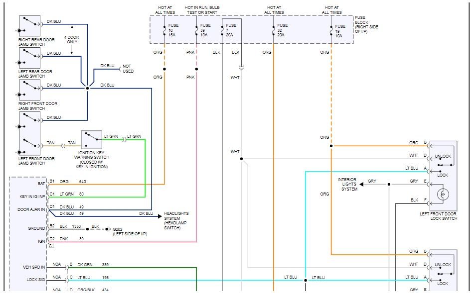

I want to buy a remote key-less entry kit for my car listed above, but I don't know what wires to connect to and I don't want to mess my car up.
Do you have any diagrams for central locking or anything?
MASTERWRENCH
  • 258 POSTS
I've attached a complete wiring diagram for the power door lock system on your vehicle. Most quality aftermarket key-less entry/remote start kits come with detailed installation instructions. Many of them also provide vehicle specific instructions upon request. I would consult the kit manufacturer for further details.
