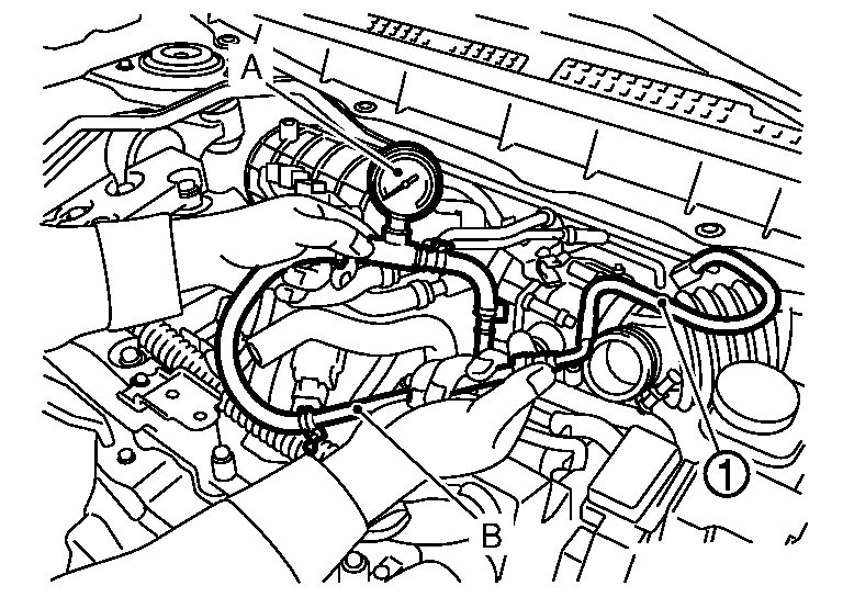

My car would not start for two days then it did this morning twice in a row third time it would not and have not got it to start again since. Battery is good we put a new one in did not help thought maybe starter but not sure now.

Next, since the engine is turning but not starting, chances are either fuel or spark is missing to the engine. This vehicle has very low mileage, so it is somewhat of a surprise you are having trouble, but anything is possible.
In order to check for spark and fuel, you once again need basic tooling. And again, often times a parts store will lend them to you. With that being said, here are two links which describe how to check for spark and fuel to the engine. If you determine one is not working properly, let me know which one it is and I can further direct you.
With the key on, the fuel pressure should be 51 to 55 psi. I attached a picture of where to connect the gauge.
