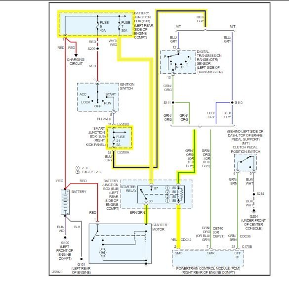

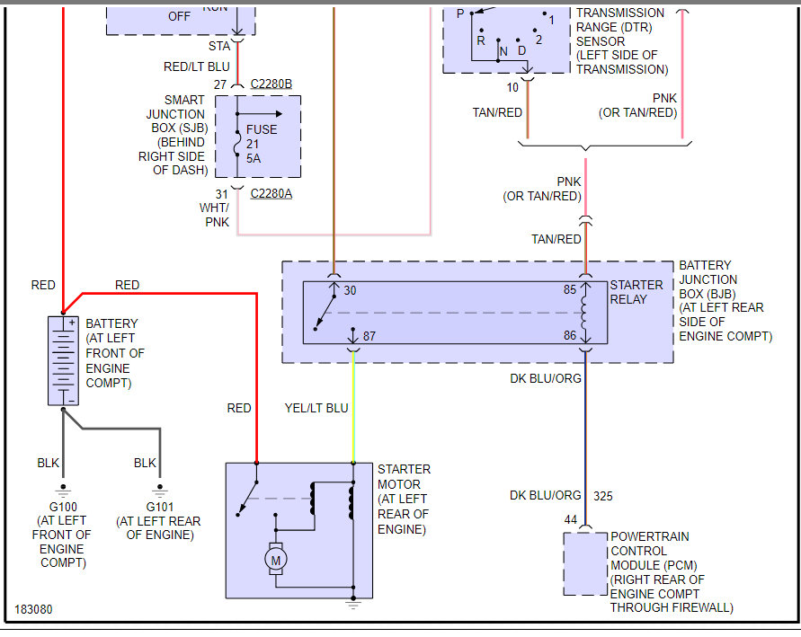

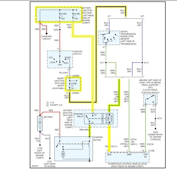

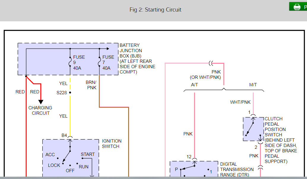

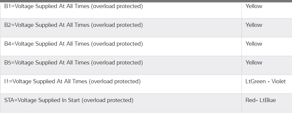

truck will start if pushed however will not start with the key. battery is fully charged. starter was changed and did not resolve the issue.
Dec 21, 2019 at 2:37 AM

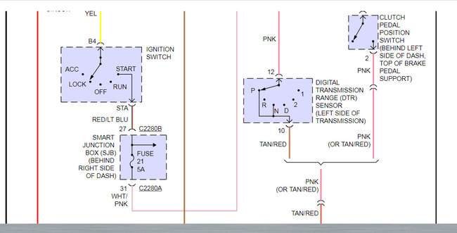

Good afternoon,
Do you have a test light to do some testing? I have attached a wiring diagram for you to view and we need to do some checks to see where the failure is located. This guide can help us fix it
Dec 21, 2019 at 2:48 AM
PATTY SAINT
clutch safety switch had a loose wire and fuses needed to be replaced. Thank you for your time. Merry Christmas.

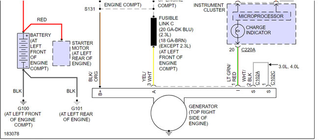

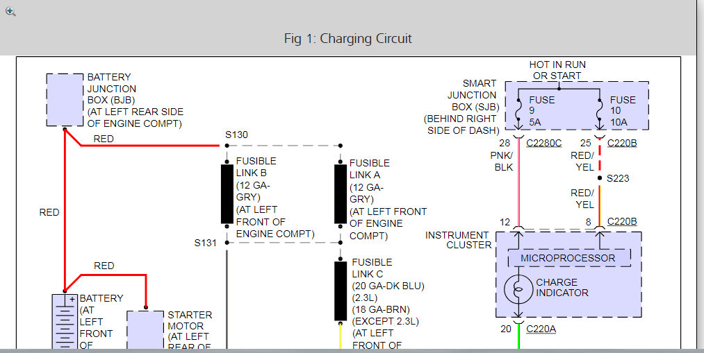

Hey I own a 2007 ford ranger 2.3 liter with a 5 speed manual, it started last October and I took it to a Ford Fact lab and they recommended a new battery. I put a new battery in it and it worked just fine for a few months but now it will not start. Whenever I am driving my tach, speedometer, and coolant gauge all quit working. My odometer will read ----- and wont tell me my miles. If I shut it off in this condition it will not start the security light just flashes, and the truck will not crank. Help please.
Mar 8, 2021 at 5:17 AM (Merged)
HMAC300
  • 48,601 POSTS
This sounds like the starter is having problems or the battery needs to be load tested these guides can help us fix it.

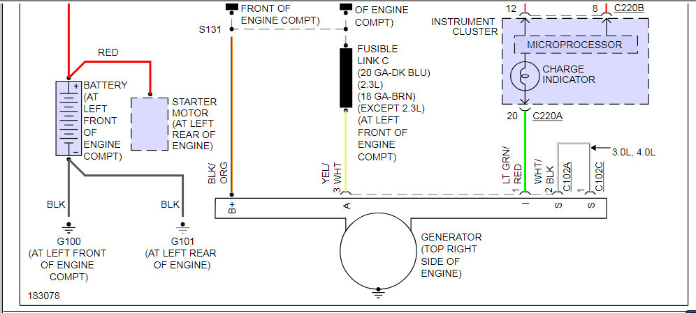

DARRON SKINNER

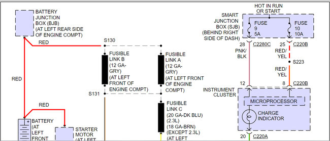

Moved truck to cut grass & when I went to move back it was dead. No lights or anything electric. The only noise is a clicking in the fuse panel under dash board, that is semi continual like a blinker. This noise starts & stops on its own regardless if the keys or you are in truck.
No fuses are blown & the (Pos Bat Terminal) goes to ground. I have the Bat leads disconnected & can find no place where a wire is shorted & bare against frame or ground?
The Bat is disconnected & reads over 10 volts & a Bat charger reads fully charged.
WRENCHTECH
  • 20,761 POSTS
it sounds like you may have a weak battery here are two guides to help us find the problem
and

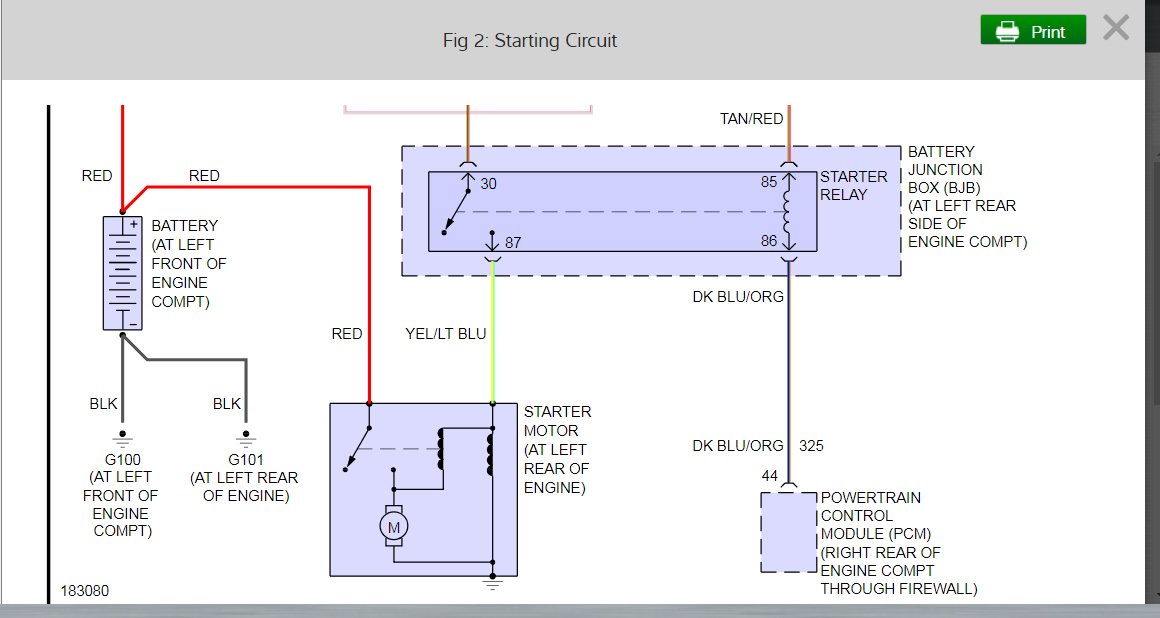

KAPTAIN
Clicks but does not start. Battery tests good. Whats wrong?
Mar 8, 2021 at 5:18 AM (Merged)
RENAUDTN
  • 636 POSTS
You could have a loose/corroded battery cable, or the battery may be weak. I know you said it tested good, but did you get it tested at an autopart store?
You could also have a bad starter, or maybe a bad solenoid. This sounds like the starter is having problems or the battery needs to be load tested these guides can help us fix it.
and
Please run down these guides and report back.Do you have voltage at the starter when attempting to crank the car? If so, what do you get? (if voltage too low, it won't even engage the starter).
If you don't have voltage at the starter, try to connect the starter directly to the battery. If the starter spin, you could have a bad solenoid.
If the starter doesn't do anything, it's probably bad and you need to replace it (take your starter to a store and have it tested to confirm).

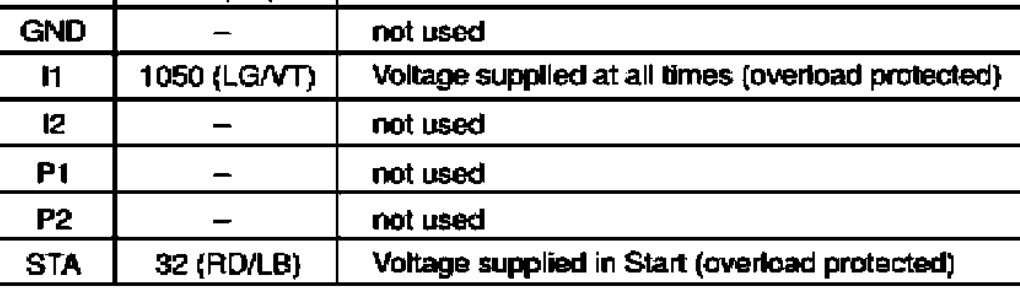

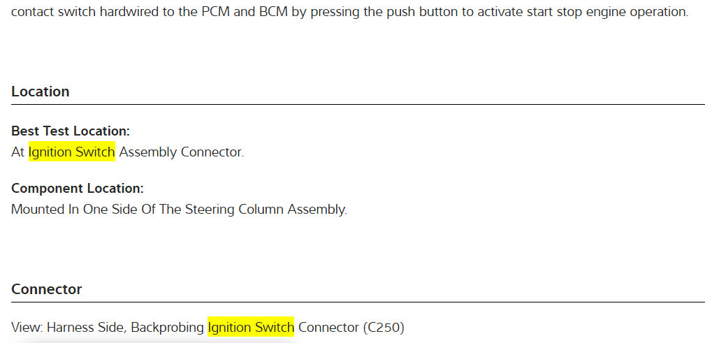

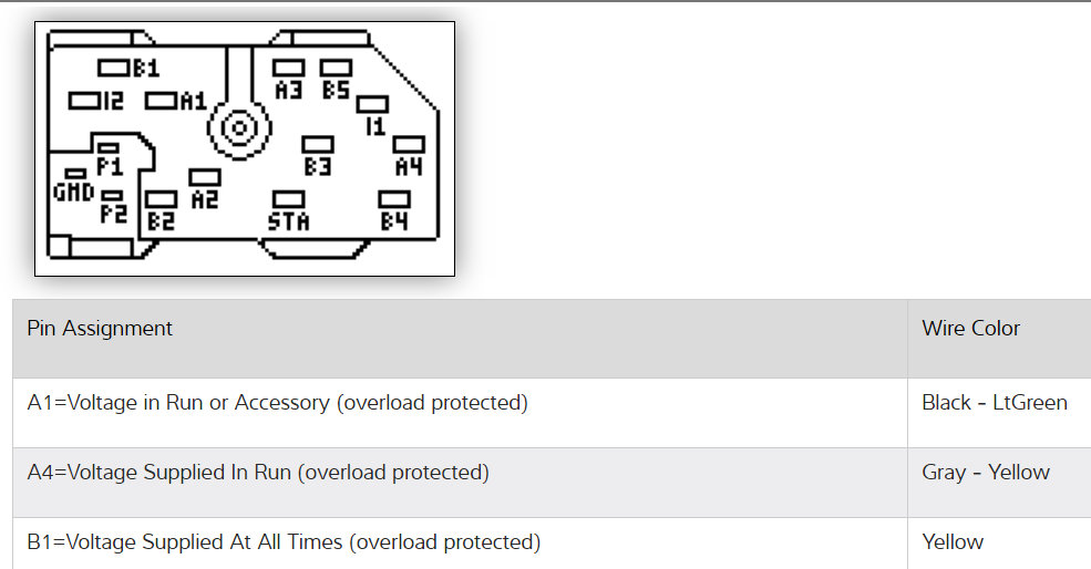

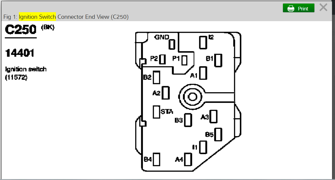

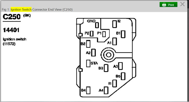

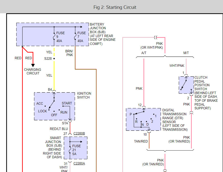

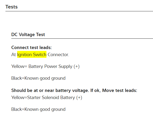

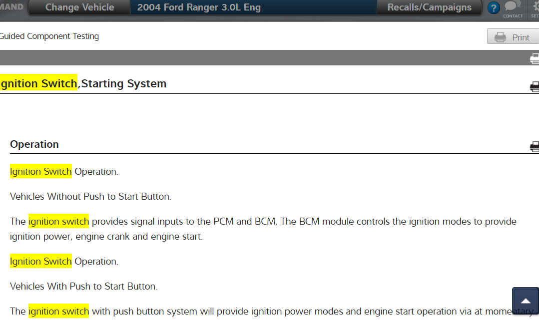

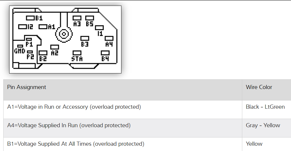

Truck was working fine before frame was replaced. Now when I turn the key the speedometer shows my speed as 120 mph, the truck stays in park. Fuel pump won't stop working. Nothing else works. Lights won't come on.
SCGRANTURISMO
  • 4,897 POSTS

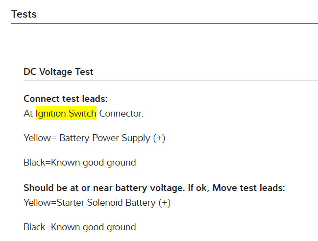

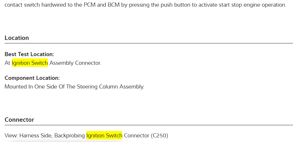

This sounds like you have a failing ignition switch with a short to power going on somewhere. It could also be in the wiring coming from the ignition switch as well. In the diagrams down below I have a factory troubleshooting guide for the ignition switch, wiring diagrams, and an exploded diagram of the ignition switch and associated wiring.
Please go through them and get back to us with what you find out.

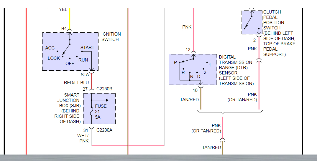

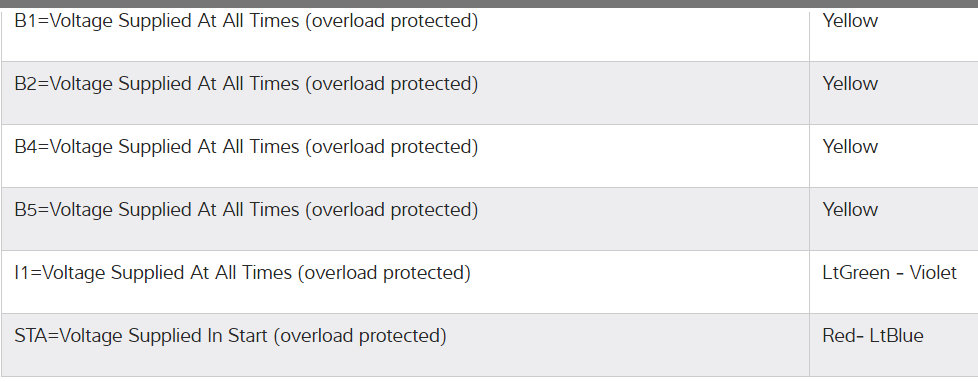

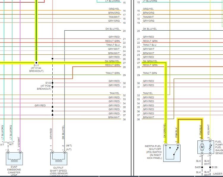

JJHRHIH
  • 15 POSTS

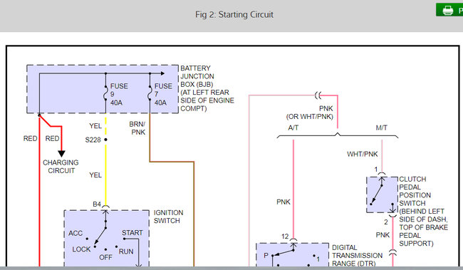

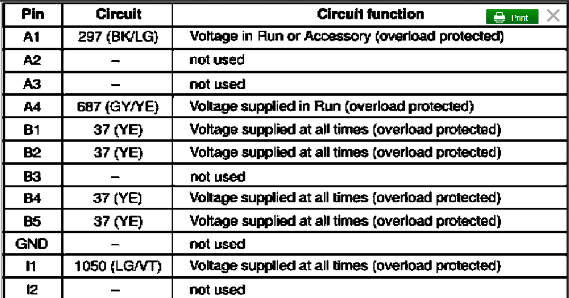

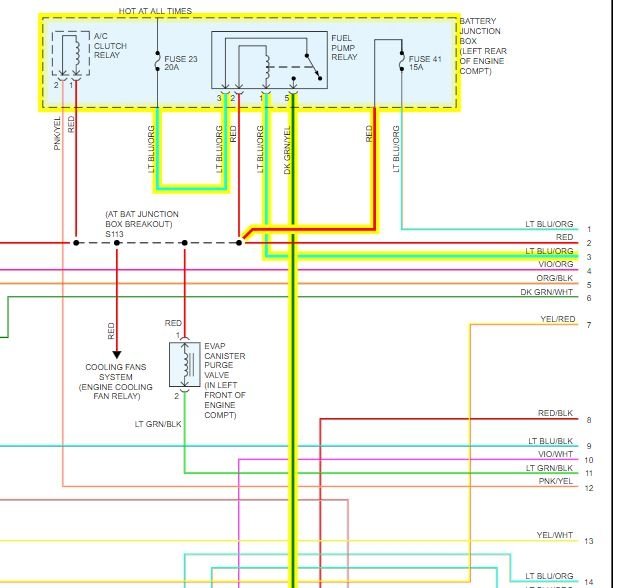

No start, Is 6.5 volts at switch key on correct?
Good evening,
No, you need battery voltage. You should have battery voltage for 2 seconds. Then it will disappear. When you crank the engine, it will go to a full battery voltage.
The power to the switch comes from the fuel pump relay. I attached a diagram of the system for you. I made it in 2 pieces so you will be able to view it.

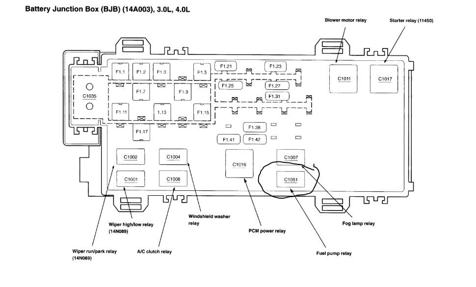

JJHRHIH
  • 15 POSTS
Thanks for quick reply. do you have diagram of relay location related to numbers on fuse cover,the black ones or smaller white?
I attached the location for you.
JJHRHIH
  • 15 POSTS
My fuse cover lid dose not match your diagram all relays show 45a 45b up to up to56a-b .2004 Ford Ranger . 3.0l
Just check the location position in the fuse block.
JJHRHIH
  • 15 POSTS
It does not match.
It is the only one listed. The diagram is upside down.

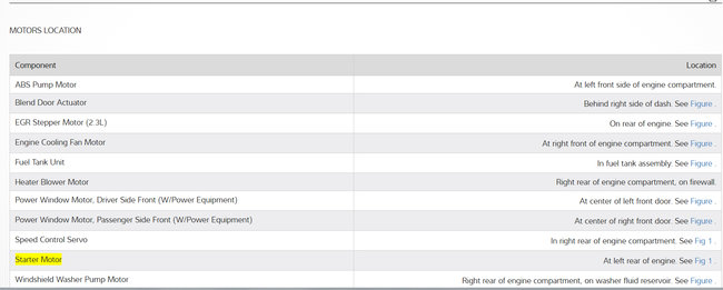

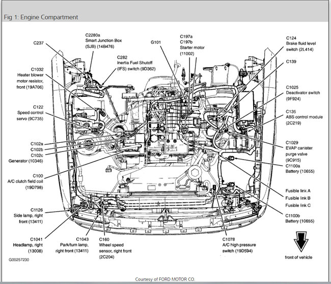

RALPH BORELLI
The starter will not engage the flywheel, unless truck is in gear clutch not pressed. If clutch is pressed or truck in neutral the starter spins but does not engage flywheel.
SCGRANTURISMO
  • 4,897 POSTS
This sounds like the Bendix gear in your starter might be going bad. The Bendix gear is the part of the starter that comes out to mesh with the flywheel and start turning the engine. I have included some links below.
https://www.2carpros.com/articles/how-a-starter-and-solenoid-works
Please go through the guides above and I have included more diagrams in the diagrams below.
