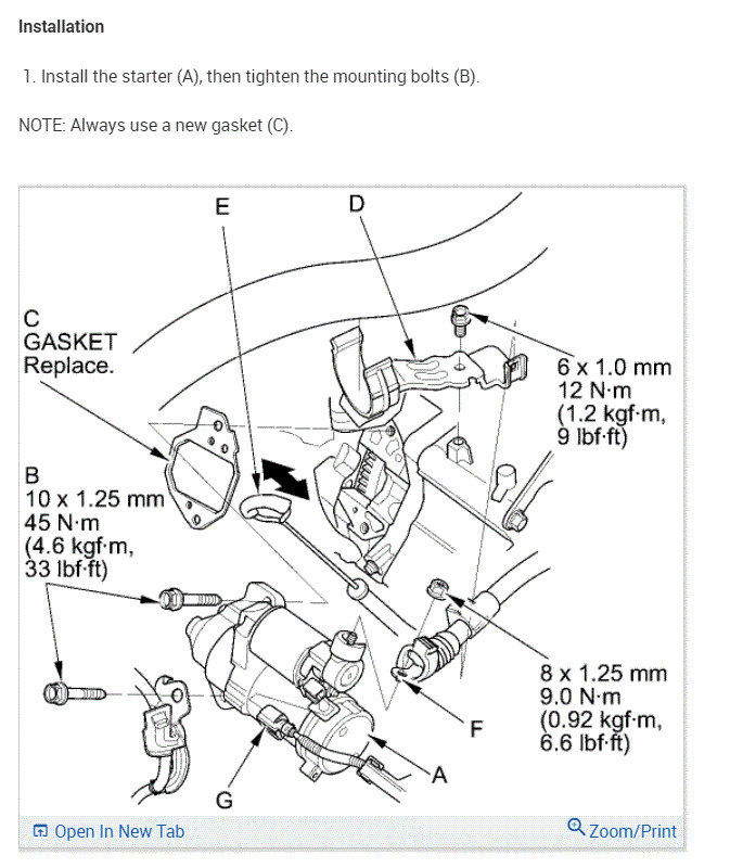

I was reviewing some of my posts and came back to this one. I forgot to add something. If you find lubricating the key doesn't help, I would replace the starter motor. As I mentioned above, it could be an issue with the Bendix hanging up a bit.
Here is a link you may find helpful. It explains how, in general, to replace a starter motor.
Also, I included the directions specific to this vehicle below.

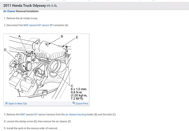

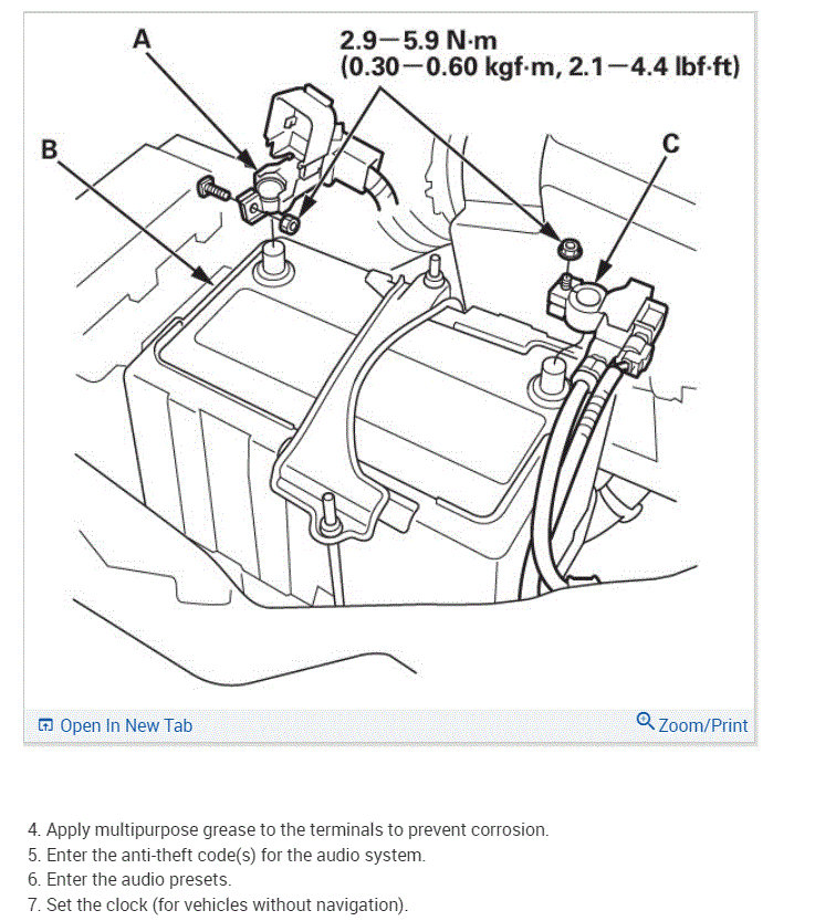

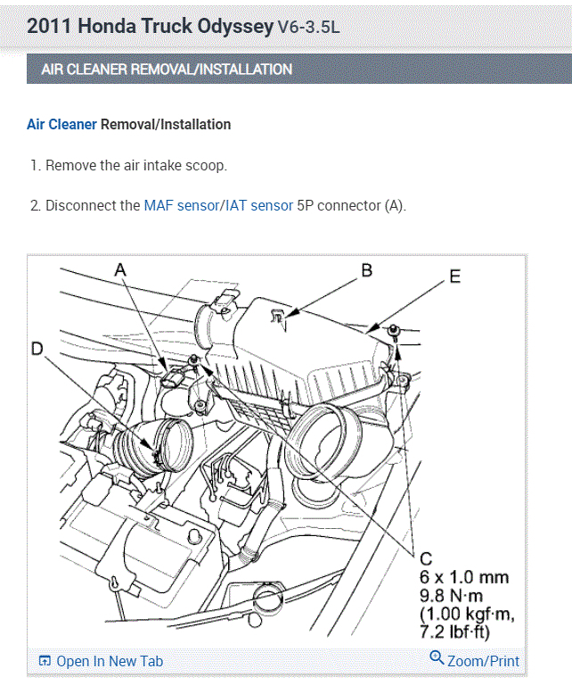

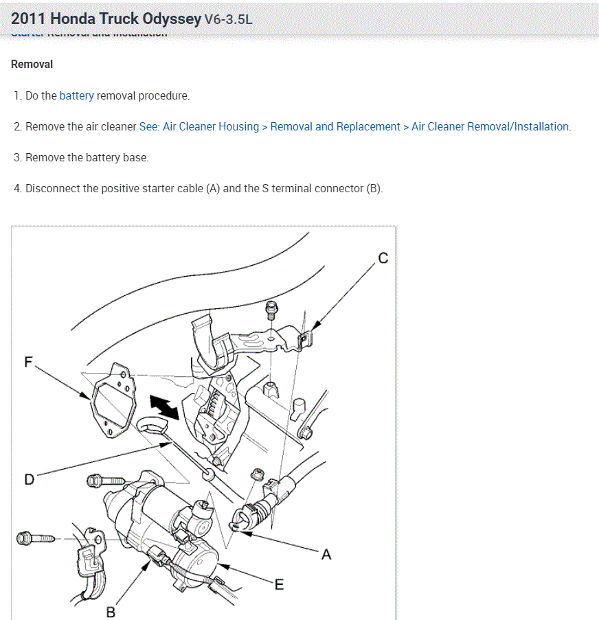

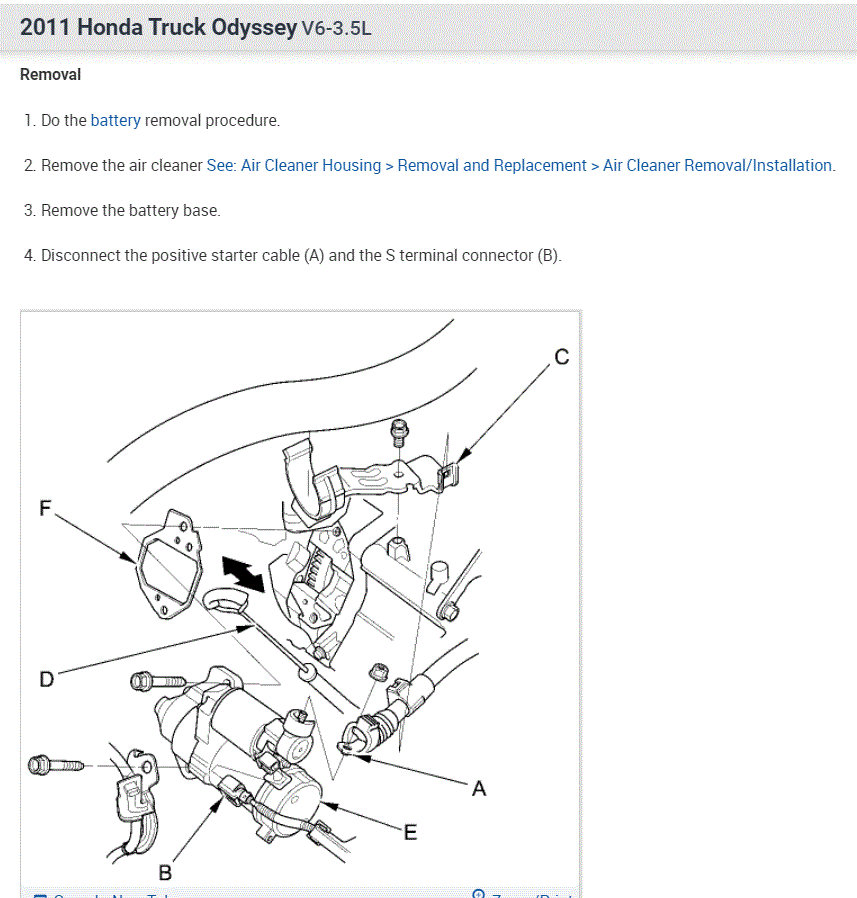

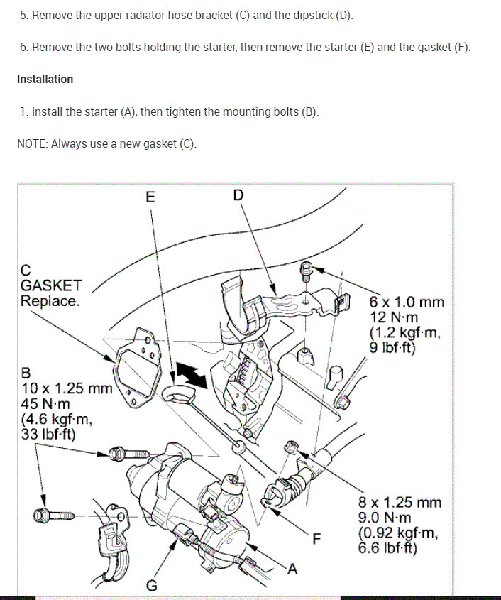

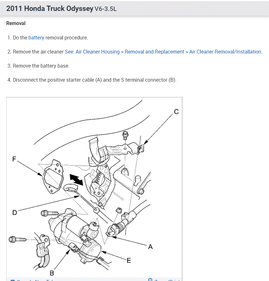

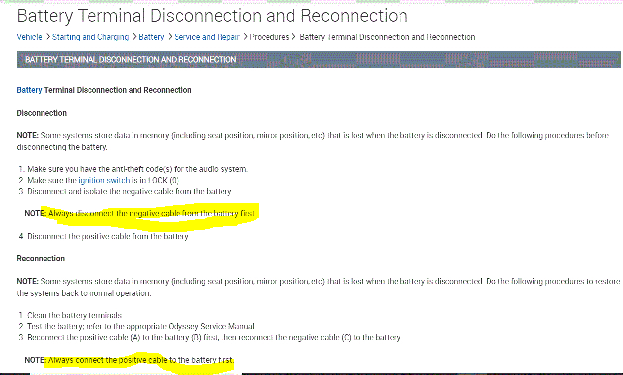

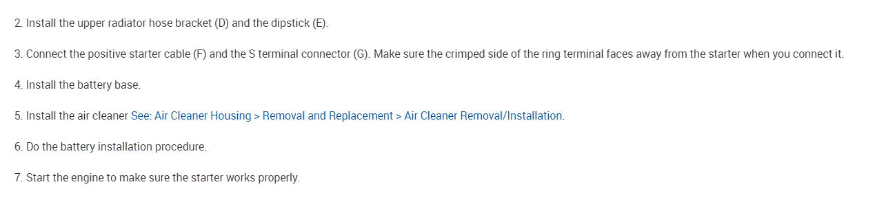

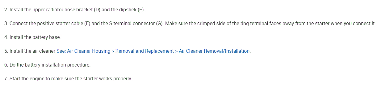

The flat rate (time given) to replace the starter is 1 hour. If they are charging that much, all I can say is wow!!! Also, the only thing needing to be removed to access it is the air filter box. Of course, the battery will need to be disconnected.
If you look below, I attached the directions specific to your vehicle for replacement. Also, I did a little research and found starters on Rockauto.com for under 100 dollars plus shipping. Additionally, if you do a google search for Rockauto discounts, you can get a coupon number that will get you 5% off.
I don't work for them. LOL, I just have had experience and saved a lot of money over the years. It's just a thought. Note: If you pick one with a core charge, you will need to pay that, but you get the money back when you return your old starter.
Here is a link you may find helpful. It explains in general how one is replaced.
The specifics are in the pics below. Also, I did include the battery disconnect procedure and the directions for removing the airbox.
