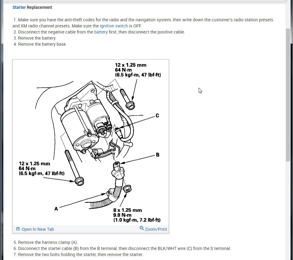

do you have a instructions on starter replacement?
Mar 13, 2010 at 9:22 AM

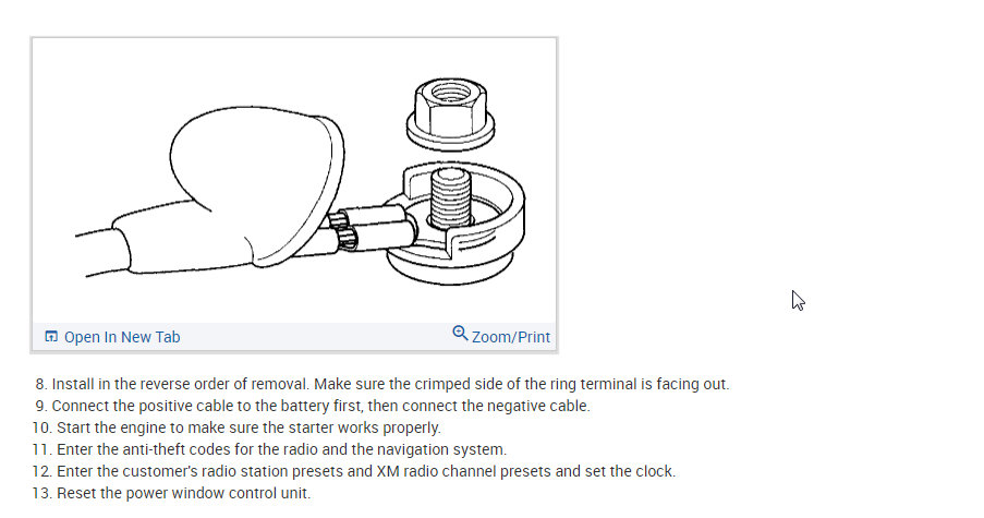

I am attaching the process for the starter replacement from the manual. Also, here are some useful guides that will help with more general information.
Let us know if you have other questions. Thanks
