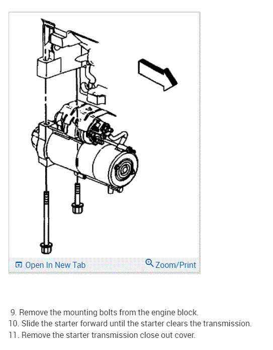

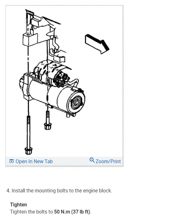

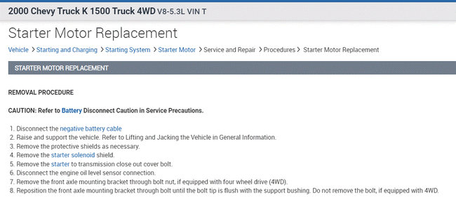

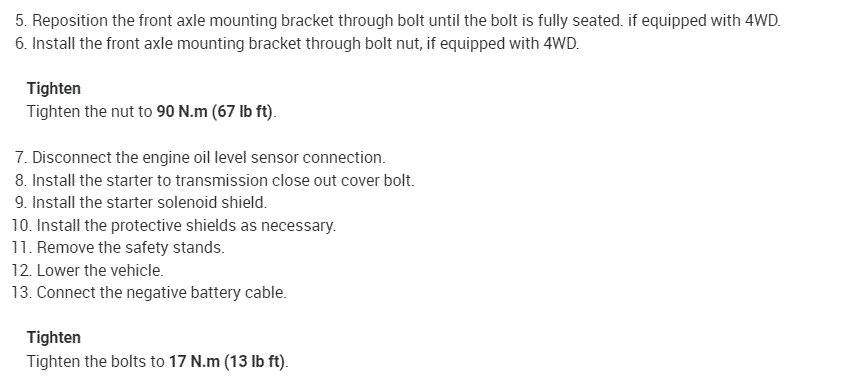

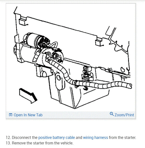

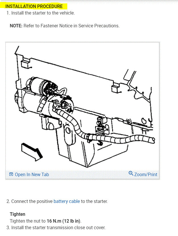

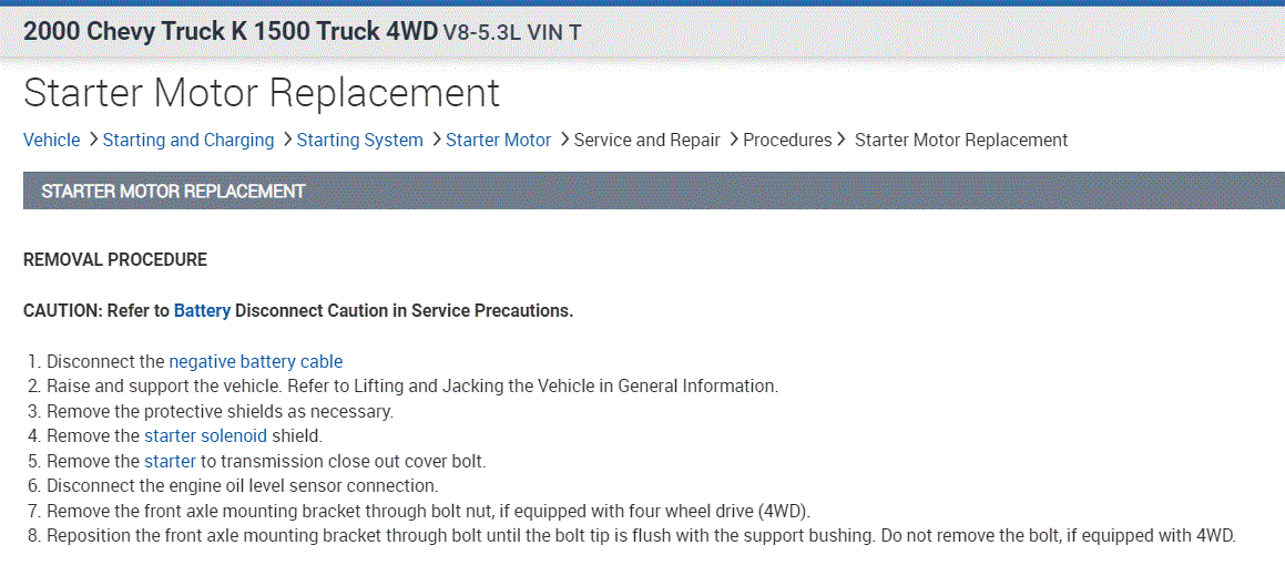

The Bendix on the starter is failing. When you engage the starter, an electromagnet inside the solenoid engages and pushes out the pinion gear in the starter and in turn makes contact with the flywheel and turns the engine.
If it is kicking in and out, the starter should be replaced. Here is a link you may find helpful:
If you look below, I provided the directions specific to this vehicle.
