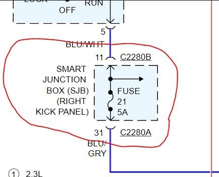

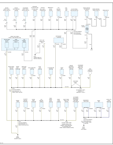

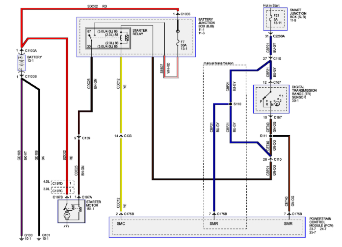

unable to start truck with the key no clicking noise no turn over. able to start with a push. put in new starter and that didnt do it. battery is good. before had some problems with the wiring.
Dec 21, 2019 at 4:21 AM
  • 110,244 POSTS

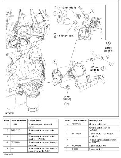

The first thing we need to do is check if power is where it needs to be. First, confirm there is 12v to the larger wire on the starter at all times.
Next, have a helper turn the key to the start position and see if there is power to the smaller wire on the starter (s terminal). The smaller wire should only get 12v when the key is in the start position. Here is a link to help:

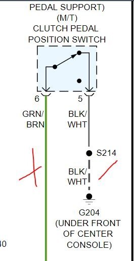

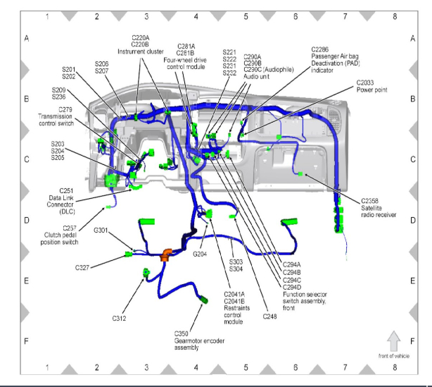

Next, there is a switch on the clutch pedal that prevents the vehicle from starting if the clutch isn't depressed. Have you checked that? Take a look at pic 1 below. It shows the wiring to the clutch switch. The green /. brown wire should receive power when you turn the key to the start position. Power should then come out from the black / white wire to ground.

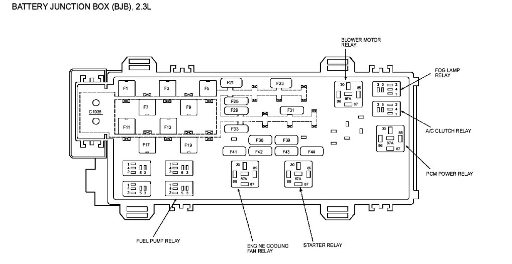

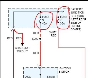

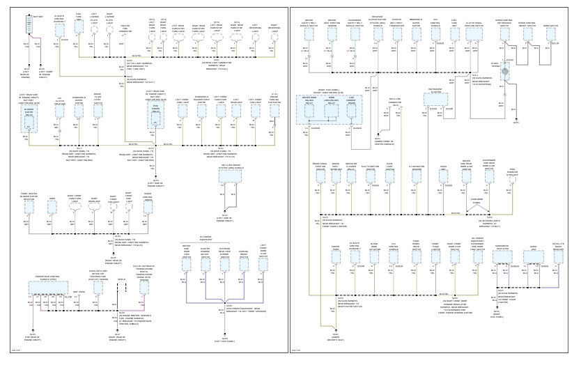

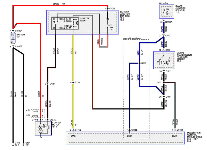

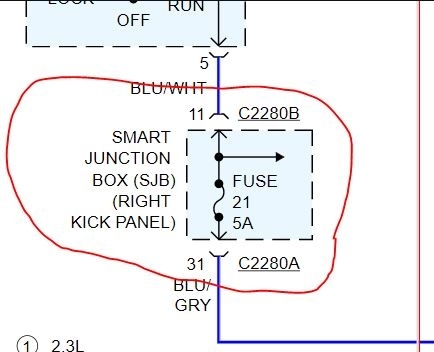

Next, check and confirm fuse 21 is good. See pic 2 Additionally, check the two fuses in pic 4.

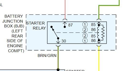

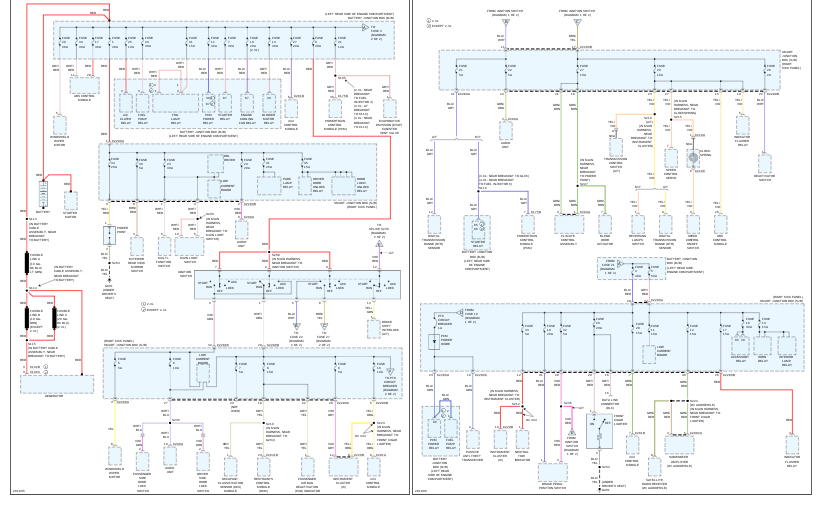

Last, check the starter relay. See pic 3 for location. If there is another relay with the same part number, switch them to see if anything changes. If there isn't, I will include directions for testing in the following links.

If your head lamps stay bright you have an ignition starter circuit problem. Check your clutch safety switch it is mounted on the clutch pedal. It is a ground circuit and is open when the clutch pedal is in the up position and closed when in down position. ( Use extreme caution vehicle can start in gear if you jump the circuit for testing.) Replace switch if faulty.

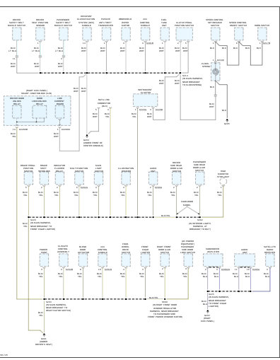

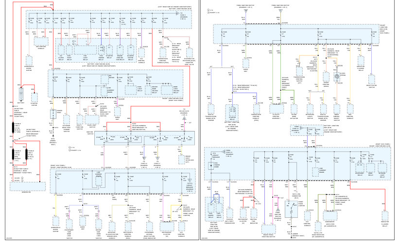

If clutch safety switch is good, Check your fuses and starter relay, I'm attaching schematics and wiring diagrams below and you can reference as needed. If you need anymore information please let use know and we will get it to you.

truck needed some fuses and there was a loose wire on the safety switch. Nice fixed just in time for Christmas. Thank you
