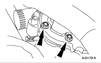

DAVID0409
How do i remove my starter on my ranger. i cant seem to find the bolt locations
Nov 11, 2019 at 10:07 AM (Merged)
  • 75,992 POSTS
https://images.2carpros.com/forum/automotive_pictures/12900_starter_1.gif
