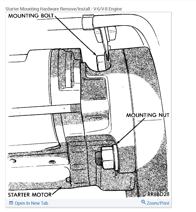

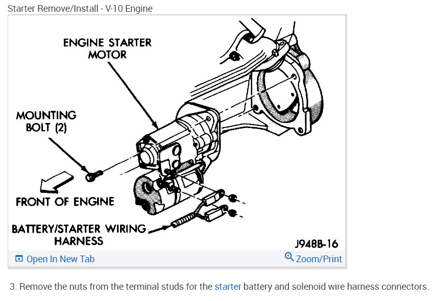

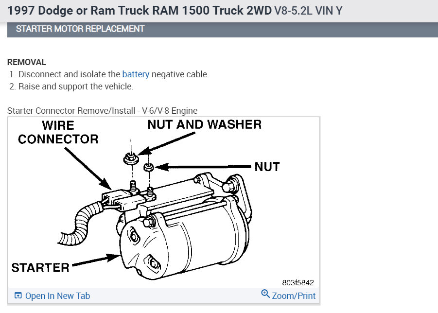

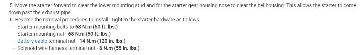

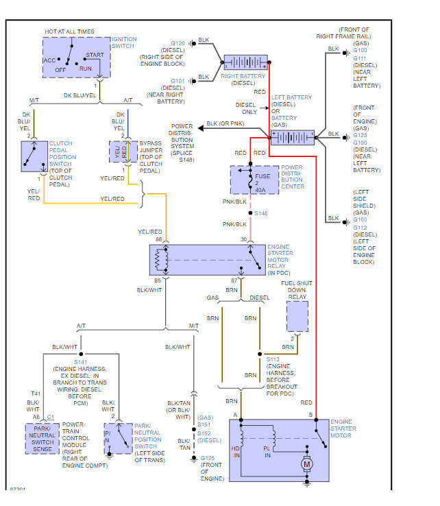

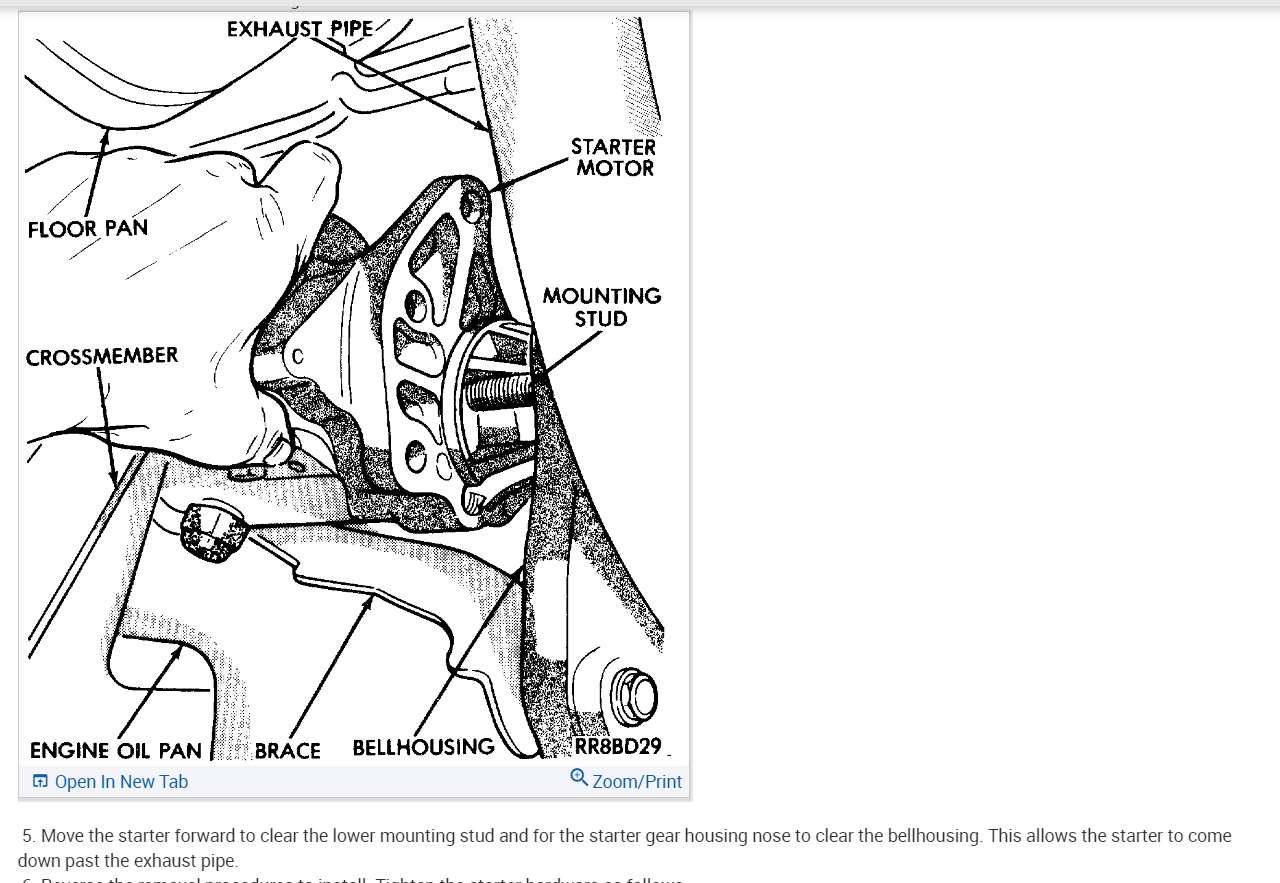

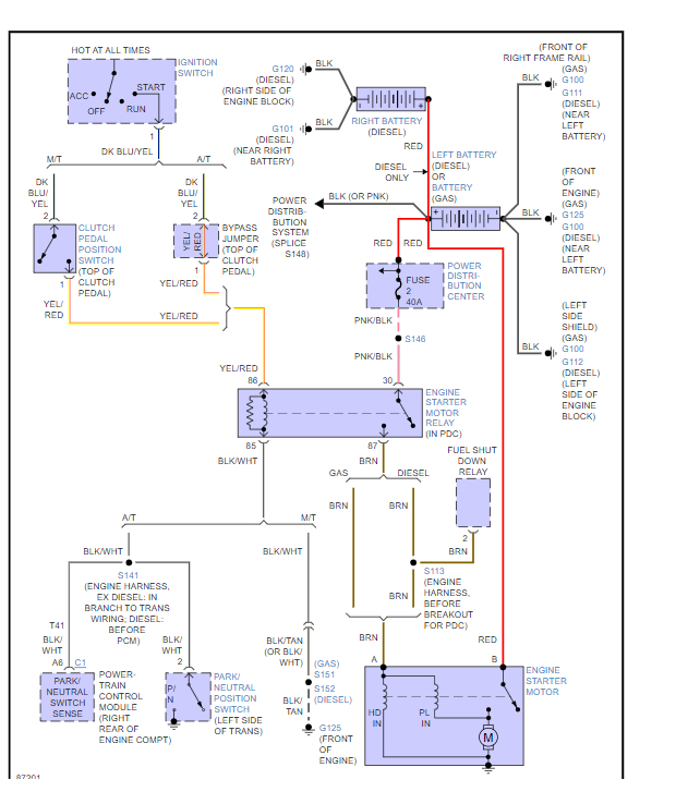

Wiring diagram to replace starter needed.
Aug 23, 2022 at 12:59 AM
  • 55,267 POSTS
Here is how you can change out the starter and the starter wring diagram to help you understand the system and how to connect the wires in the images below. Also, this generic guide can help you understand what you are getting yourself into when doing the job:
