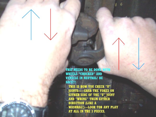

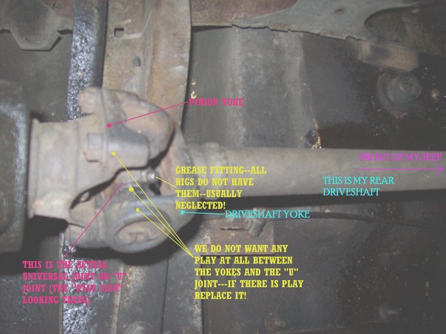

CJ MEDEVAC
  • 11,004 POSTS
Different and better looking person.
While you are under there,
Might check them Universal Joints too!
Level ground/ chock the wheels/ out of gear.
The Medic

PRINCESS77ASH
  • 6 POSTS
Did not get to make it to the garage today, but he is taking it down tomorrow for sure. And thanks i will definitely tell him to check on that. Hopefully its something simple.
