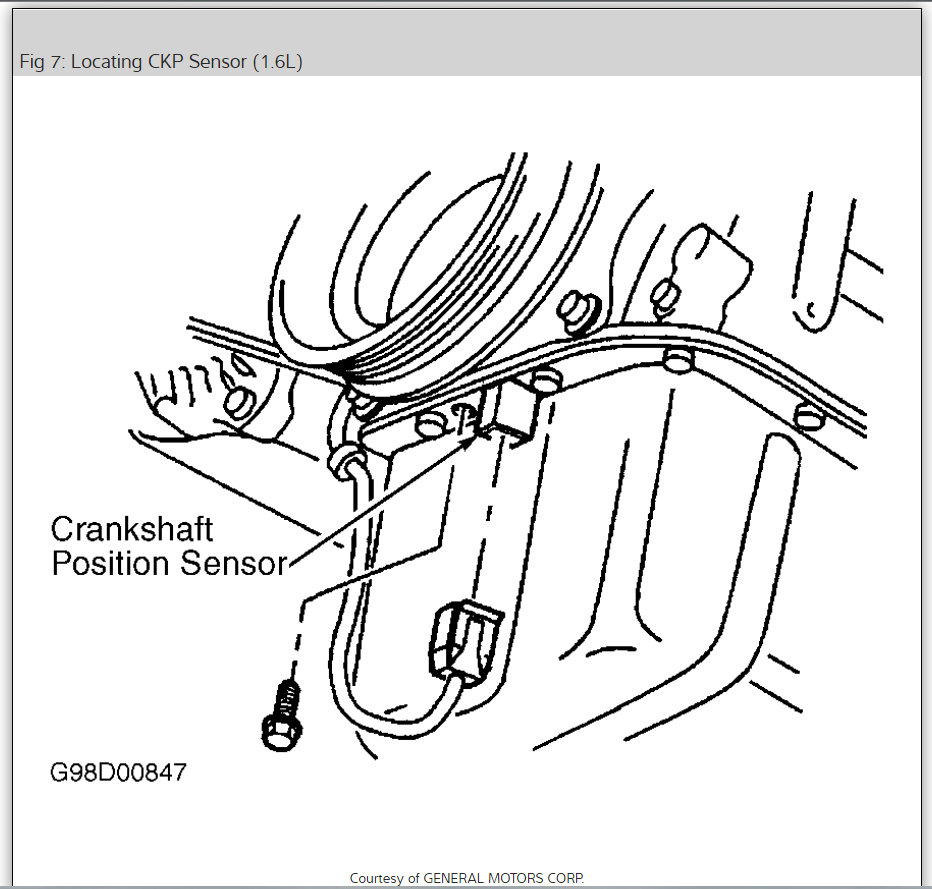

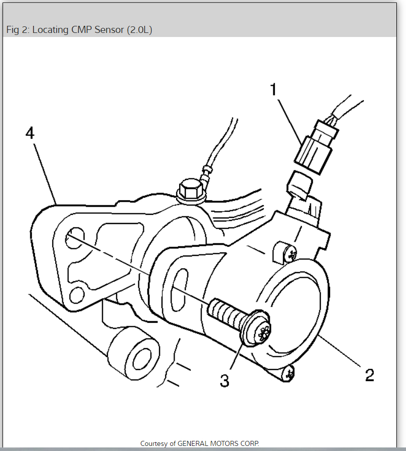

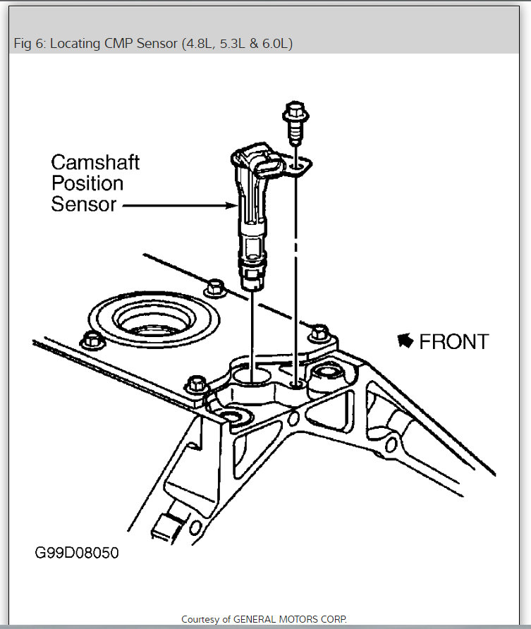

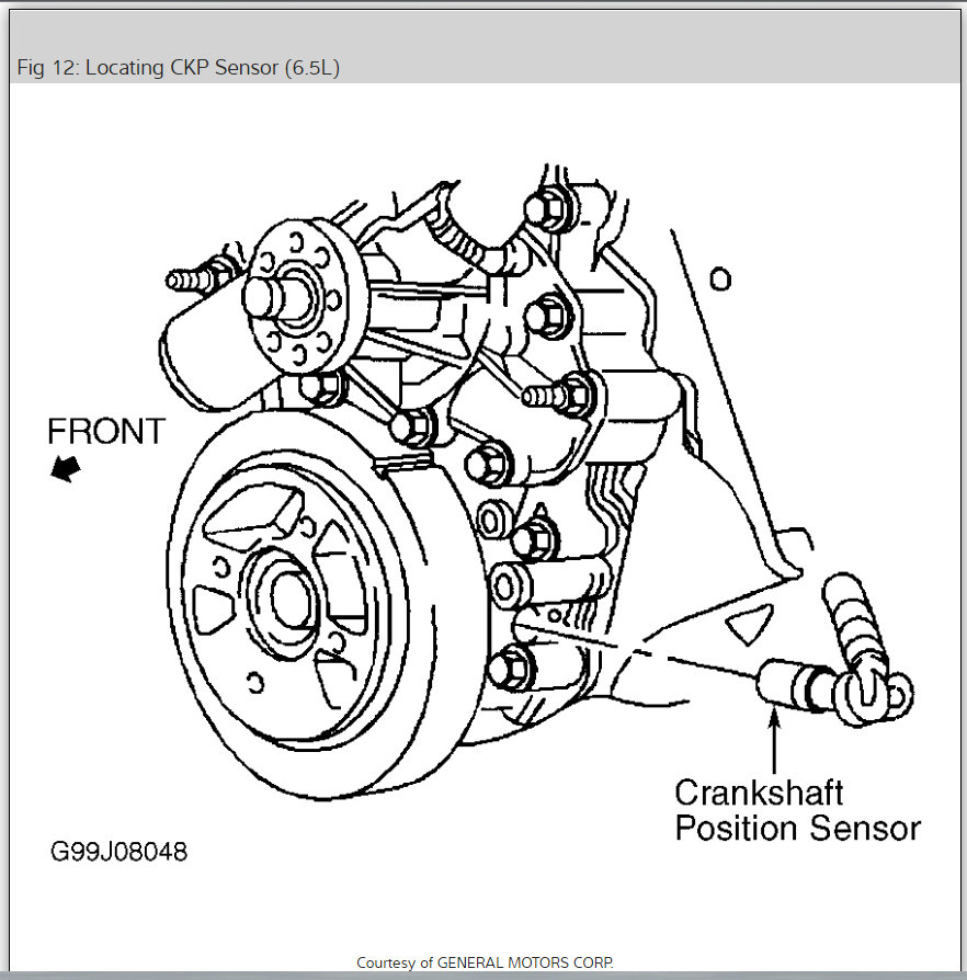

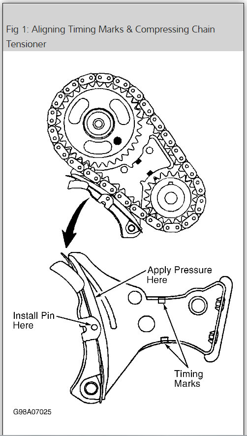

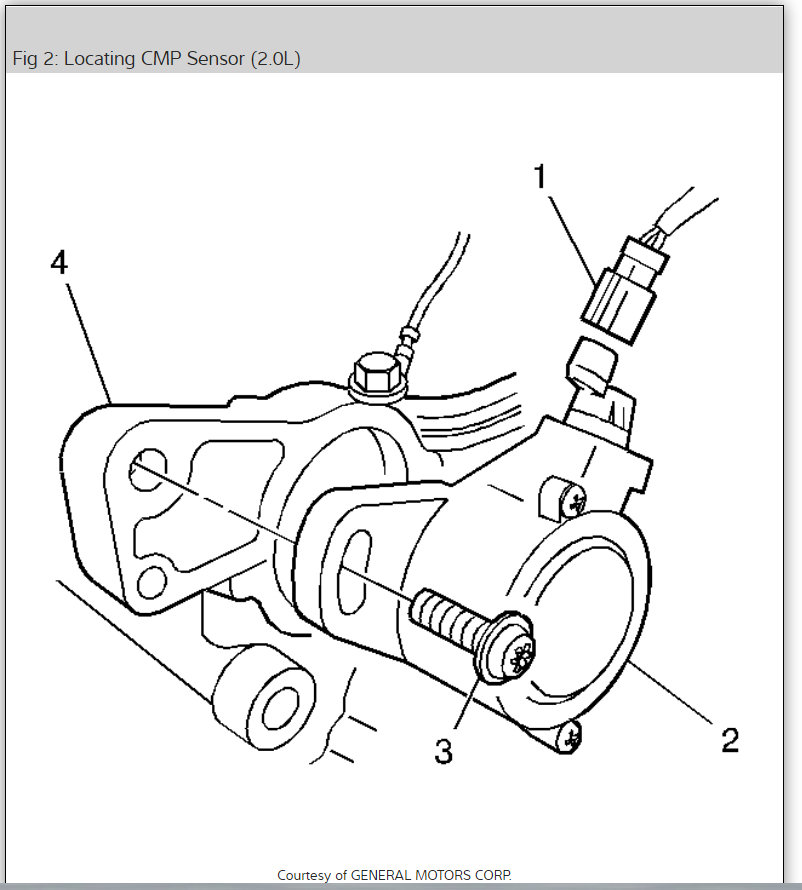

My truck was sluggish to start but it ran. i was told my timing is off just a little. so i followed step by step three times on how to set the timing on my vehicle 4.3L. and now i have gone it made it worse. it wont start. i am out at midnight in the cold trying to get it to start. i have got to go to work at six am. Please please help!
Feb 28, 2019 at 1:57 PM
SCGRANTURISMO
  • 4,897 POSTS

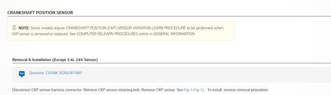

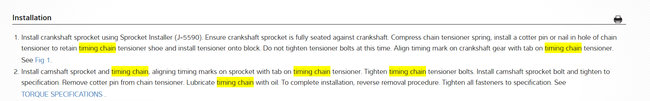

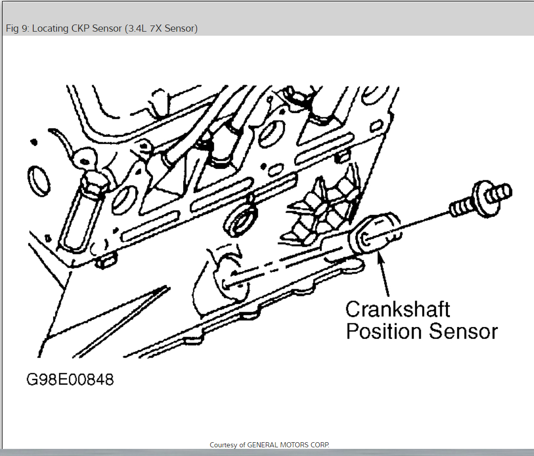

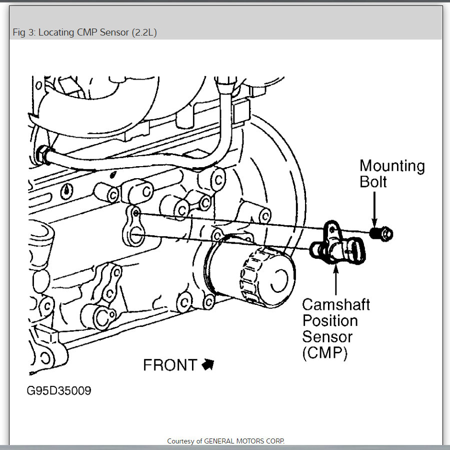

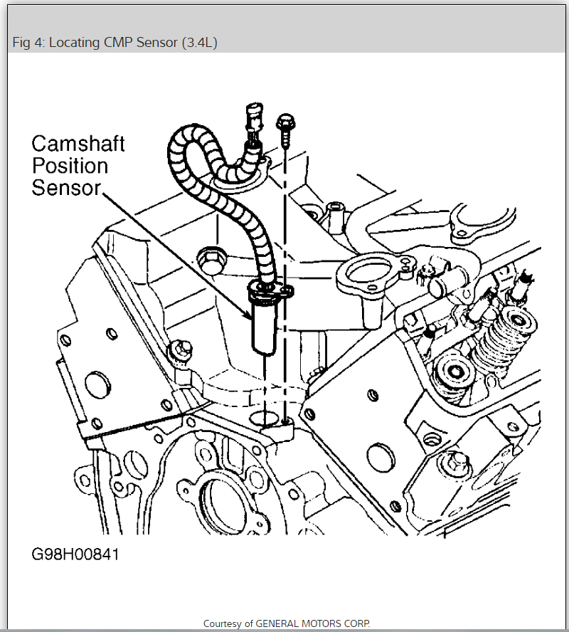

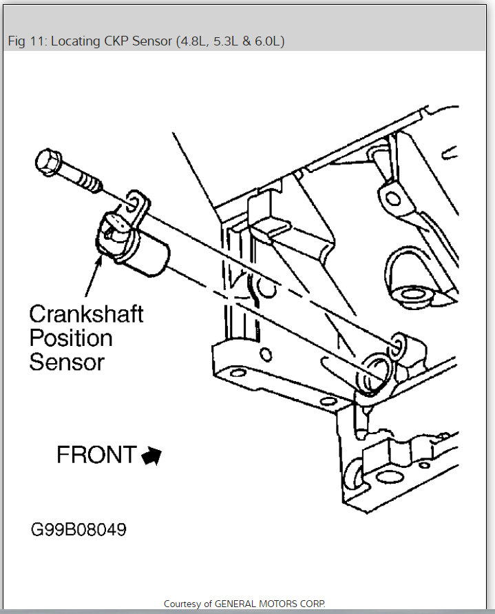

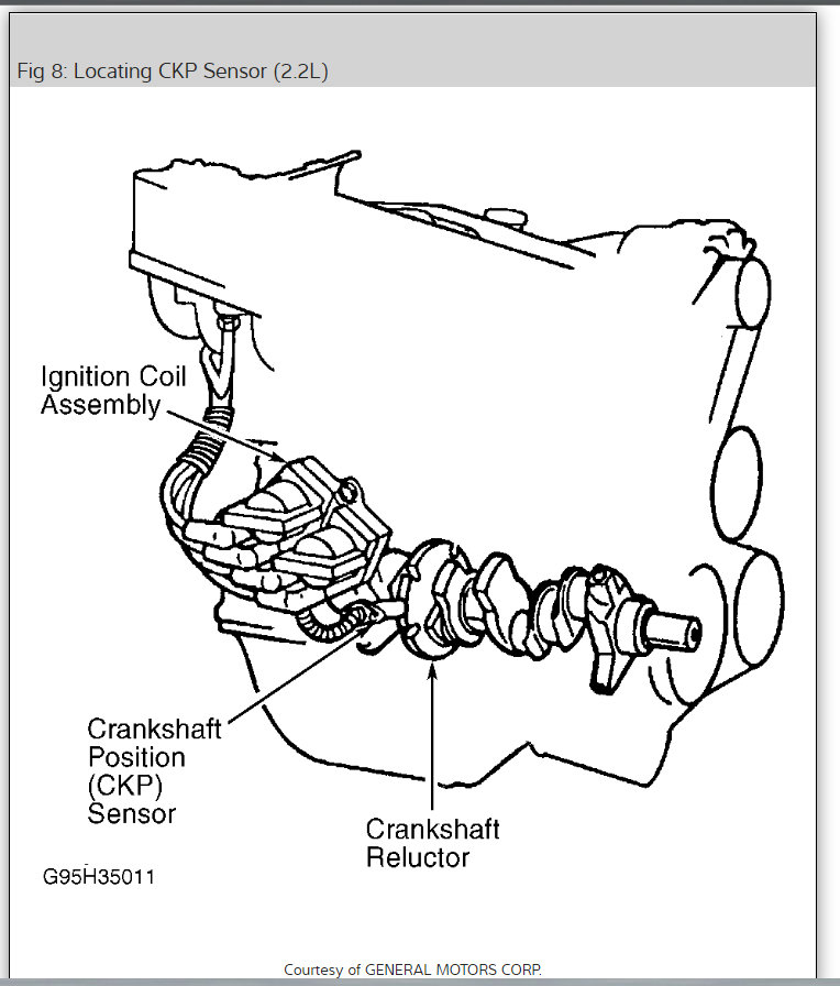

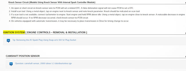

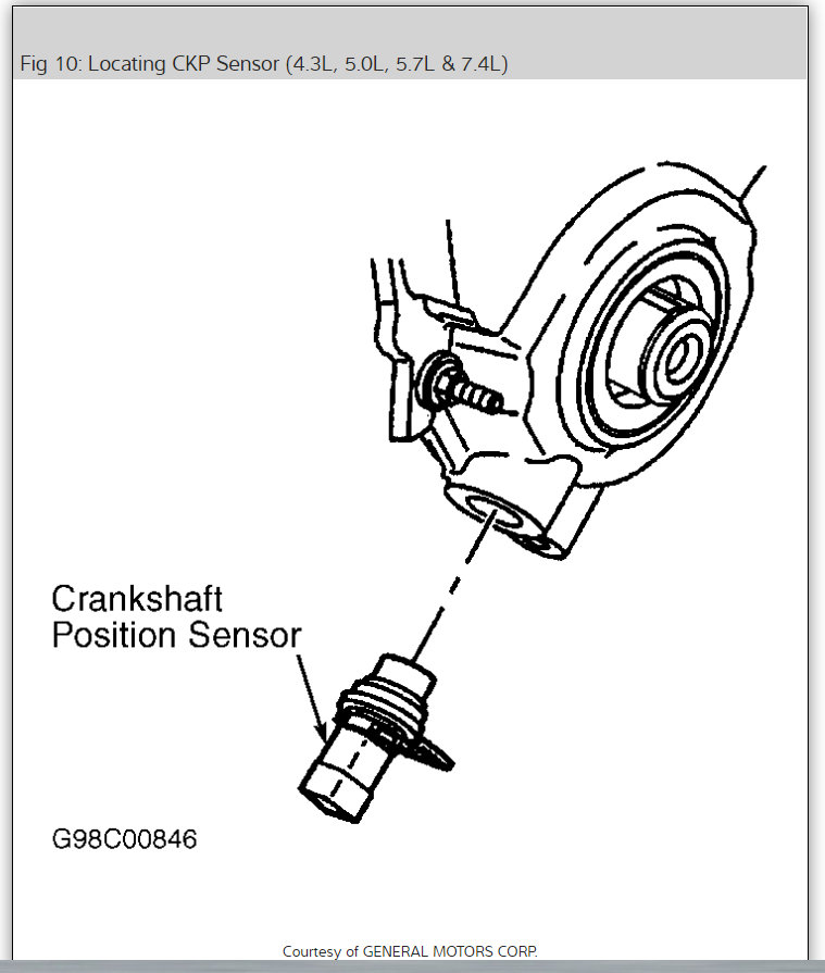

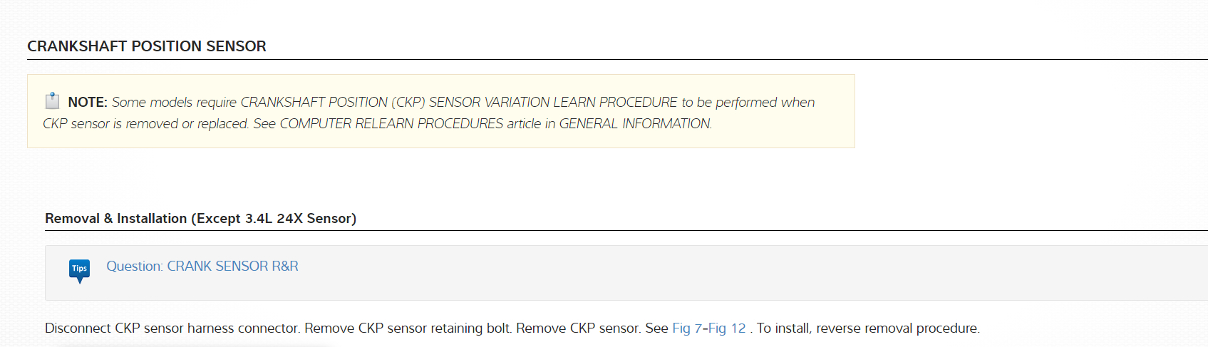

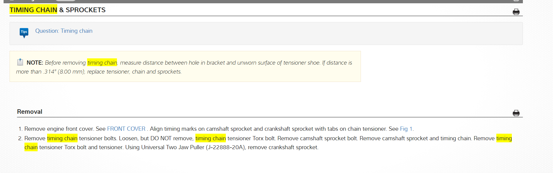

I hope you were talking about your timing chain, because your ignition timing is non adjustable. Anyway, I have included directions for setting the timing on your timing chain in the diagrams down below. Please get back to us with any other questions you may have, or if we can help in any other way, and let us know what happens, please.

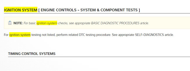

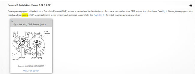

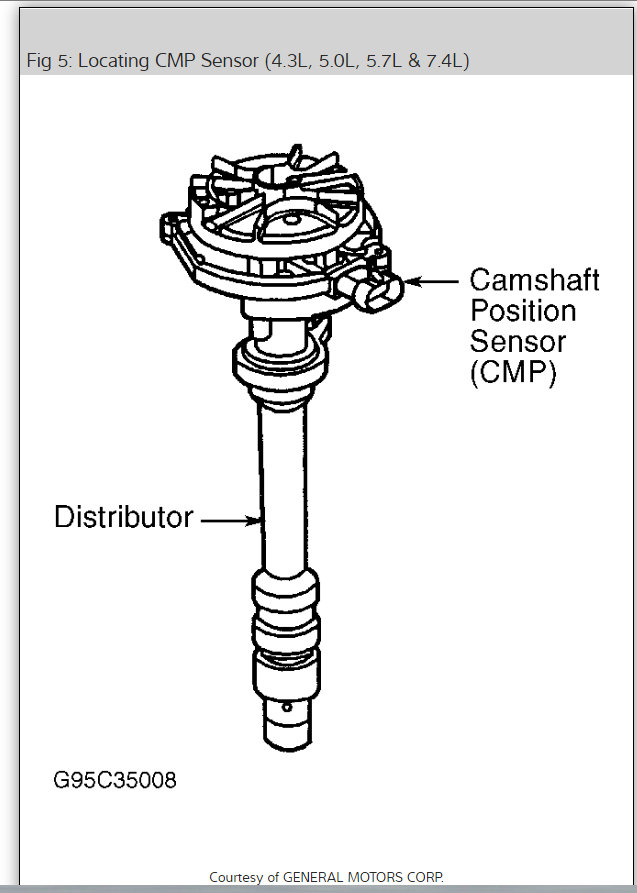

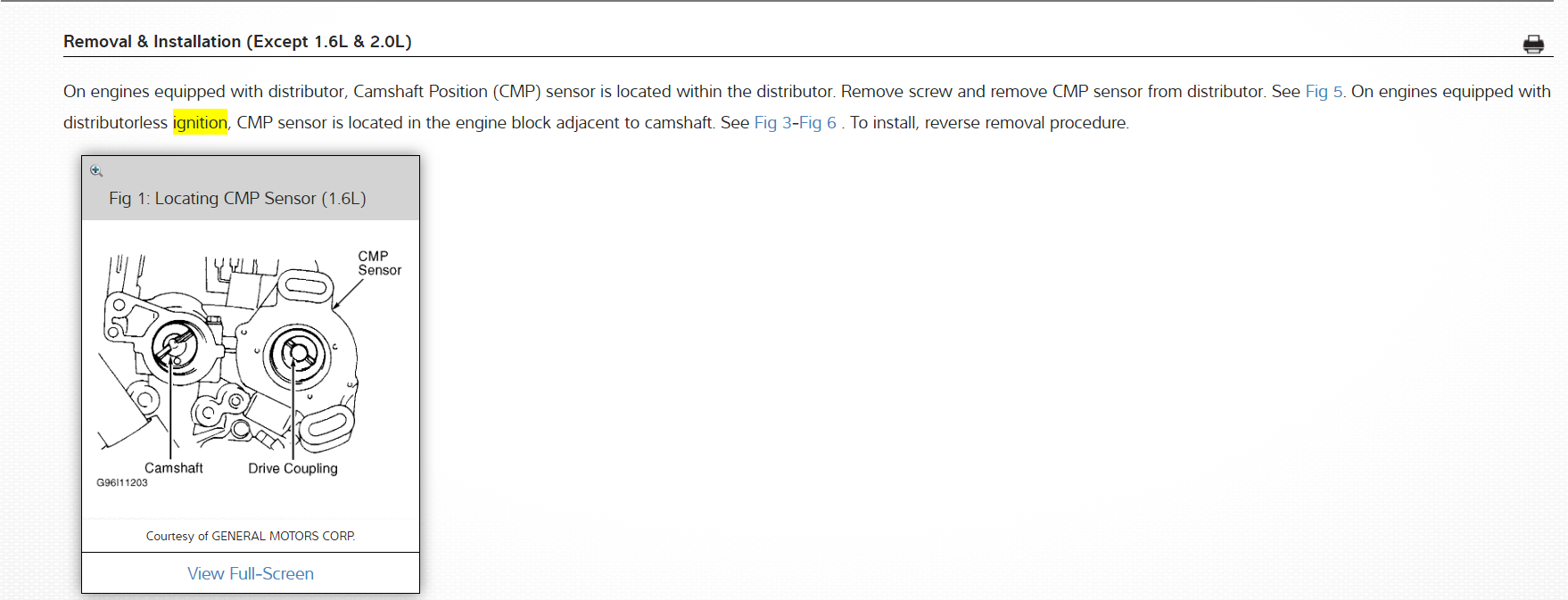

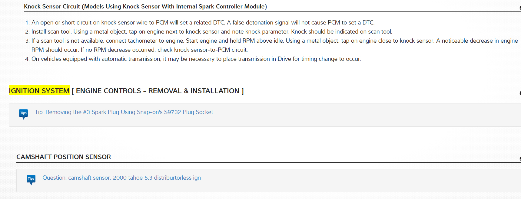

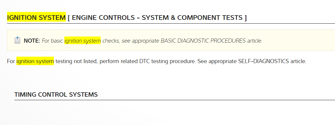

I am talking about the ignition timing. after spending hours at pulling the distributor and finding TDC over and over again and again. it acts like it is gonna fire up but doesn't. about that time the battery sounds like it is drained but it is not. what stops this thing from firing up? got spark, gets gas. Help
Feb 28, 2019 at 6:53 PM
SCGRANTURISMO
  • 4,897 POSTS
Hello again,
In the diagrams below I have included the instructions for ignition timing on your vehicle. Please let us know if there is anything else we can do to help.
