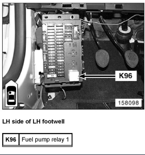

Not starting unless I use ether
2005 MINI COOPER
93,000 MILES • 1.6L • 4 CYL • 2WD • AUTOMATIC
MINIMARCOS
Car listed above is not supercharge.
Have replaced fuel pump and filter. thermostat housing and coolant temperature sensor along with cam shaft sensor.
Have spark
Turns over but would start in not using starting fluid down intake snorkel.
Cold compression
90
85
90
90
no oil added for test.
took apart throttle body no much carbon and clean it with throttle body cleaner along with MAF.
Originally had over heating issue but think have that licked.
Did see there was an ambient air sensor but use bore scope for plastic intake nothing cracked.
will check for codes tomorrow.

You might want to check the fuel pump relay to see if its good and powering the fuel pump. Here is a tutorial showing how to test relays:
You mentioned you will be checking for codes. Here is a tutorial showing how to retrieve diagnostic codes:
Get back to us with what you find and we'll go from there. I've attached a picture below showing the fuel pump relays location. Hope this helps and thanks for using 2CarPros.

Thank you for this and will give it a go. One thing to mention it's a 2005 not 2001. It will run fine one started. I will test fuel pump relay. I do hear the fuel pump priming up one you turn the key to start.
