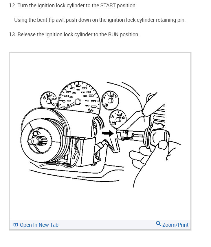

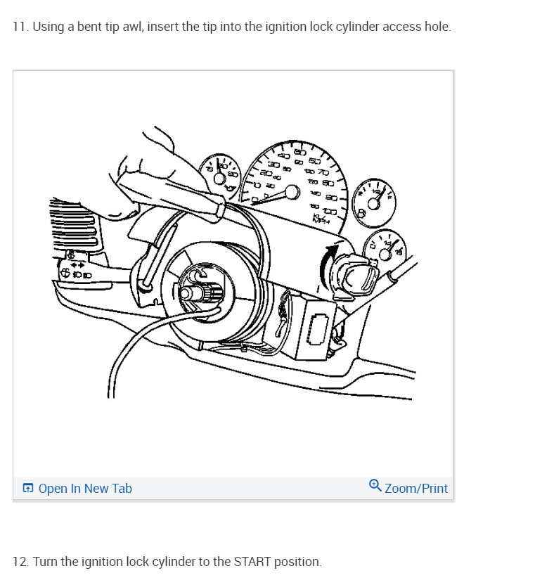

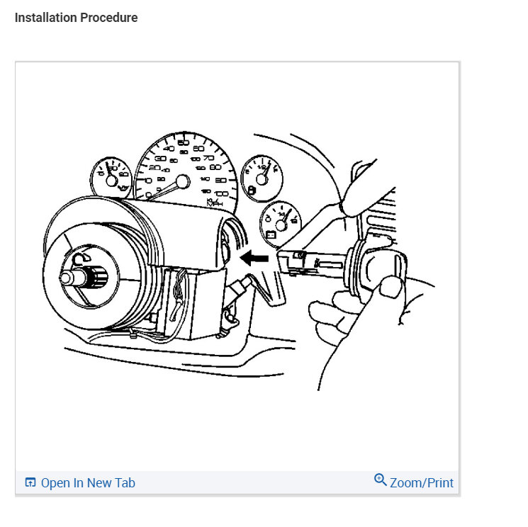

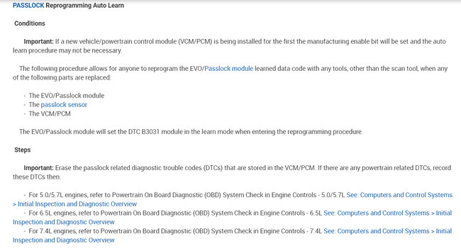

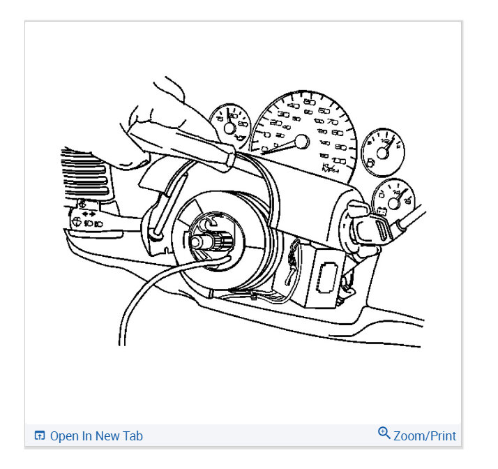

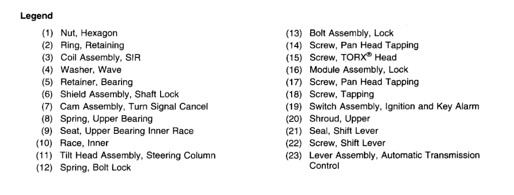

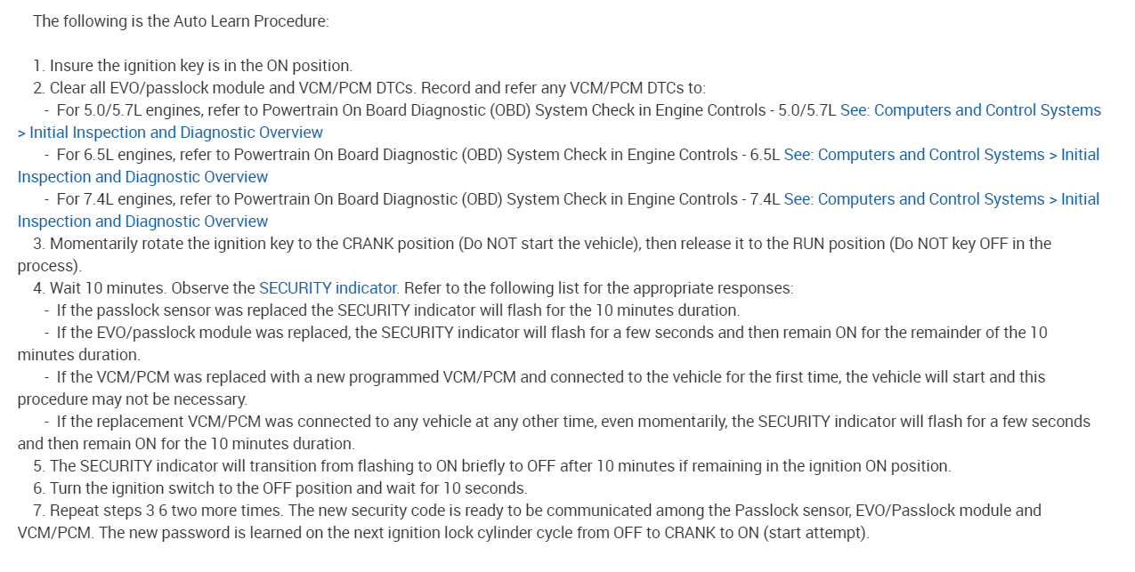

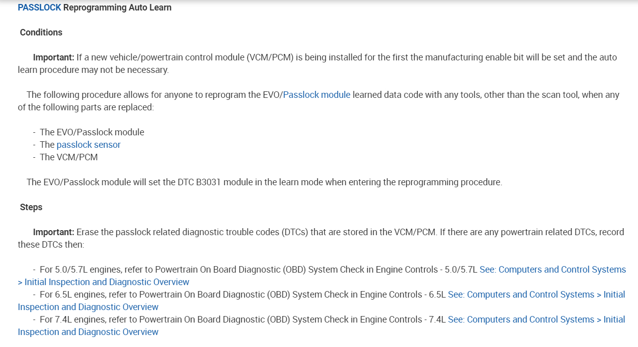

When you try to start it does the security light flash? If so, this is why it is not running. We should run the codes as well. this guide can help:

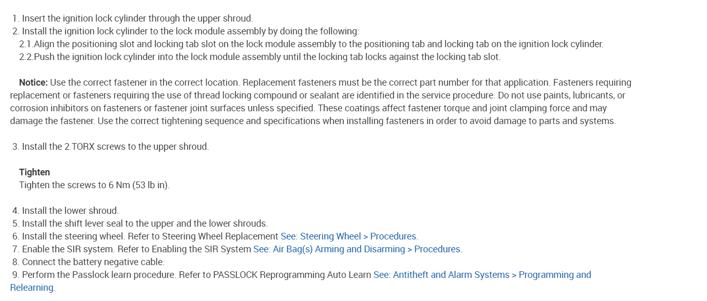

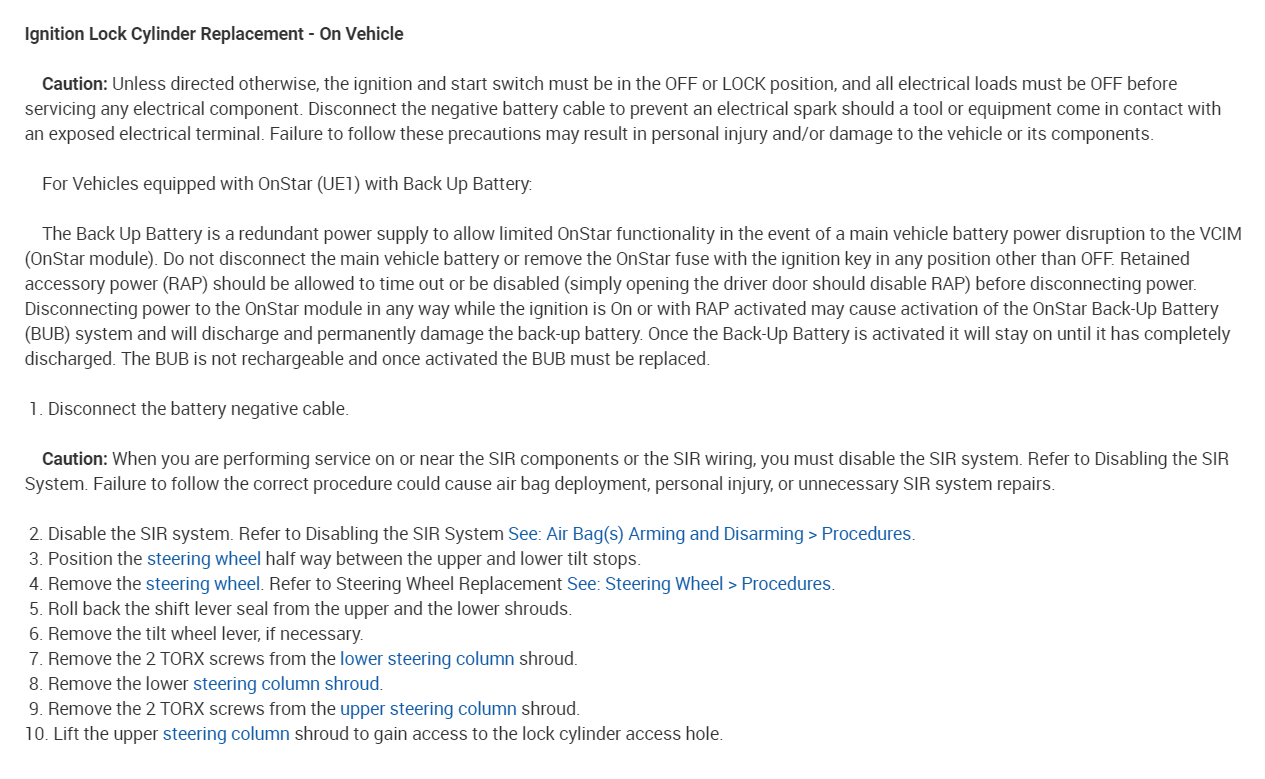

Here are the instructions for installing the new ignition key and pass lock which need to be coded to the car for the security system to work.

Is it flashing when you try to start the truck? If so, the security system is engaged. You can try this guide:
https://www.2carpros.com/articles/how-to-reset-a-security-system
If that doesn't work you can try a hard reboot which is done by removing the negative side of the battery, with the cable loose from the negative side of the battery, hold it to the positive terminal for 1 minute this will discharge the memory capacitors in the BCM and PCM allowing the system to reboot.
