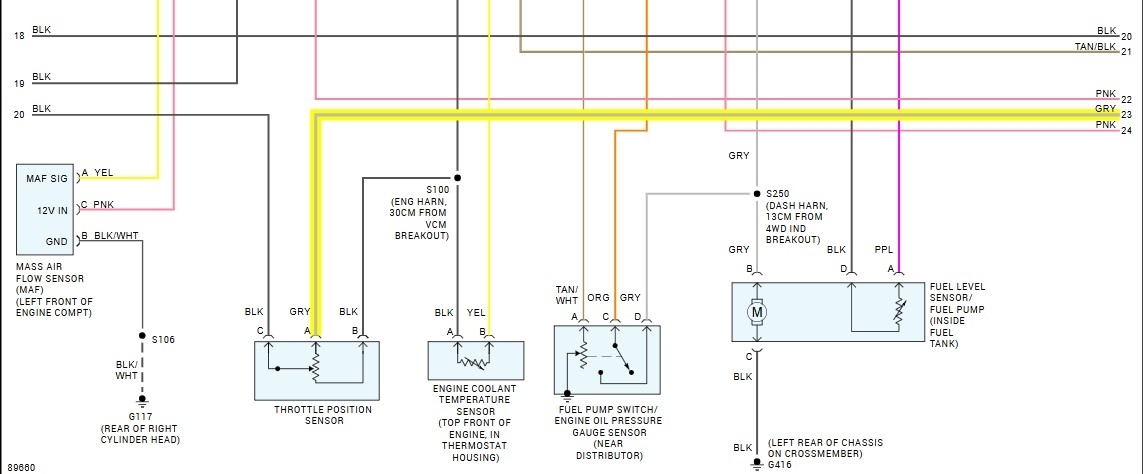

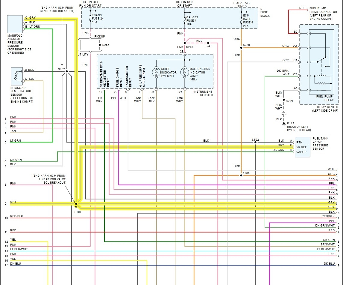

Just looking through the wiring diagrams real quick, this engine has some sensors that use a 5-volt Reference, such as the MAP, Fuel tank pressure sensor, EGR position sensor, etc. If one of these sensors is shorting out internally, it will pull that 5volt reference to Ground, and this same type of fault will occur. You would have to be prepared and catch a fault like this by checking a 3-wire sensor for the 5volt feed, if its missing, you can start unplugging sensors until it comes back, and you know your fault area.
I'll post the wiring diagrams showing that 5v Ref for you, just so you can check it, if need be, its best to have a back probing pin so you can check a sensor when it's still plugged in.

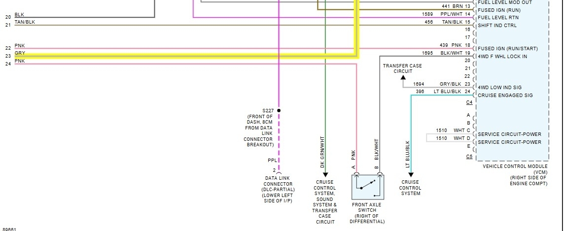

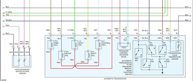

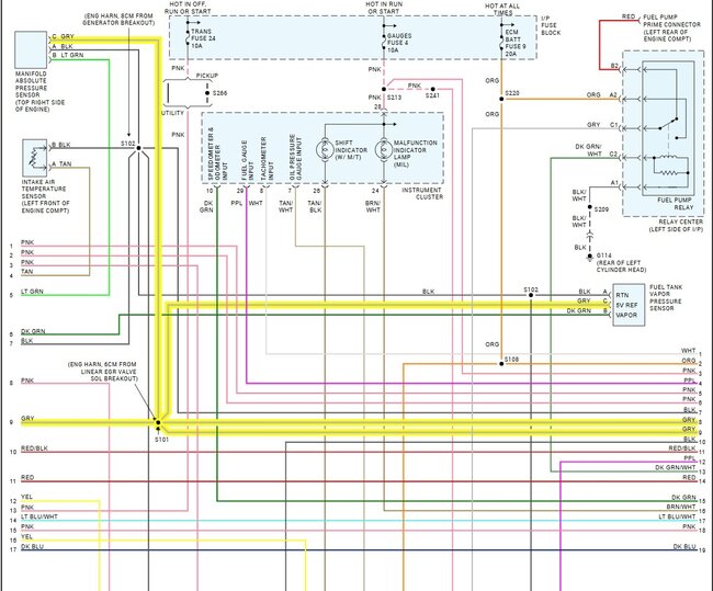

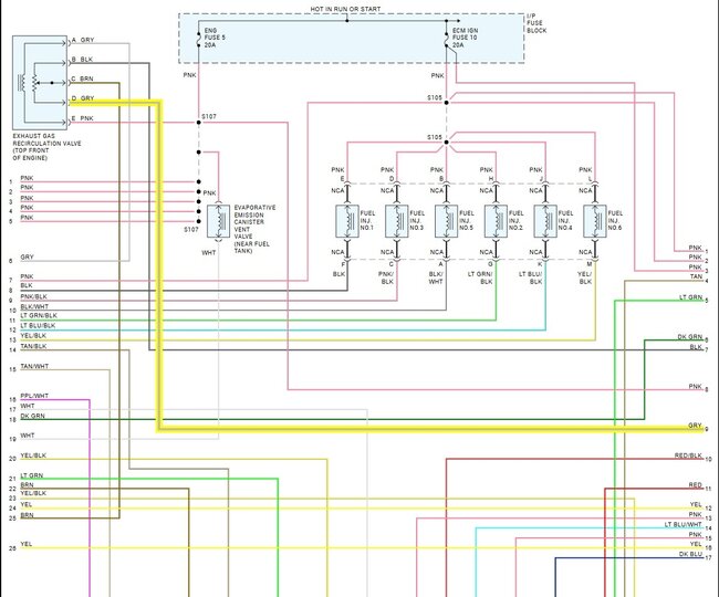

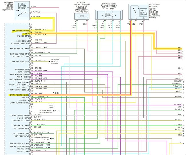

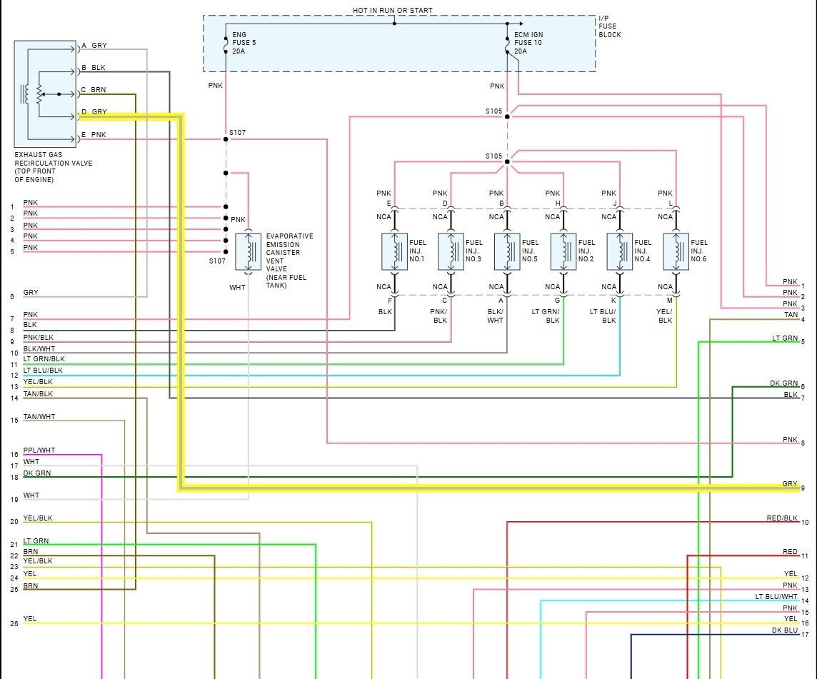

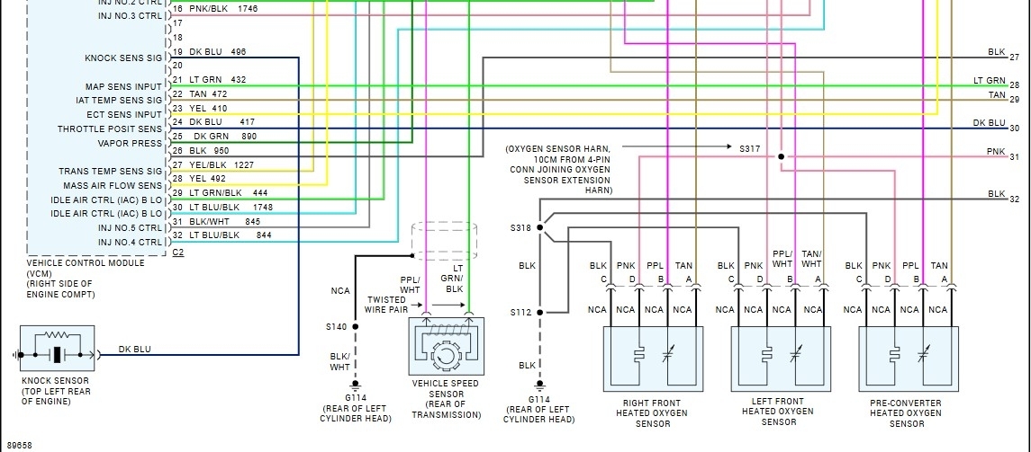

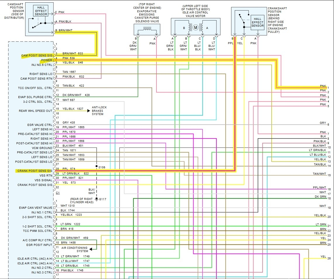

These are the PCM/ECM wiring diagrams, starting with the 5v reference side of the computer. Diagrams 1 & 2 are top and bottom, and so on. The 5 volt Ref on this vehicle is a Grey wire, you'll noticed its shared with a bunch of sensors, and even though there are 2 wires coming from the computer labelled "5v. Ref Voltage", this reference voltage is most like definitely shared internally inside the computer, so if it's a shorted sensor when hot, causing this fault, it can pull every 5v Ref down, this can even shut the computer down.
The MAP sensor or Throttle Position Sensor (TPS) will be the two easiest sensors to get to being right on top of the engine to check when the vehicle stalls out, since the fault sounds to be repeatable pretty easy, I would back probe the connector at the MAP sensor with a back probing pin, so you're ready to check it when the engine stalls out. You can put the other lead of a meter just to Battery negative for now. Key On, the grey wire should read a solid 5volts.

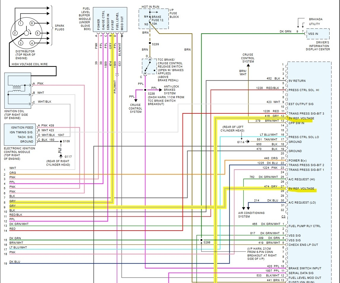

Diagrams 6,7 (top and bottom) are the last page of the engine computer diagrams, they don't have any reference voltage wires on them with the grey wire, but do have the Cam and Crank sensors, which are a 12volt feed to them, being Hall effect sensors.
I do see a Mass Air Flow sensor as well (MAF), that's another live data point to look at on a scan tool during the fault, I would expect the computer to store some sort of trouble code as well, if it's not, it may be losing power, and left long enough would end up erasing any diagnostic trouble codes.

But the main power wire that comes from the fuse panel when the key is on is a solid pink wire, it feeds the cam and crank sensors, as well as the injectors, ECM, and other 12volt components. So, check the fuse panels for any corroded fuses or corrosion underneath the fuse panel in the engine compartment, that's another location that causes problems due to being exposed to the elements. Relay connections can become corroded causing high resistance, so just other things to check.

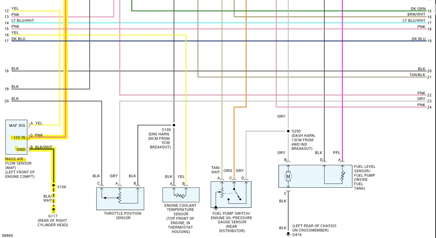

Well that's a good find, this engine has a MAP and MAF, and might run on a default fuel strategy if the MAF signal is missing, you could check that the MAF is not losing power or ground during the fault, Have the MAF connector already back probed to check for using the power feed and ground wire right at the MAF before replacing the sensor. But it sounds like you're on the right path, I'll post the power wiring diagrams for you.
Jan 10, 2025 at 8:44 AM
AL514
  • 5,641 POSTS
The MAF uses the same Pink wire for 12v power, and then a Black wire with a White stripe for a separate Ground, so putting a meter across those 2 wires to check for full power when the faults occurring, if its good, you can check the signal wire for a voltage signal, if its missing, you can either just replace the sensor, or go a little further and make sure the signal wire is not shorting to ground. Checking the signal wire for continuity to ground with the meter on a resistance (ohms) setting. This would be another live data PID for a scan tool to check, just depends on how expensive the MAF is.

TATERBUILT
Well, I went ahead and bought a new MAF, and the problem is solved. Been driving it for the last 3 hours with no issue.
