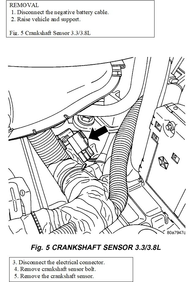

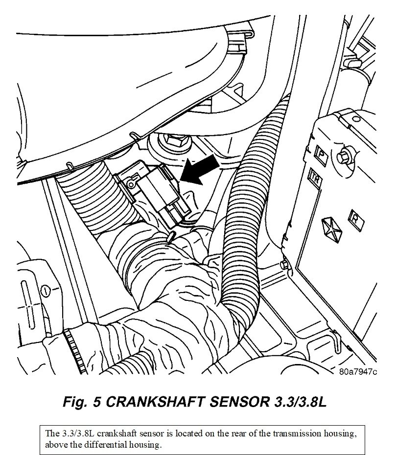

In this case, since this has been such a common problem, you might consider just replacing the crankshaft position sensor since it costs less than a trip to the repair shop. On older engines there was a very simple but important procedure to set the depth of the sensor. Yours is fixed with its mounting ear, so you just push the sensor in and bolt it snug. You can reach it from on top. It's near the driver's side of the engine, above the transmission.
The instructions say to raise the vehicle, which implies replacing the sensor from underneath, but I don't recall having to do that. If you do, please be sure to use jack stands:
Let me know what you find, and if you need the instructions for replacing the camshaft position sensor.
