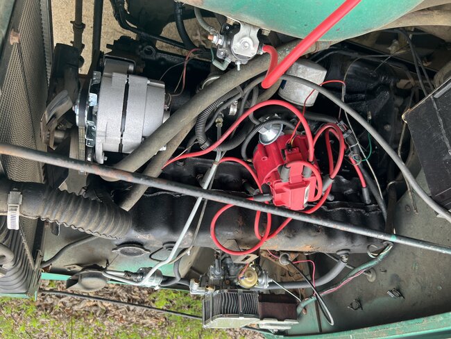

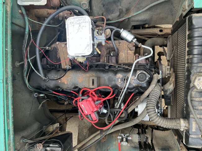

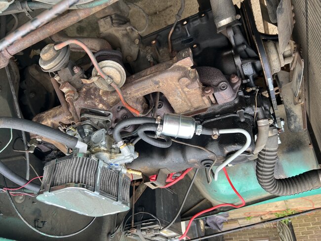

Okay, so first let's cover what I've done to the vehicle:
HEI distributor
New mechanical fuel pump
New fuel filter
Weber 38/38 carburetor
So, all that said, it cranks up great, runs great up to 30ish MPH.
Every time I go uphill (sometimes when on level ground) at 45ish MPH the engine starts sputtering and stalling, lunging and slows down.
I've got no idea what to do to fix this, I'm pretty much out of ideas. It's got fire, fuel, and air without issue but uphill it suddenly acts like it doesn't.

DONUTOLYMPIAN
Not sure why the pics are upside down, they appear right side up on my phone, sorry.

No problem, I have seen the fuel line going to the tank develop a small hole or crack which allows air to engine the suction side of the pump which allows the fuel delivery to be limited. I would replace this fuel line which should take care of the problem.
