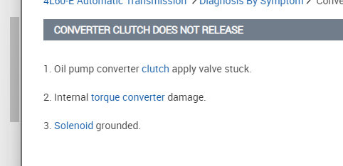

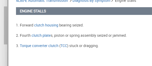

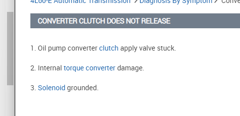

The fact that this is a stall in gear we need to suspect a possible torque converter issue. If this is locked up, then it will stall at idle only in gear.
This would also explain why it would stall when coming to a stop. Think of this like coming to a stop on a manual transmission and not pushing the clutch in.

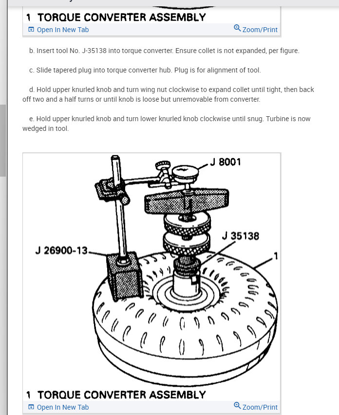

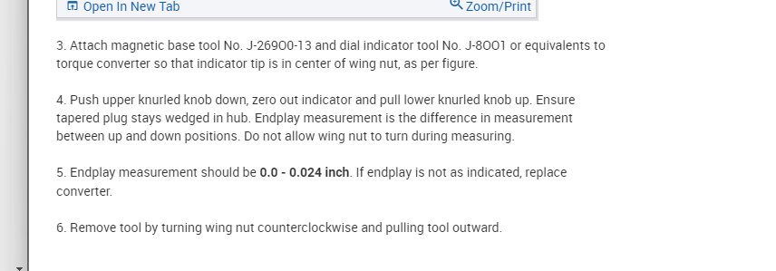

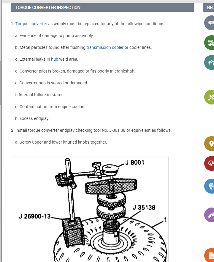

I am attaching a number of things that will help point to the possible issues but if you have a scan tool, we can monitor the torque converter clutch slip and application. It should be disengaged when put into drive.
