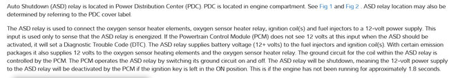

HMAC300
  • 48,601 POSTS
if you replaced asd relay and it fixe dit then it was probably a bad relay. I forgot about that see pic for operation of asd relay the pcm controls that.

LBECHIEF
Thank You, I have already read that passage from the manual. I did replace the relay, then did the old disconnect and reconnect the battery, started, let it run until she was up to temperature, put my shoulder against the door frame rolled it about an inch and it shuts off just like turning the key off. I,m gonna put it up and pull all of the wheels, look for gremlins attached to the axles. I know on some other vehicles the "hit from the rear" sensor, anything like that to look for?
