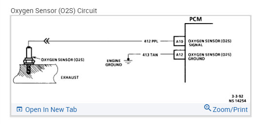

I have 2 possibly related problems. I bought the truck listed above K1500 with 275k on the dash and under 500 miles on the rebuilt 5.7L v8. It has a new starter, alternator, battery, brakes, rear brake lines, rims and tires. They also put an RV cam. I will note that the original motor was a 5.7L, but the rebuild is a different 5.7L. I ran the engine check because there was a light it comes up as Knock Sensor[I think it was code 43], i have read that is just because of the RV cam, and there's no fix other than removing the cam. I have a new distributor, coil, and plug wires to put on it, but I have yet to have that done. I've noticed the idle is closer to stalling in Drive than in Park while not moving either way. It seems like it gets close to stalling, and then receives fuel to keep going, but when it's in drive it seems closer to shutting off every cycle. I have yet to have it stall in park idling, only while in drive. If there's any other information I can provide that would be useful, I greatly appreciate any and all help. Thank you.

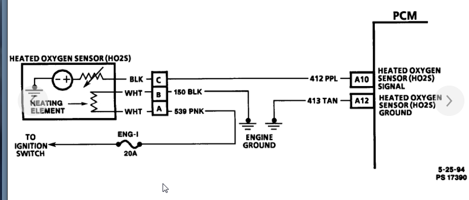

Let's start by checking the voltage on the o2 sensors. You should be able to monitor this with a scan tool in the PCM or just a meter on the signal wire.
We need to look and see if you have a three wire or single wire o2 sensor to determine if they are heated or not. That will change which wire is the signal. Clearly if it is the single wire sensor then that is the signal. Take a look at the wiring diagrams for more info.
