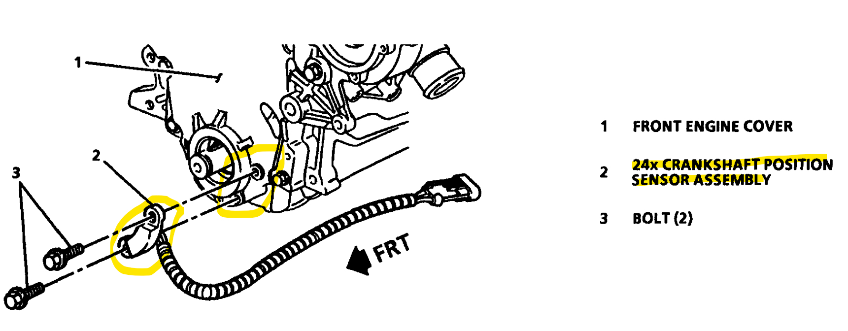

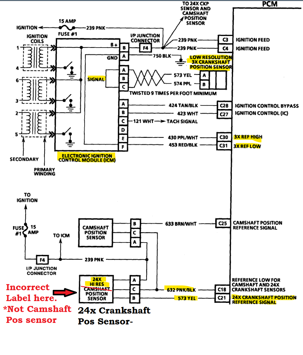

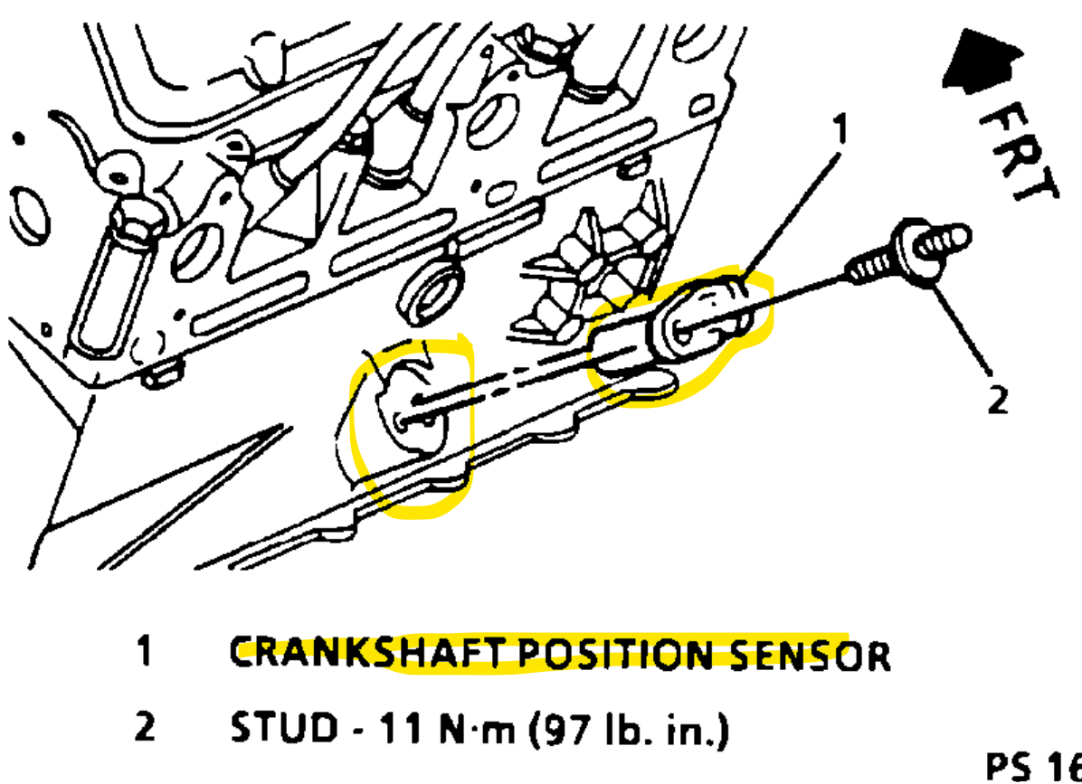

There looks to be 3 different possible locations for the crank sensor, that's why you're having trouble finding it, but Ill post all 3 and you can check. With the wiring diagrams.

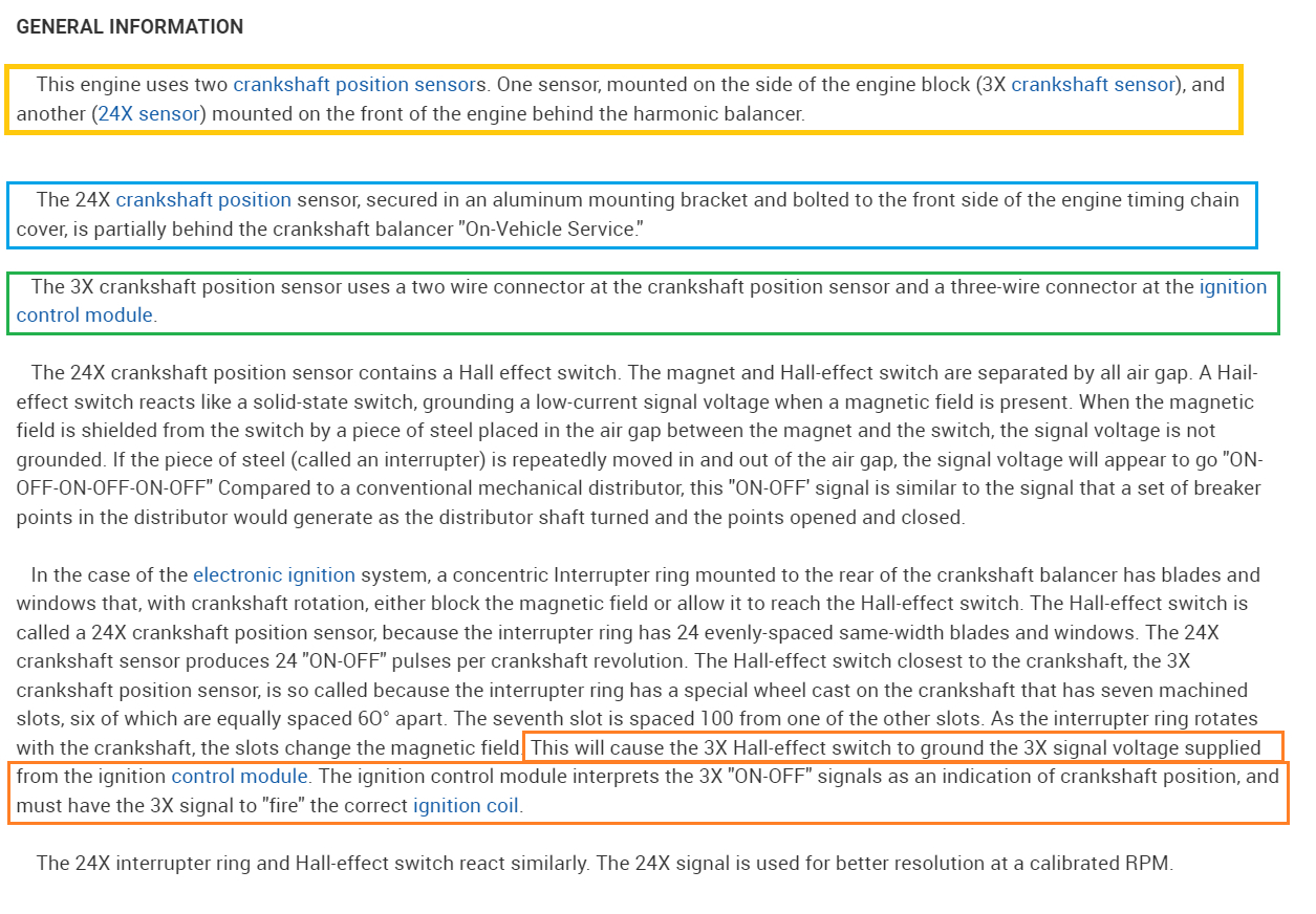

So, service info is stating this vehicle has 2 Crankshaft position sensors, a 3x signal that is connected and powered from the Ignition Module and is on the back side of the engine (diagram 3) it's a 2-wire sensor in the side of the engine block. The other sensor is a 24x crankshaft position sensor 3 wire which is behind the crankshaft pulley (diagram 2). It's a 3-wire hall effect sensor that sends a digital signal back to the ECM.
So, it's really important to verify if there is spark or not. Or if this is possibly a fuel pump failure.

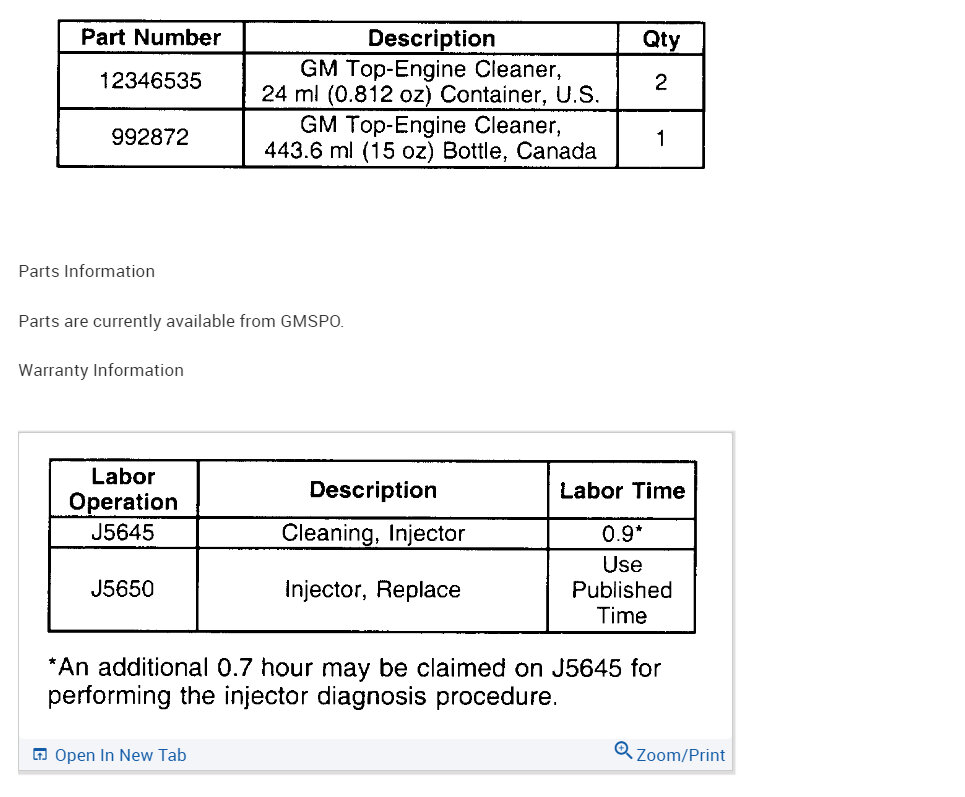

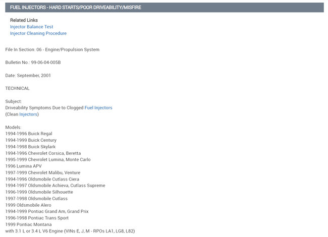

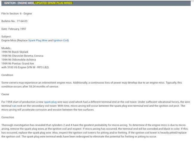

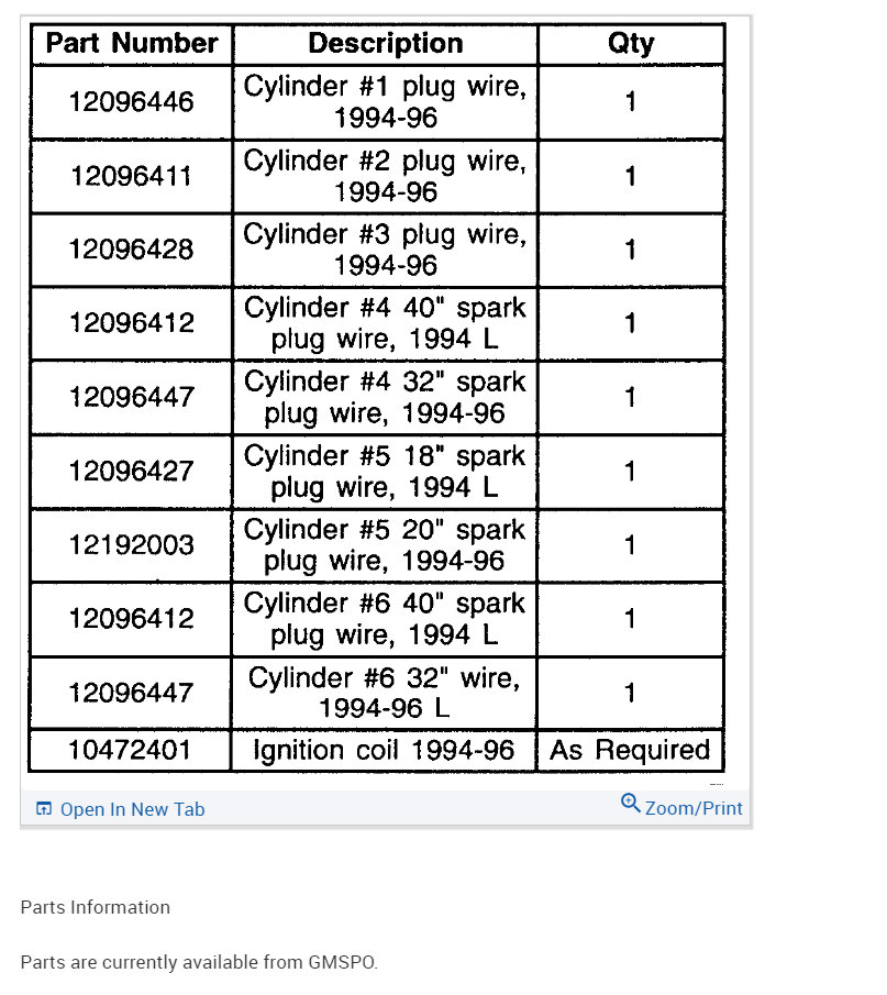

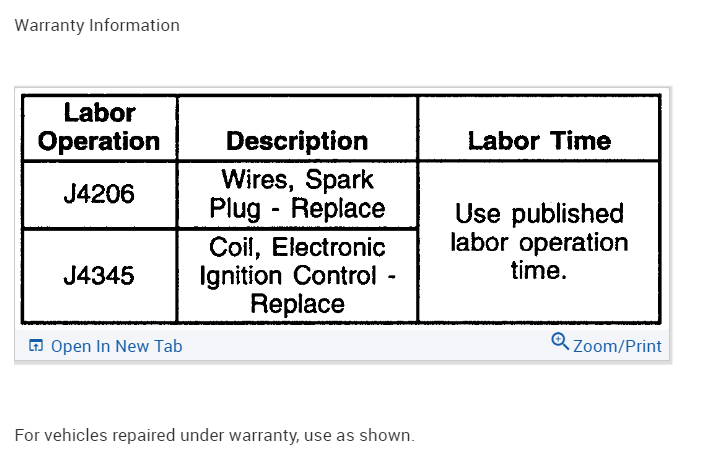

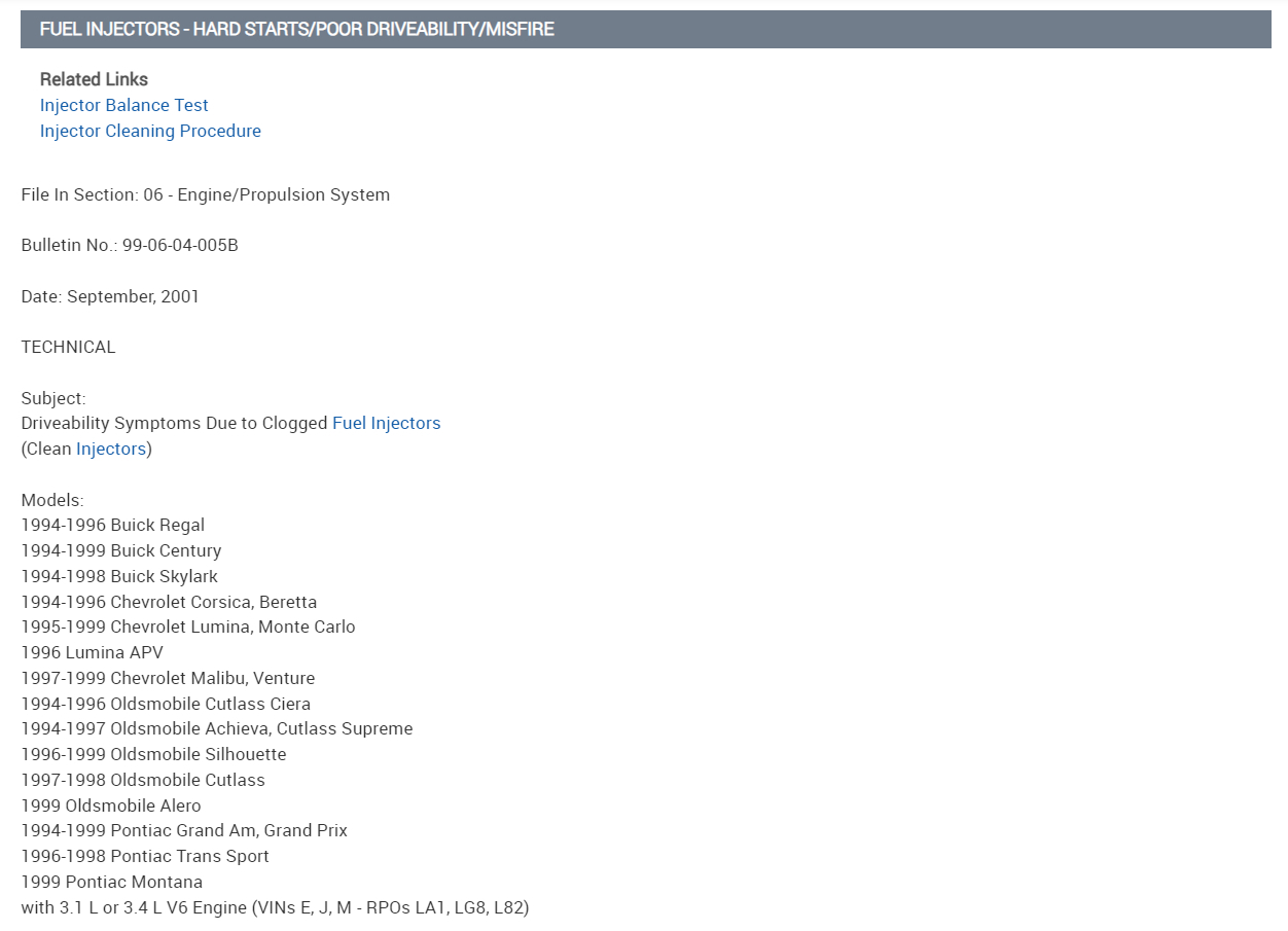

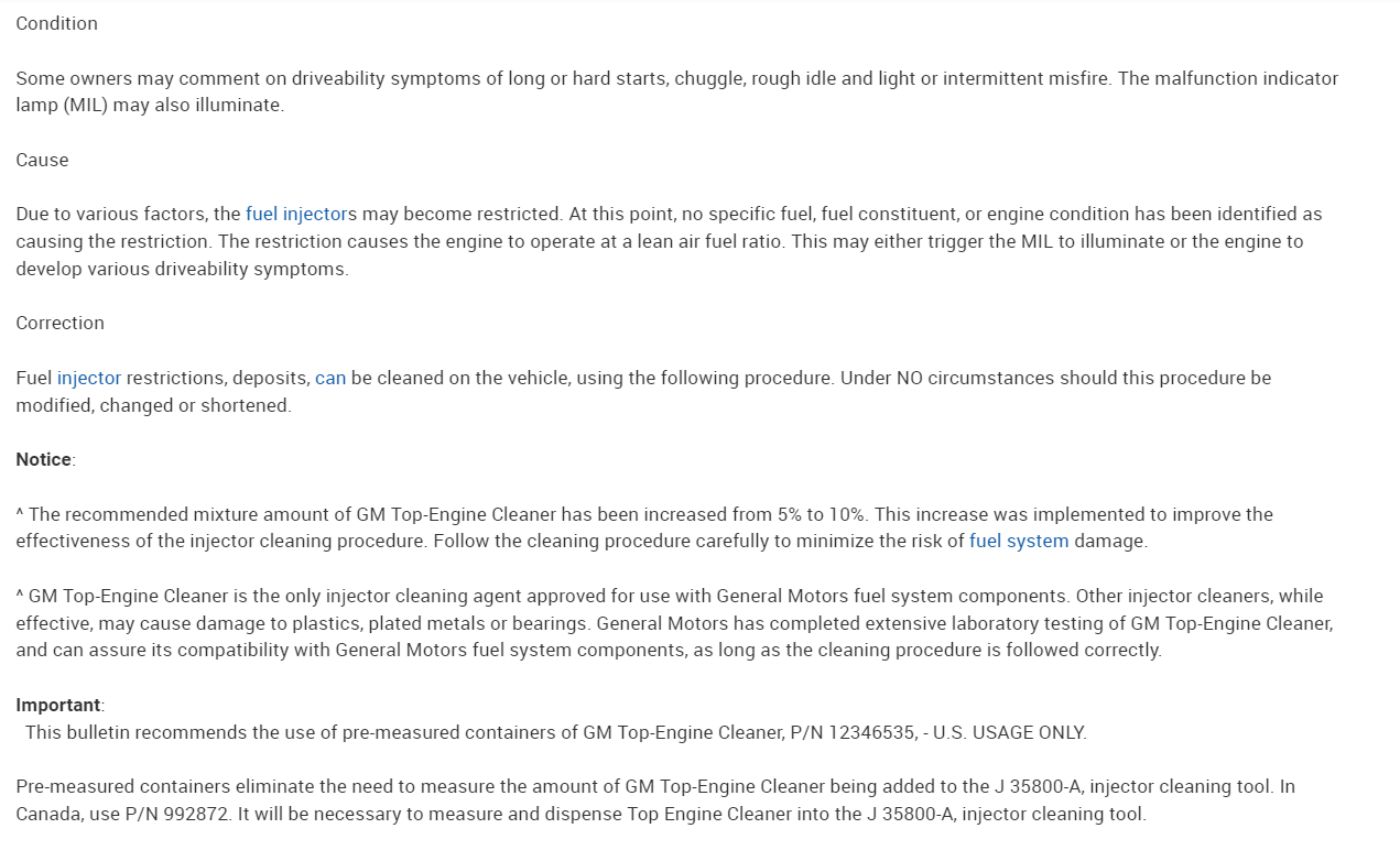

There are also 2 Technical Service Bulletins that can relate to the issues you're having. Diagrams 5,6,7 have to do with the Fuel Injectors clogging up and considering the age of the vehicle they should be tested with a Fuel Injector balance test.

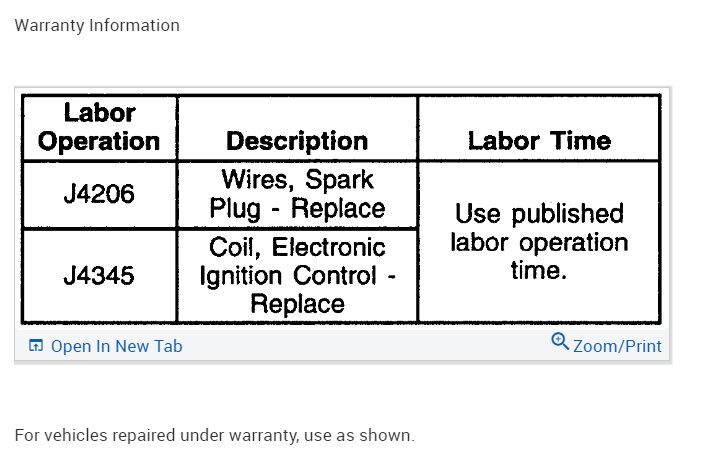

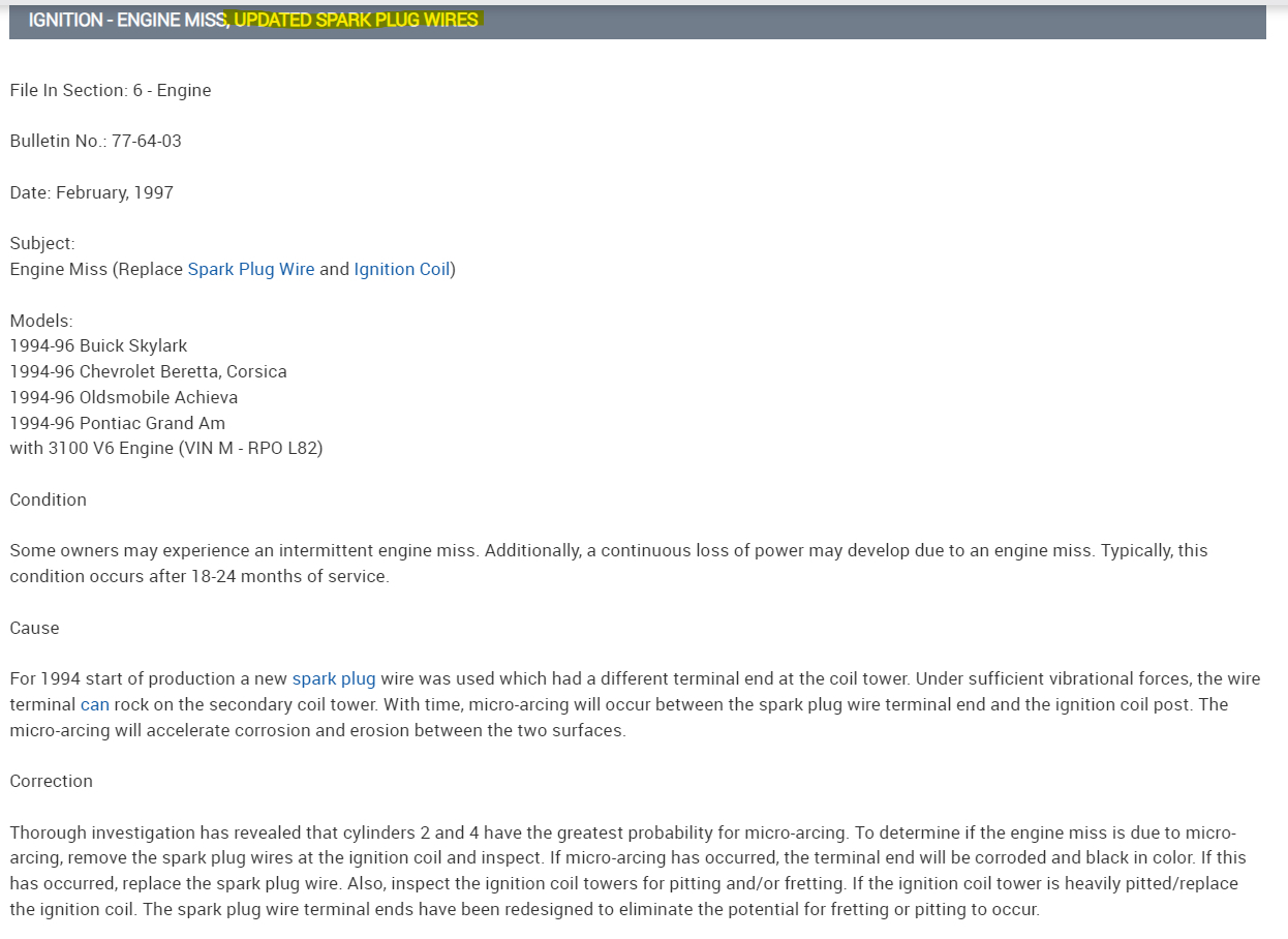

The diagrams 8,9,10 is for an updated Spark Plug wires and Ignition Module. There can be any number or combination of things happening here.

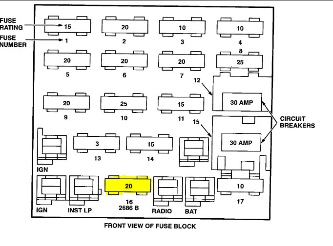

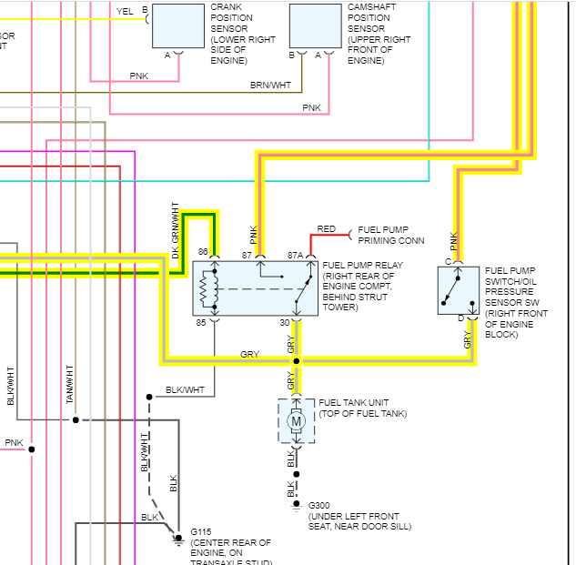

If you are certain the fuel pump isn't running, then let's start by testing our power supply.

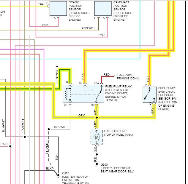

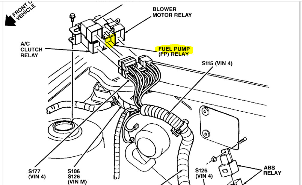

The fuel pump and fuel injectors get power from fuse 16 in the fuse box. Power from that fuse goes to the fuel pump relay and waits for the relay to be actuated. The relay is located at the right rear of the engine compartment behind the strut tower.
First, check the fuse. make sure there is power to and from it. Here is a link you may find helpful.
If the fuse checks good and has power, we need to test the relay and relay circuit. Here is a link that explains how it is done.

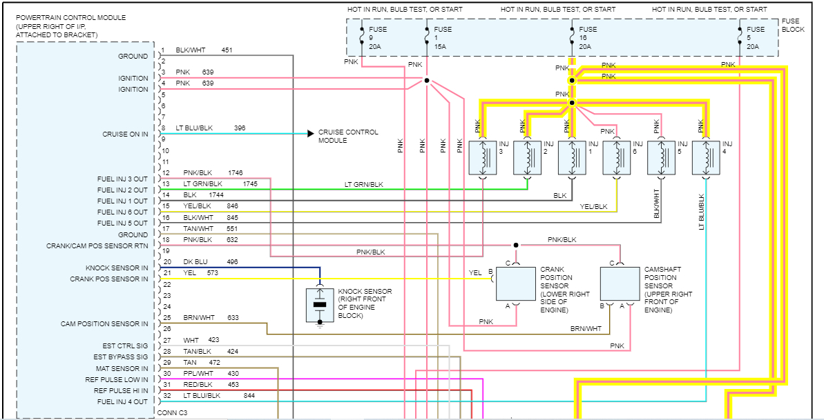

I attached a portion of the wiring schematic below showing the fuel pump circuit. Note the dark green wire with a white tracer. That is the power supply to the primary side of the relay. Power to the secondary is from the aforementioned fuse.
Do this and let me know what you find.
See pics below. I highlighted relevant wires. Pic 3 shows you what fuse to check. Pic 4 shows the relay location.

Okay, I replaced my fuel pump, that now I don't think was the problem. I put the tank back in and it was still not starting so I decided to check to see if I have power at the fuel pump. The answer is no. My question if My fuse is good where do I check to see what it could be. Now I thought of this emergency shut off ,if you get in a wreck it shuts power off to the pump if I have one where's it at or where and what do I check. I can't find a wiring diagram that's Just for fuel I know it goes from ignition to fuse box after that I'm lost. help me please.
