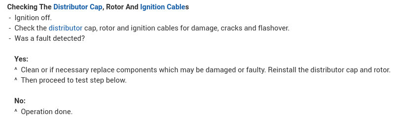

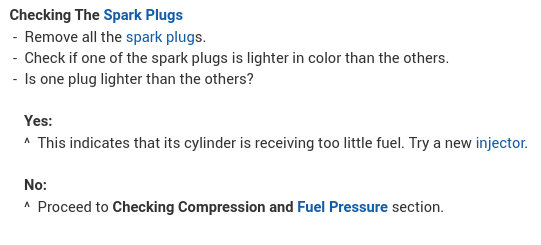

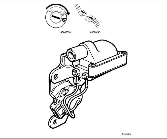

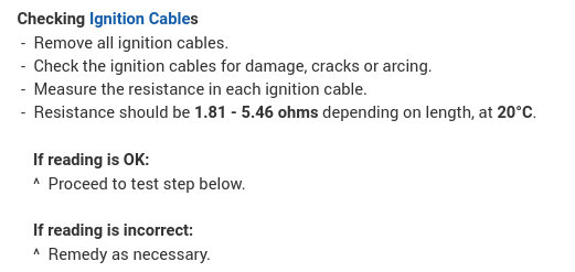

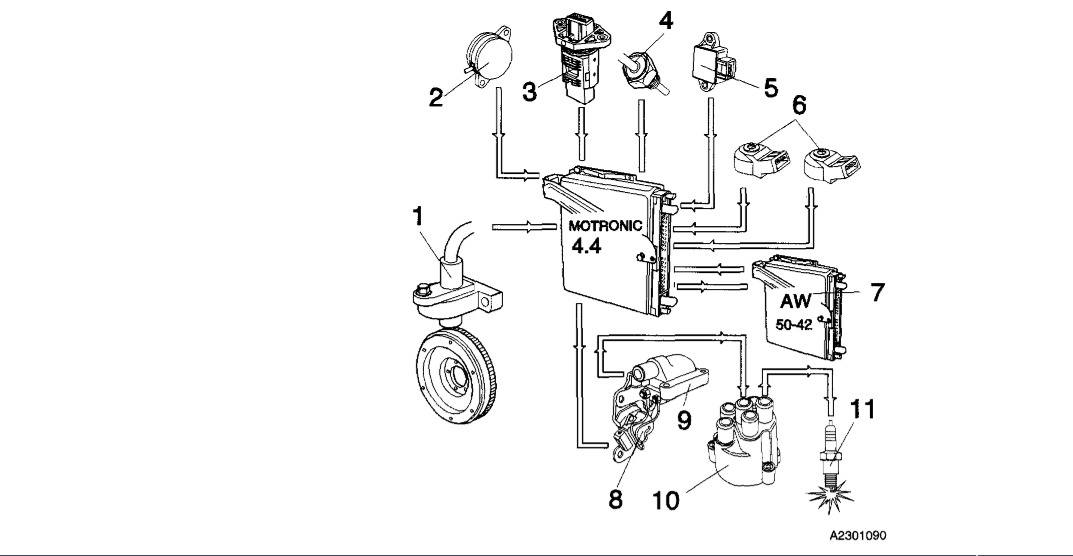

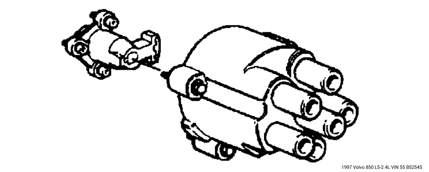

It does sound like you have an ignition problem, It sounds like the Hall Effect is faulty, known as the (camshaft sensor). I'm attaching some diagnostic service checks on the ignition system below please read and check the complete ignition system diagnostics for faulty parts. If the ignition system is operational check the fuel pressure and engine compression. Please let us know what fixed your car or if you need more information.
