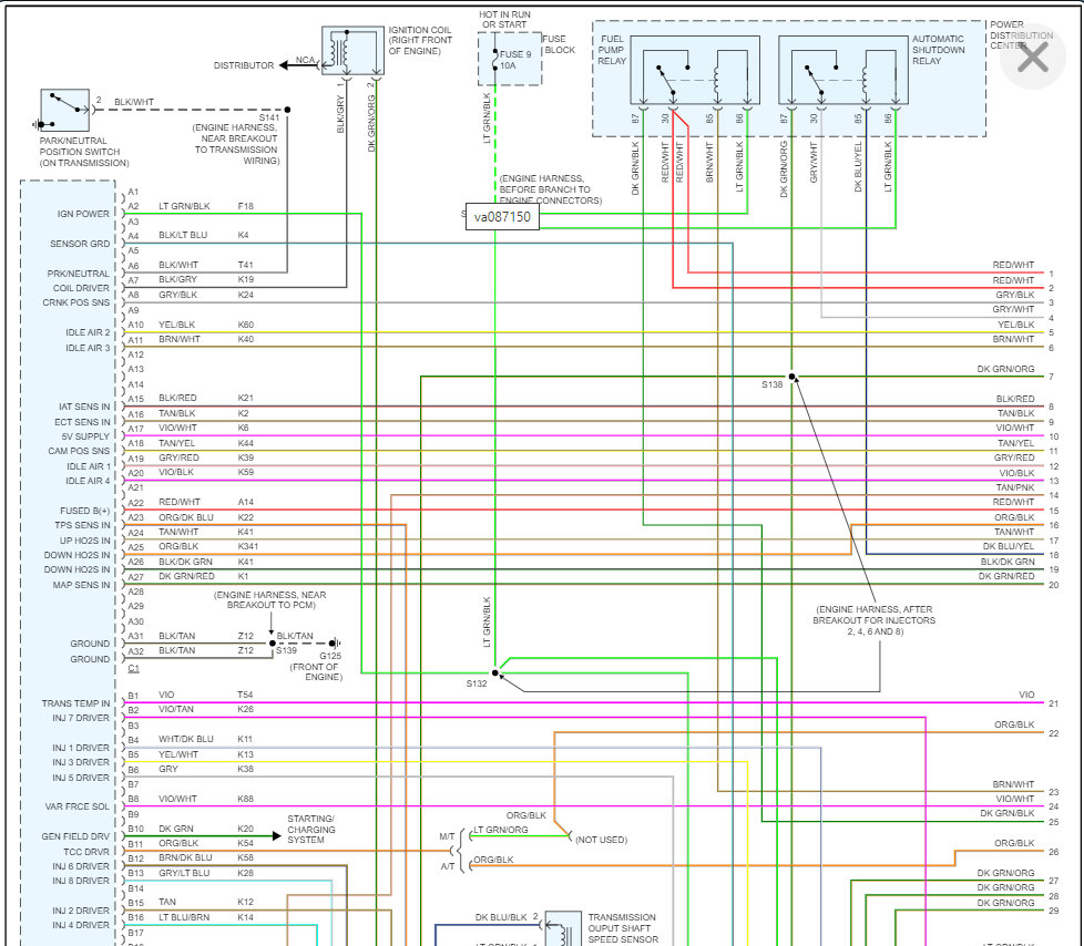

I have the truck listed above 1500. I went from a 5.2 to a 5.9 got an ECM for the 5.9 change the throttle position sensor, idle control valve, upstream O2 sensor, downstream O2 sensor, ASD relay, output speed sensor and my truck will either stall or not start. i had the vacuum lines re-hooked up by the mechanic and they're saying they don't know what it is. can anyone help me?

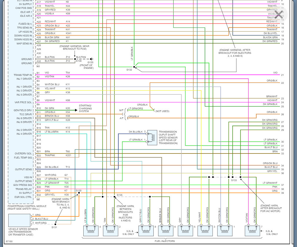

Okay, I will try to jump the ASD relay. Also, I checked the voltage to one of the plug-in harness to the ECM and one side was only getting 5.5 Volts. The only side was getting 12.5 volts. my question is what Voltage should my ECM get receiving?

Yes, the truck stalls and then restarts from time to time. also, I forgot to ask if I Upgraded my motor from a 5.2 to the 5.9 do I need to change the harness to fit the 5.9? The mechanic I originally took it to do the motor upgrade said no but also said that I don't need to do a 5.9 ECM and that it is the cluster causing my truck to shut off and stall.

From what I can tell it looks like the harness is the same, but I have not gone wire by wire. I am sure the connectors are the same but what I am not sure is that if some wires are in different cavities. However, I seem to remember that they are the same because I had a 1998 Sport that I looked to put a 5.9L in as well. I never did it, but a harness was not on my list.
What I suggest we do at this point is check for codes and make sure we don't have any. The cluster could be causing the issue, but I would expect you to have codes or at least the No Bus message in the cluster.
If we don't have any codes, then we can dig further into the harness.
