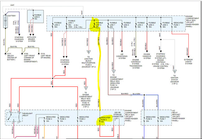

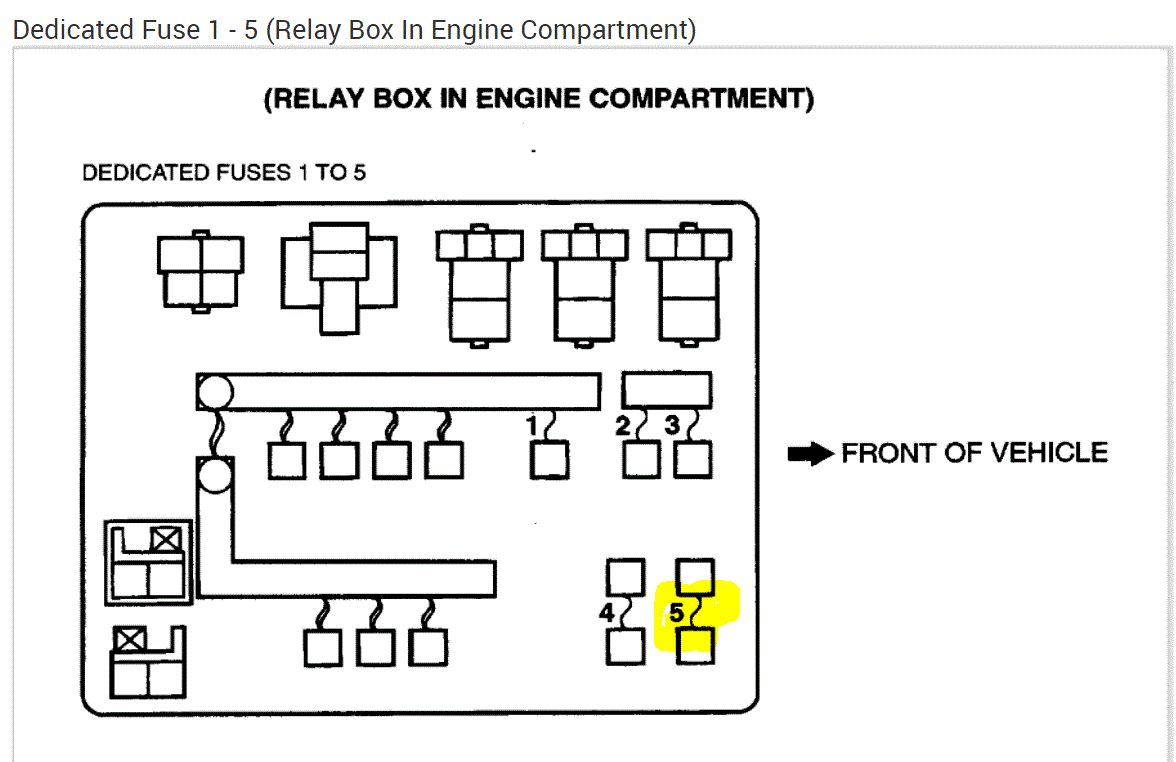

I need you to start by checking fuse 5 in the under hood fuse/relay box. If you look at pic 1 below, I highlighted the fuse I'm referring to.

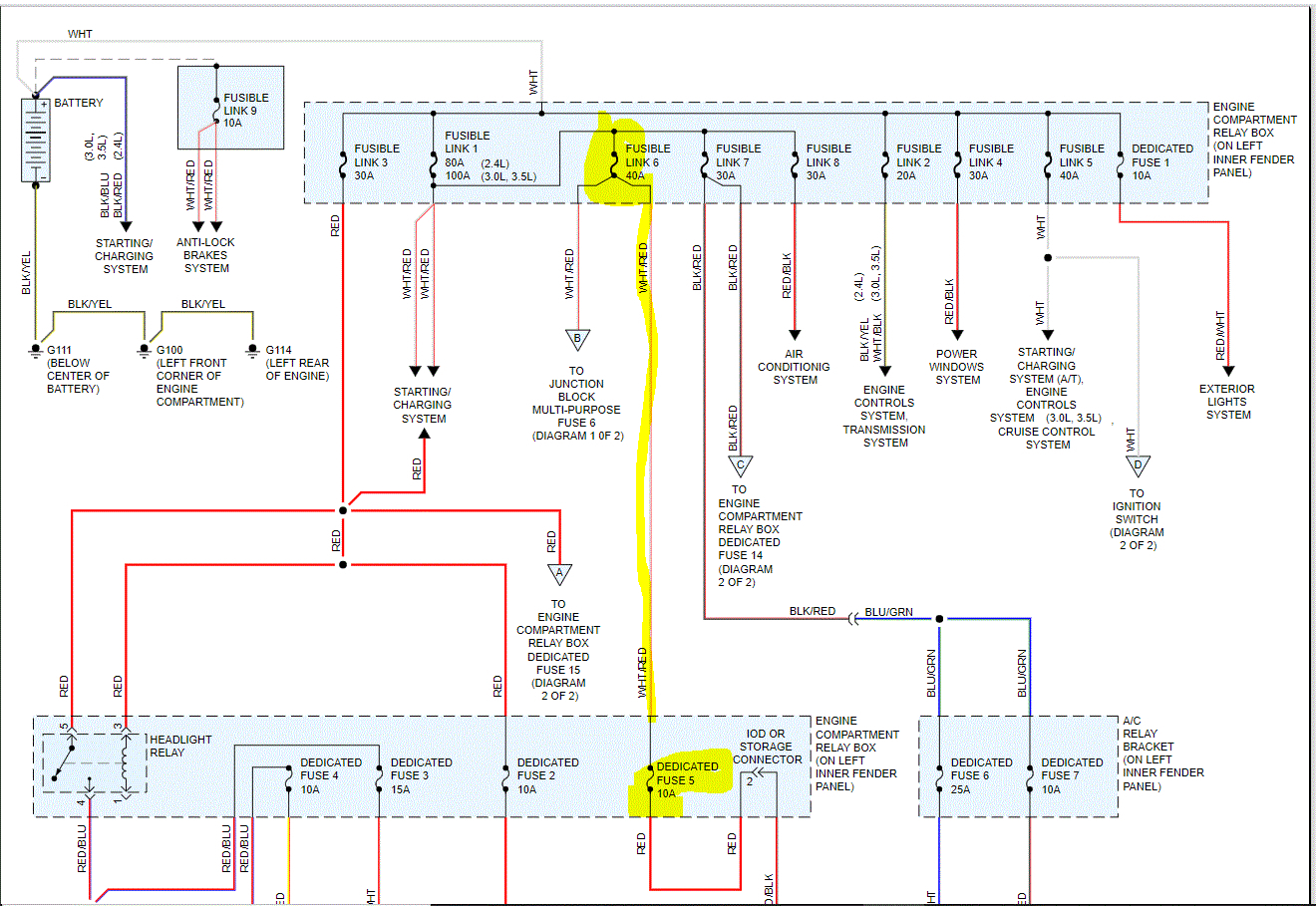

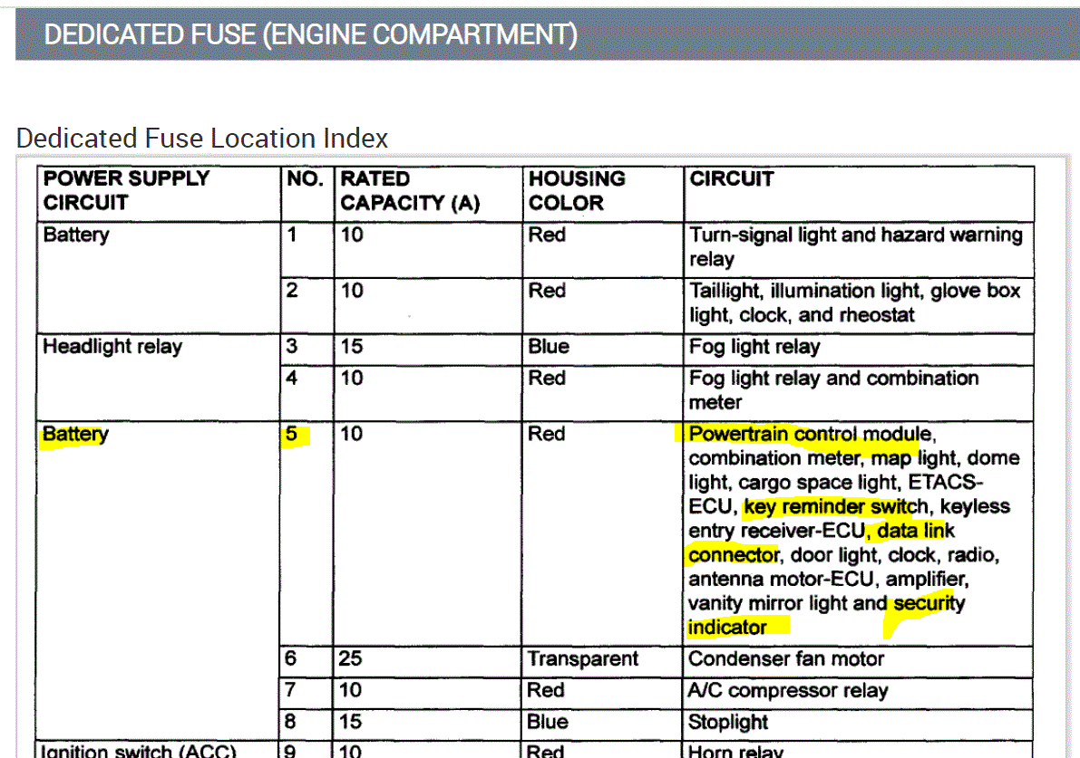

In addition to checking the fuse, confirm there is power to and from it. This fuse powers the data link connector along with several other components. We need to get the DLC working so you can scan the computer. Keep in mind, if the fuse is blown, it could be the cause of the problem. If you look at pic 2, it shows what is powered by the fuse.

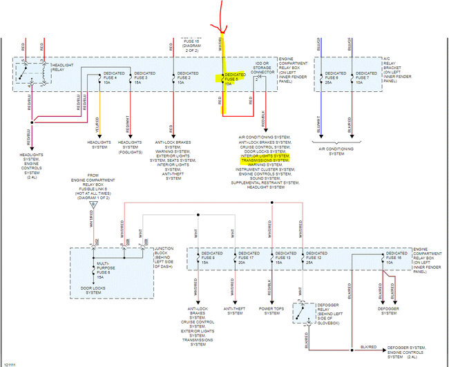

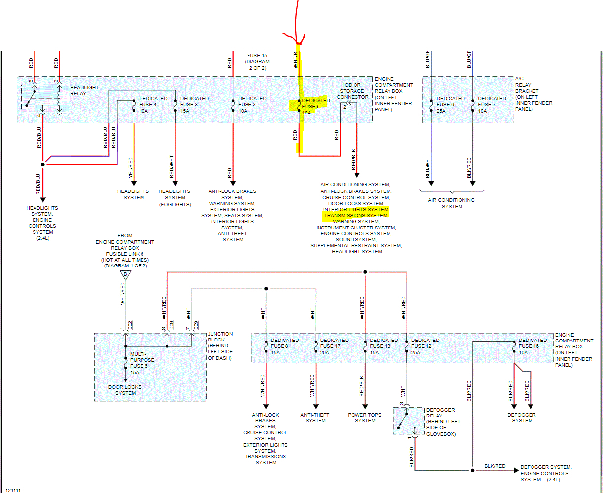

If you have no power to fuse 5, then chances are you have a blown fusible link. If you look at the attached pics below. they show the power distribution. Pic 1 shows fusible link 6 and if you follow the highlighted wire, it leads you to fuse 5. So if you don't have power at fuse 5, that is the first thing to check.
Check the fusible link and let me know what you find.
