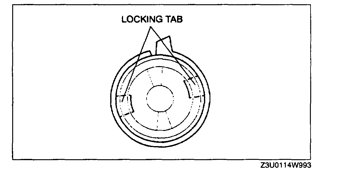

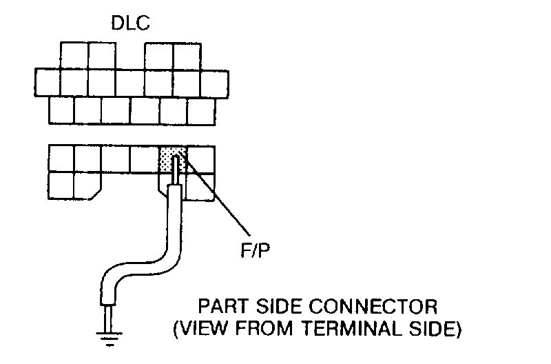

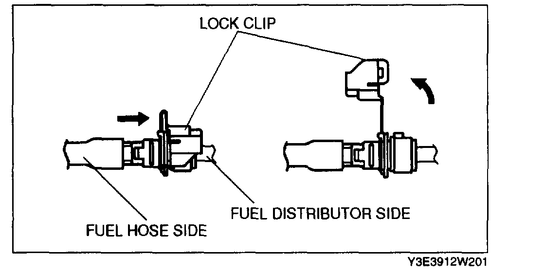

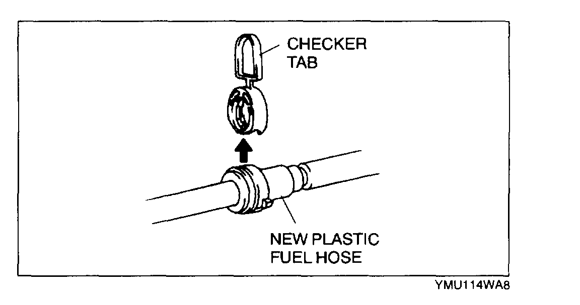

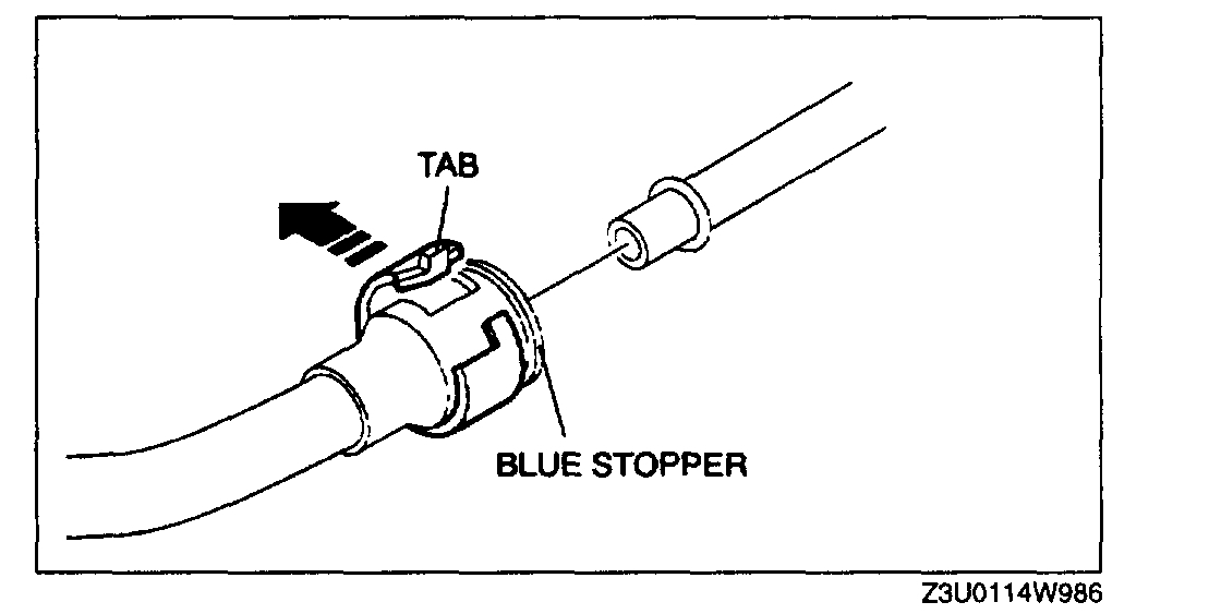

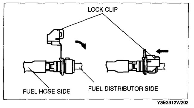

Here are directions for testing fuel pressure that I have. However, I am only showing a 2.0 and not a 1.6. In case you made a mistake, I am adding them. The attached pictures correlate with these directions.

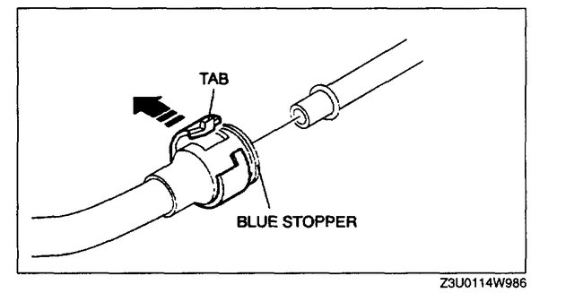

2. Disconnect the quick release connector from the pulsation damper as follows:
Picture 1
1. Push apart the lock clip and unlock it.
Picture 2
2. Lift the tab on the blue locking coupler until the fuel line can be released.
3. Pull the fuel hose straight back.
NOTE:
- The blue stopper may be removed from the quick connector. Be sure not to loose it. Reinstall it to the quick release connector before reconnecting the fuel line.
Picture 3
- The orange locking coupler has two internal locking tabs which retrain the pulsation damper pipe. Be sure that the tab on the locking coupler is rotated until it stops to release two internal locking tabs.

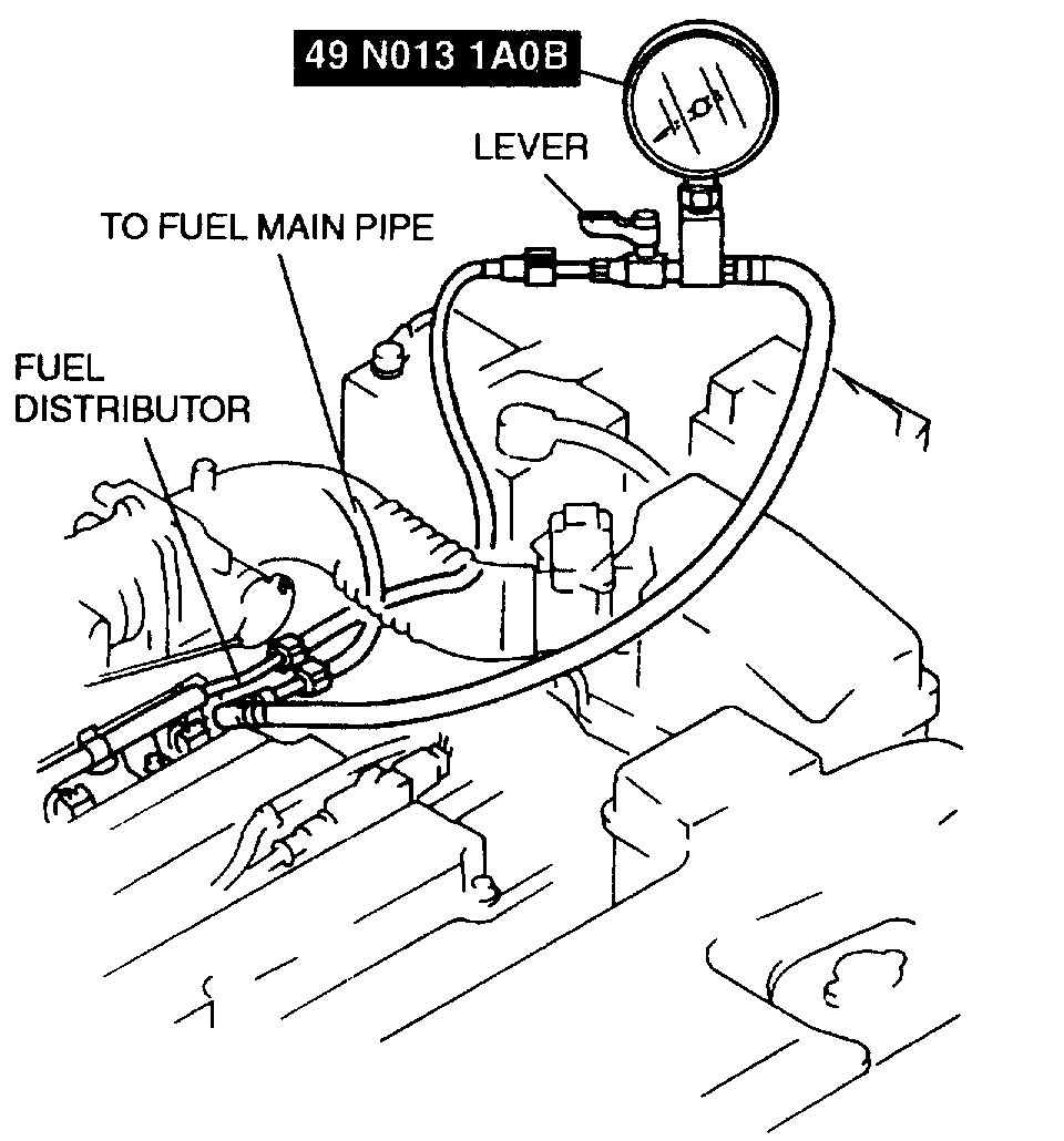

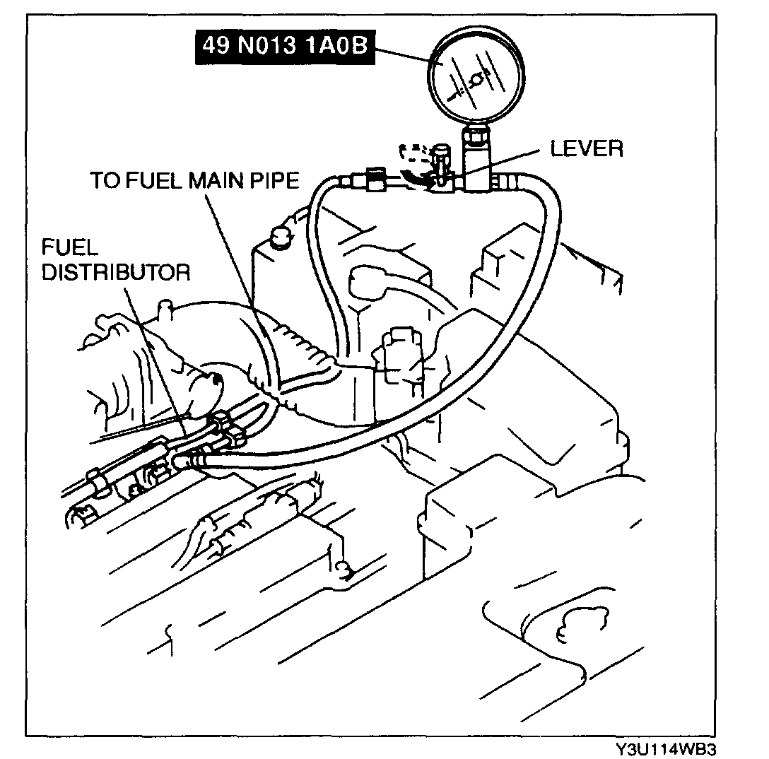

3. Push the SST quick release connector into the fuel distributor and fuel main hose into the SST until a click is heard.
Picture 4
4. Turn the lever on the SST as shown.
5. Connect the battery negative cable.

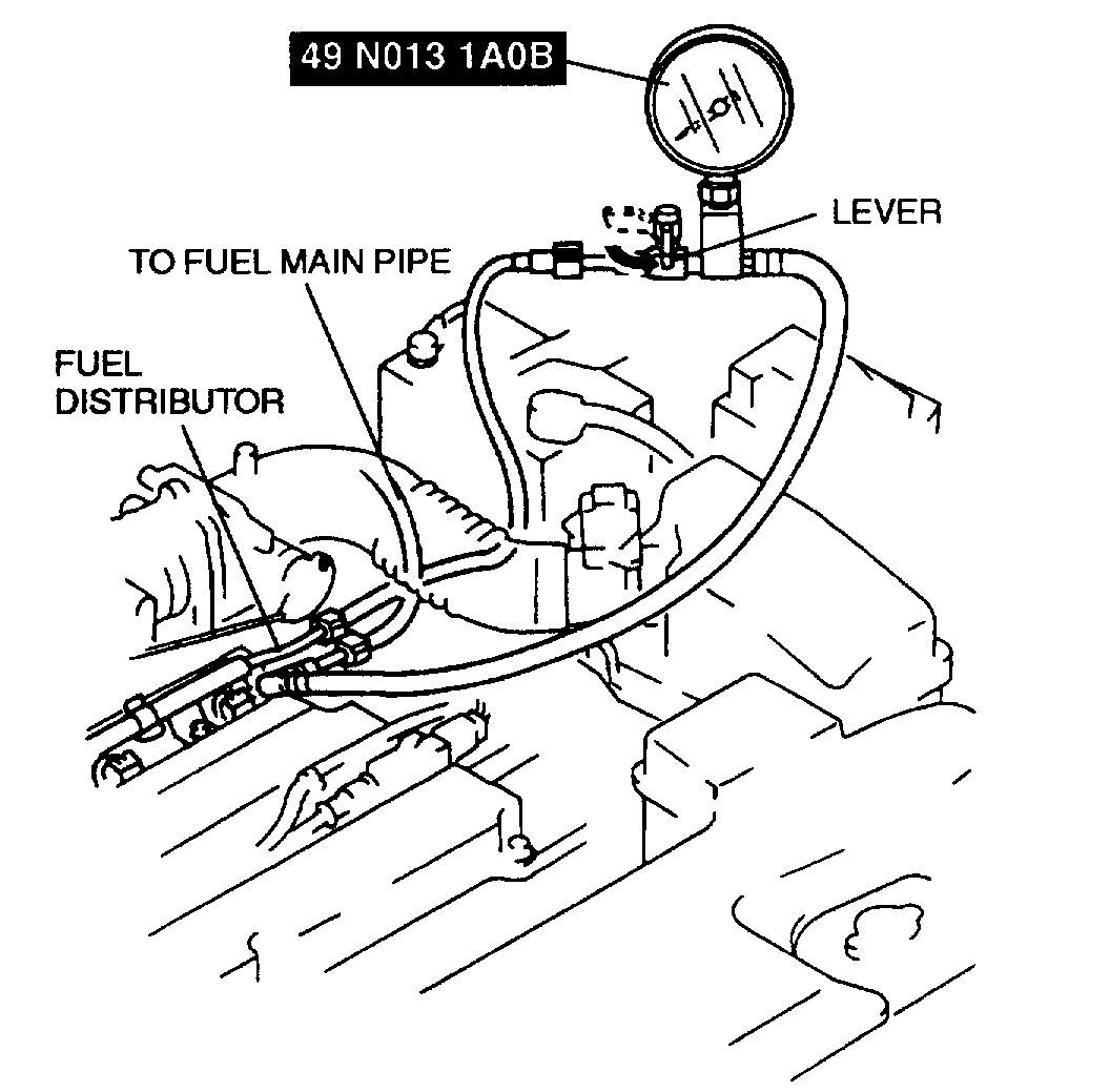

Picture 5
CAUTION: Connecting the wrong DLC terminal may possibly cause a malfunction. Carefully connect the specified terminal only.
6. Short the DLC terminal F/P to the body GND using a jumper wire.
7. Turn the ignition switch on and measure the fuel line pressure.
- If the pressure is higher than specified, inspect the fuel pump maximum pressure. If normal, inspect fuel return hose or the pressure regulator is clogged.
- If the pressure is lower than specified, proceed to Step (1).
Fuel line pressure: 270 - 310 kPa {2.7 - 3.2 kgf/sq.cm, 39 - 45 psi}

NOTE: A checker tab is integrated with the quick release connector for new plastic fuel hoses. The checker tab will be released from the quick release connector after it is completely engaged with the fuel pipe.

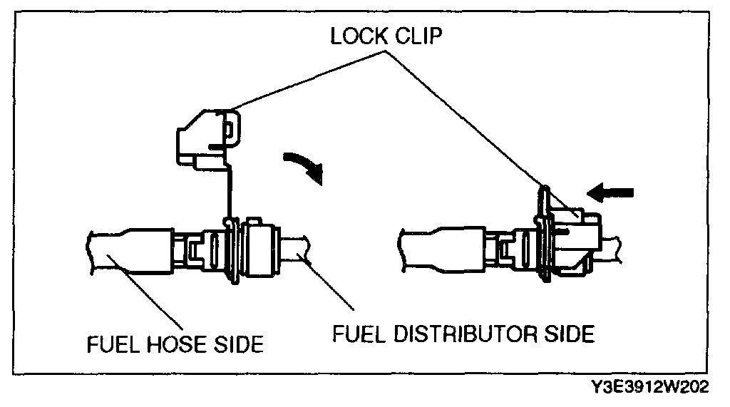

12. Reconnect the fuel main hose to the fuel distributor until a click is heard.
13. Pull the quick release connector by hand and verify that it is installed securely.
pic 9
14. Attach the lock clip to the quick release connector in the direction of the fuel distributor and lock it, as shown in the figure.
