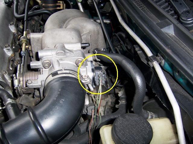

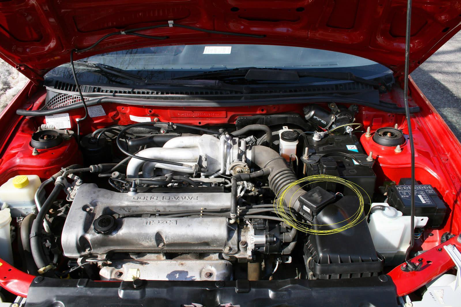

Which one do we need to check sir roy, I have two pictures here. Thanks for helping us sir. Were a little bit confused now :))

PAUROKISTA
  • 6 POSTS
Or this one?
Sunday, May 12th, 2013 AT 9:59 AM
  • 52,797 POSTS
The second one. That is the idle air. The first is the mass air flow
