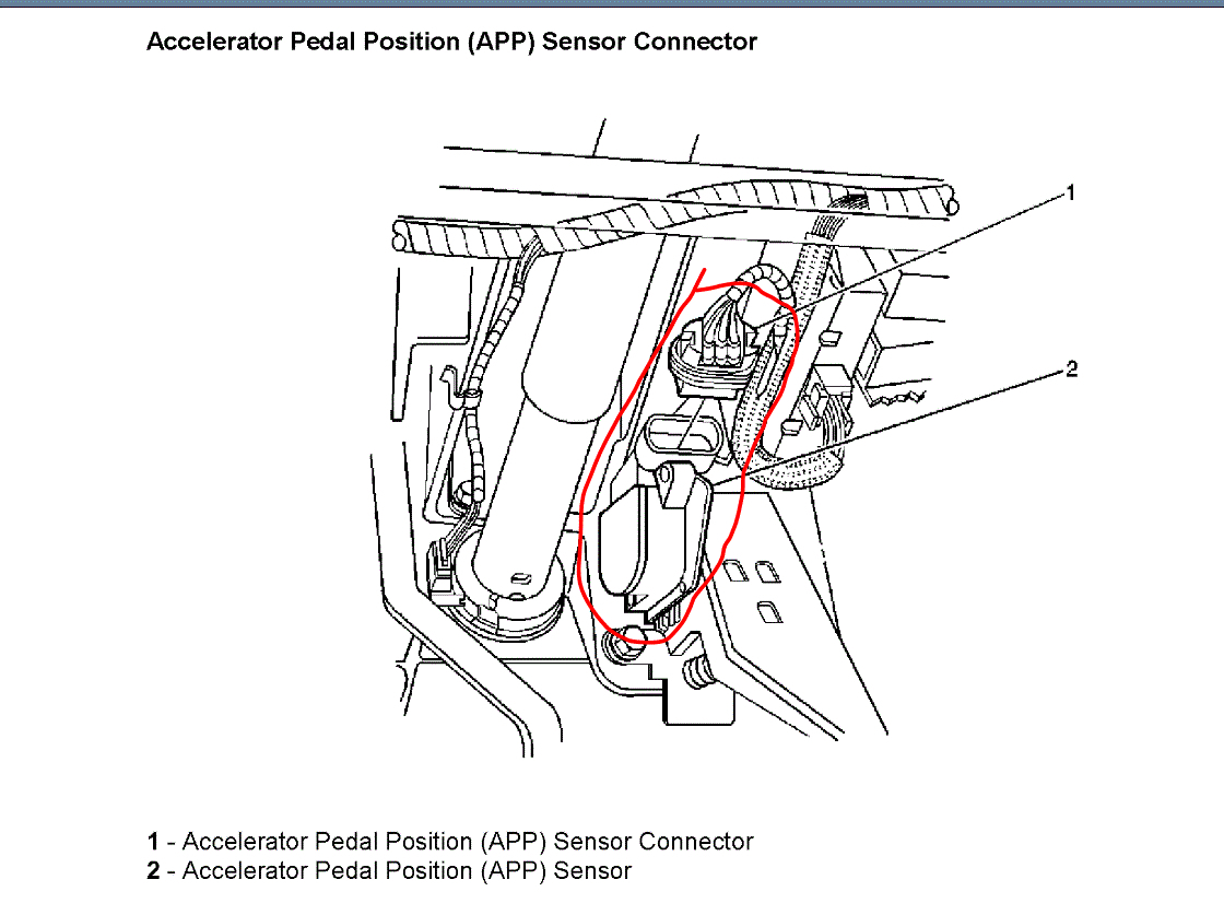

Since there are no codes, it makes it a bit difficult. If it was related to the throttle actuator control (TAC) module, it should have set a code. Do me a favor (and don't laugh), check the connector at the accelerator pedal position sensor to make sure it is not loose or the sensor isn't loose. Also, unplug it and check for corrosion or damage to the wires. I attached a pic of it to help you with location.

Will do Joe thank you!!

Okay Joe, just looked and all is secure. I pulled it and reseated. I find the fact that it only does it right around midway of the warm-up cycle interesting. And if it does stall you can start it back up immediately.

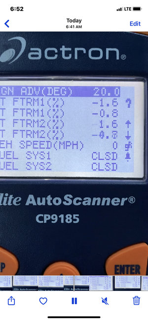

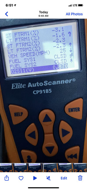

Okay Joe, the engine temperature is at 73 before I started and the thermometer in the car says it’s 65. Attached is a picture of about the time that it would normally do it although it did not do it this time. I did run a three minute video from just after starting all the way until virtually near full warm-up so I can go back and review that if you need me to.
May 12, 2020 at 3:55 AM
  • 110,194 POSTS
Did the ECT indicate the correct temps as the engine warmed up? Also, the fuel trims indicate the computer is trying to lean the mixture, but it's really not that far out of line.

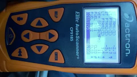

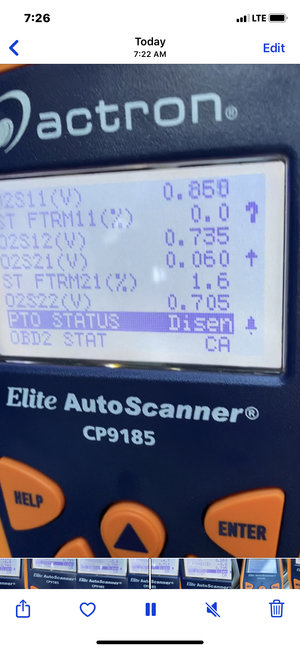

Thanks again for getting back. I think I mentioned that the ambient temperature yesterday morning was around 68° and before I even started the vehicle the temperature showed through the OBD 73° All four 02 sensors are brand new. This picture was taken around the time it would stall, but naturally for the past two days it has not reared its head.
May 13, 2020 at 4:27 AM

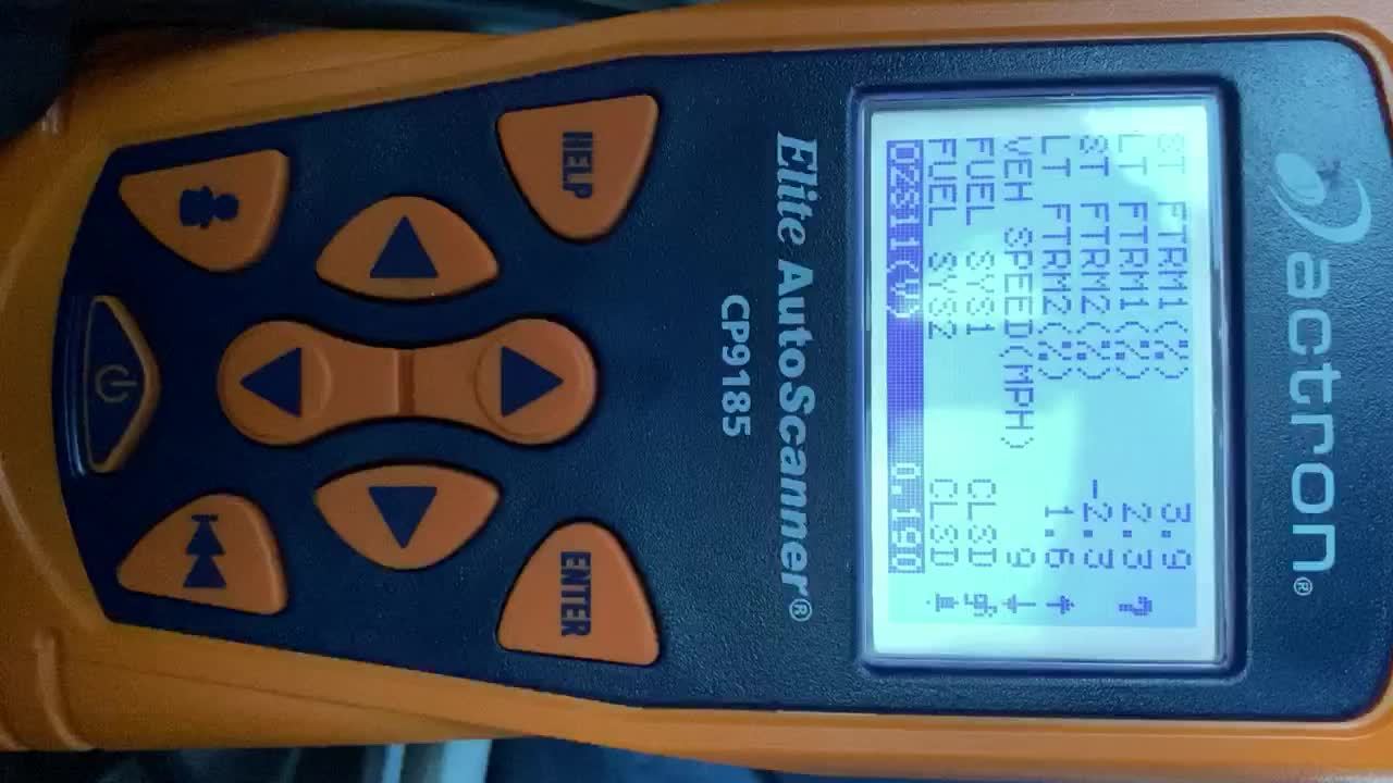

You are such a blessing. Okay, this morning the outside ambient temperature was around 68. I was recording for four minutes as the engine was warming up and I was driving. Right around the three minute mark of the video the temperature gauge was reaching around the point where I have issues. Although it did not stall this picture that I’m attaching shows that the RPM's were dropping to probably around 450 and normally it would idle at around 550. I could see the needle starting to fluctuate like it normally does. And this is as close to the condition as I can get without a stall. It showing all of the fuel trims leaning out pretty good. I have did the test previously were you spray carpet cleaner around the intake to see if there’s any vacuum leaks but didn’t have any detected. I also made sure all the intake bolts were torqued correctly. As I mentioned all the O2 sensors are brand new I just put them in a week ago.
May 14, 2020 at 4:02 AM
  • 110,194 POSTS
Did you send a video? Also, the trims indicate the computer is trying to reduce the fuel to the engine. It is getting more than is needed. But it isn't totally out of the norm. Was it fluctuating when this happened?

Hahaha. Siri kills me! Here is the video I took. I believe it was somewhat near the three minute mark was where I noticed the tachometer was indicating a drop from normal 550 idle to 450. If a stall happens it will start doing that and then of course the RPM's just continue to fluctuate a bit and drop all the way until the style takes place. Obviously it did not this time but here’s the full video from this morning:
May 14, 2020 at 8:48 AM
  • 110,194 POSTS
I watched the video, and everything was in spec, including the O2 sensor's reactions. There was nothing indicating a fuel pressure or vacuum leak related problem. That leaves the throttle control module. That is something that needs checked by a dealer or someone that has an upper level scan tool.
