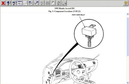

Hi francisco84,
Symptoms are consistnt with an intermittently failing PGM-FI main relay. When it fails, the fuel pump would not work.

Hi needydecatur2,
When sparks are available, the next thing you should check is the fuel.
When ignition switch is turned on, listen for operations from the fuel pump. If none, you should check the PGM-FI main relay which is known to fail intermittently. Resolder the circuit board if you fins any cold solders.

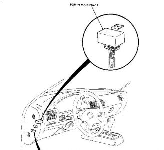

99.99% sure your pgm-fi is the problem. i've lost count on how many these i've changed. the symptom that gives it away is it won't start after sitting in the sun. the relay is located under the driver's side near the steering column. its "fun" to change. make sure to get it from honda. it's a big relay with two plugs going into it.
