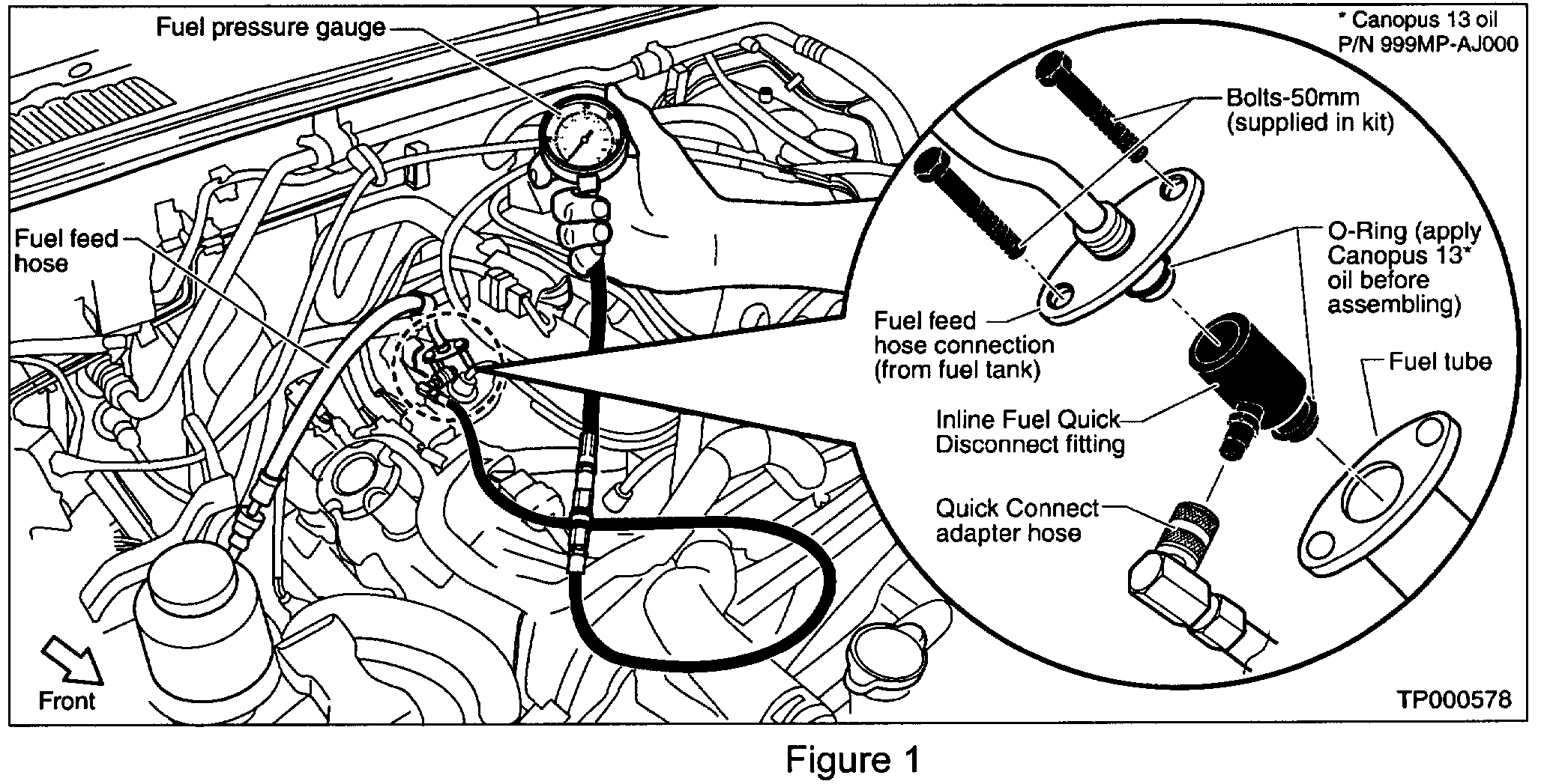

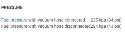

When driving at any speed or in any gear the gas pedal will suddenly become unresponsive and the engine will stall several seconds later. Usually one to six seconds after. When I restart it, the idle is inconsistent and jumping up and down until it stalls again. This will happen seven to fifteen times before everything goes back to normal.
Used to happen once a day now this is happening all day and vehicle is parked until I can fix it.

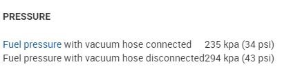

Now, there are a couple other things which could be checked. Both a weak fuel pump (low pressure) or an ignition problem (such as a bad crankshaft position sensor) can be an issue.
Here is a link which describes how to check fuel pressure:
The first picture below contains the fuel pressure specifications required by the manufacturer. The second is where the pressure gauge is connected.

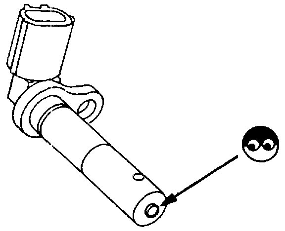

Next, a bad crankshaft position sensor can act similar to what you described and never set an engine code. (the check engine light never comes on). Read through this link which describes symptoms of a bad sensor.
If you find the sensor is the issue, here is a general guide for replacement

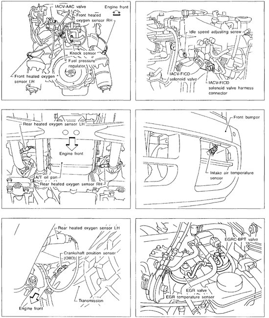

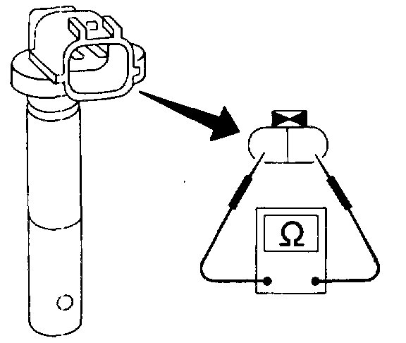

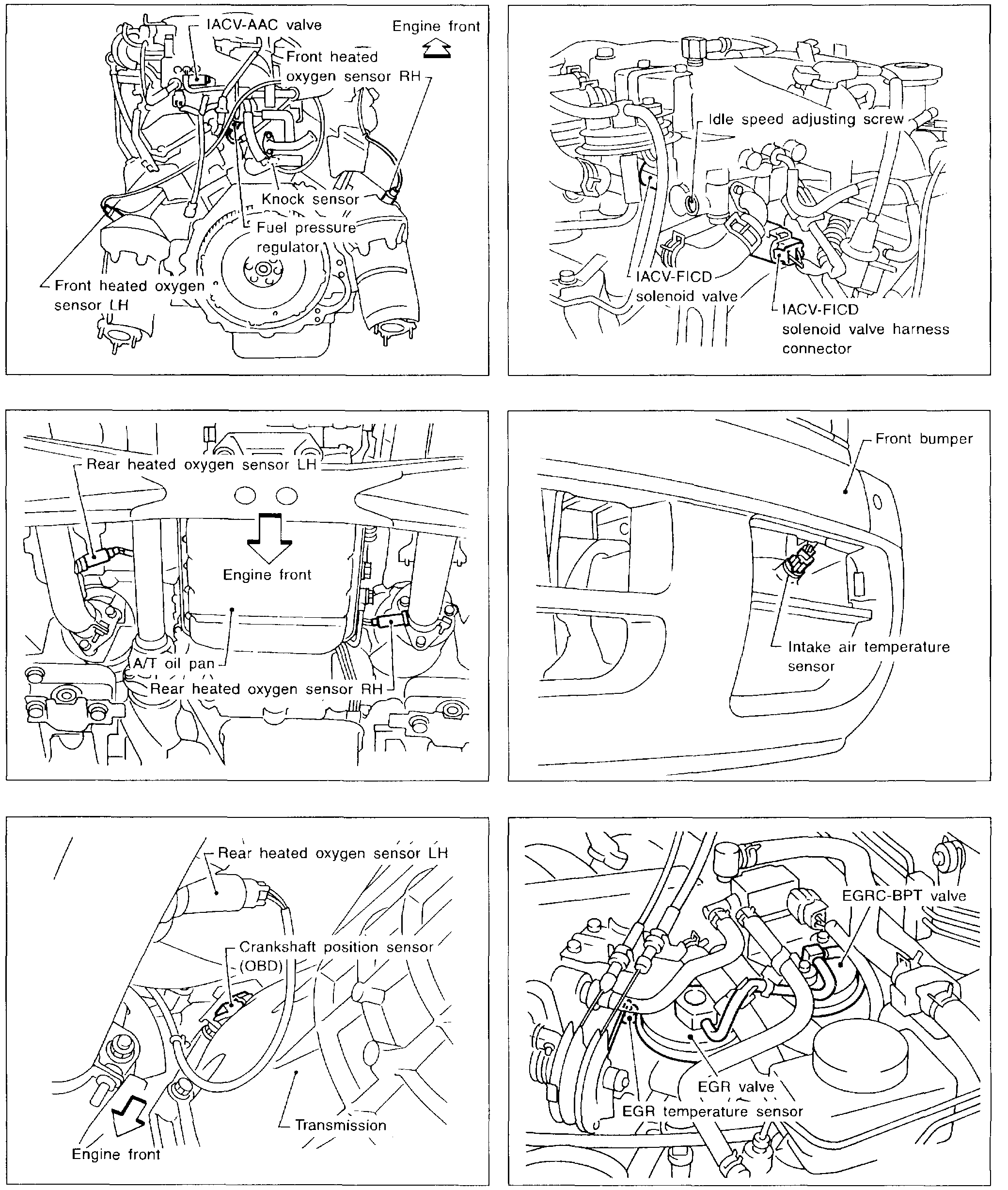

If you feel the sensor should be checked, here are the specific directions from alldata specific to your vehicle. Pictures three and four correlate with these directions.
CRANKSHAFT POSITION SENSOR (OBD)
1. Disconnect crankshaft position sensor (OBD) harness connector.
2. Loosen the fixing bolt of the sensor.
3. Remove the sensor.
4. Visually check the sensor for chipping.
5. Check resistance as shown in the figure.
Resistance: Approximately 166.5 - 203.5 Ohms [at 20°C (68°F)]
If NG, replace crankshaft position sensor (OBD).
Picture five is the location of the sensor.
