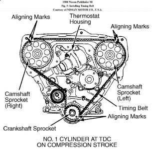

I had to pull home a car yesterday. After I got it home I went to run an errand and the pathfinder just shut off.I was able to start it a couple of times it seemed week and I could smell a sulfur smell. Had it pulled home. Started last night but I shut it down. Started it today but died when I applied gas and won't restart. Help you don't think towing a car did this do you
Wednesday, September 30th, 2020 AT 3:32 PM (Merged)
KHLOW2008
  • 41,814 POSTS
Hi project37,
Thank you for the donation.
I don't believe towing another vehicle did this.
You would have to start from the basics to understand what is wrng. Here is a link for you to check out what is missing causing the non starting. Let me know if you have additional information.
https://www.2carpros.com/kpages/first_things.htm
Follow the link that aptly describes the condition.
PROJECT37
  • 13 POSTS
I know that it is getting plenty of gas to the throttle body and there is spark to the plugs what is left. I forgot to mention. The shows this to be an idle up solenoid it seems to be wet sometimes
