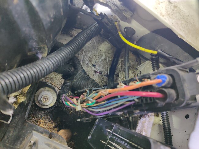

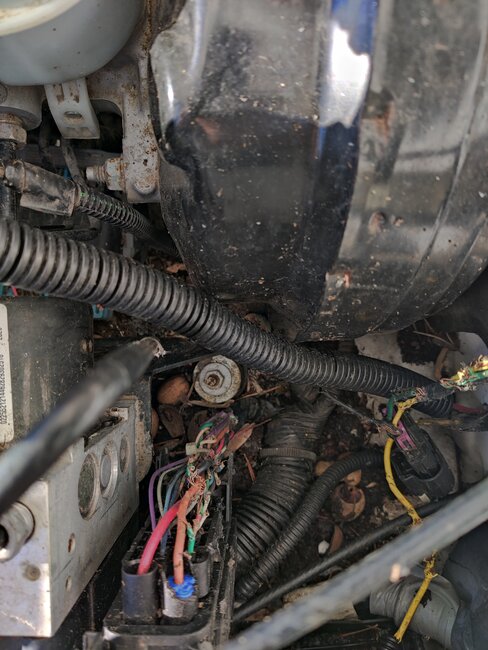

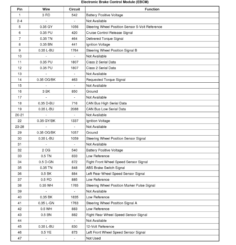

So, I'm repairing a truck for a widow. It had been sitting for 5 years when her husband got sick.
So, it has had squirrels under the hood. I've repaired the throttle body wiring, the windshield wipers but those were the easy repairs. The connector to the ABS pump was mangled. I'm free-pinning the connector one wire at a time to solder extend heat shrink reach damaged wire. But I've encountered a wire without and obvious place to reconnect. Does anyone have a wiring diagram for this connector?

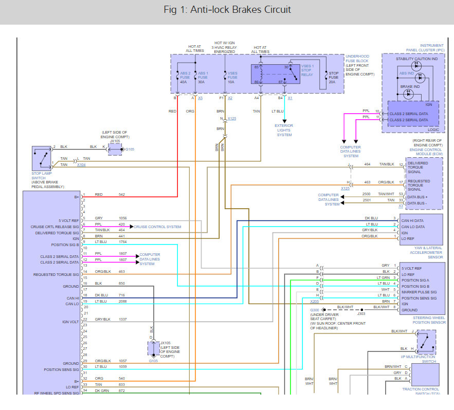

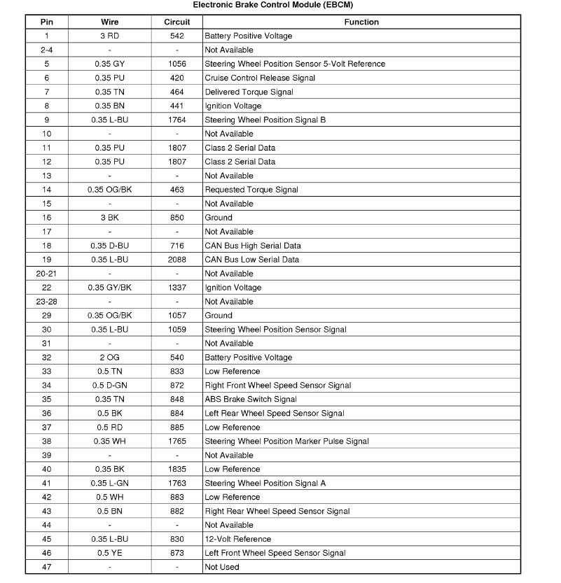

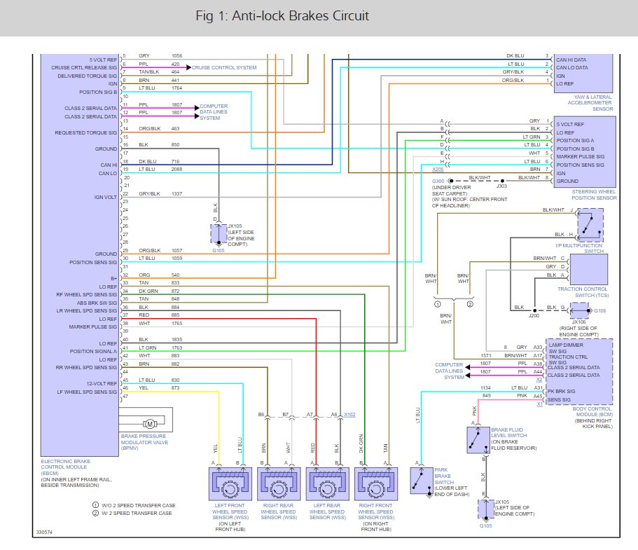

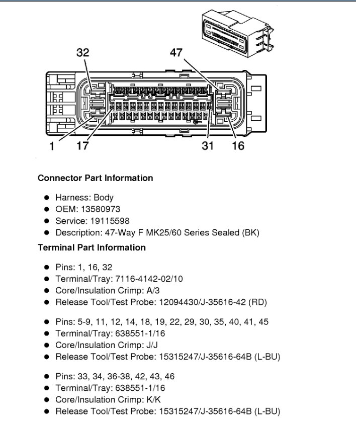

Yep, those darn squirrels! Here is the ABS module wiring diagrams and the ABS wiring connector view as well in the images below. Please let us know if you need anything else to get the problem fixed.

TNSANDMAN
Help needed! So, I'm helping a widow in Tellico Village out by repairing squirrel damage under the hood of this truck listed above. I fixed all the windshield wiper wiring, throttle body and some of the ABS pump harness. The ABS pump area is a nightmare. I'm de-pinning the harness to solder-extend-repair but I can't find the end of a few wires.
Does anyone have access to a wiring diagram via AllData or something similar?
