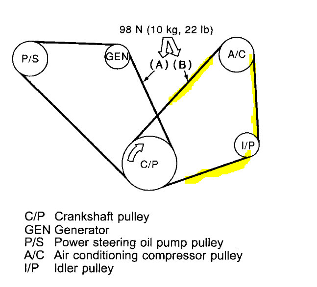

It is likely little more than just tightening the belt.
By the way, does the belt appear to be too loose, with the engine off.
Looking at the diagram, I think that belt that is making the noise is for the A/C. So, it primarily runs the A/C.
It should go around the A/C compressor and the crankshaft and an idler pulley.
So, if you can remove that belt, you will be able to drive the vehicle without worrying about it braking as you are driving. Also, since this is the A/C belt, it will not affect anything besides that it will not turn the compressor (which will be no A/C, but that should not be an issue with this weather).
The issue is that belt can only be removed if the other larger belt gets removed first. Which you cannot do without tools.

I see, what kind of tools are we talking about? I can get a socket set, if need be, and I found a tutorial for changing a 2004 Forester's belts that I will link below. If it is the A/C belt, I can remove it and then order a new one and replace it myself. But as far as getting home, if a socket set is all that is standing in my way, then that is more than doable.
Feb 3, 2022 at 11:42 PM
SQM
  • 6,383 POSTS
That instruction is the same one for your vehicle.
So yes, if you can remove the belt then it can be driven without worrying about the belt snapping off and causing issues. Especially the broken belt can get tied up on the other belt and damage it or break it.

I do have one more question. So, I have thought about what I am going to do having limited resources and such at work. Theoretically, if I am going to replace the belt anyways, I have debated just cutting it. My question is though, is there anything that the idler pulley does that will be affected by removing the belt? That is my only remaining concern as the final pulley will still be engaged by the remaining belt. If I get to it before you see this, I will let you know how it goes. LOL
Feb 4, 2022 at 2:55 AM
SQM
  • 6,383 POSTS
In this particular case you can cut the belt, since there is not a spring loaded tensioner, it should be just fine. The idler pulley is there just to properly guide the belt.
