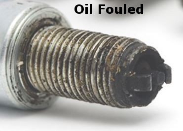

Good morning and thank you for the thorough background on your issue.
This could be any one of a number of things but lets try to narrow it down a bit before we go wild on guessing. I noticed that you did not list any codes. Am i correct in assuming that your check engine light is not on?

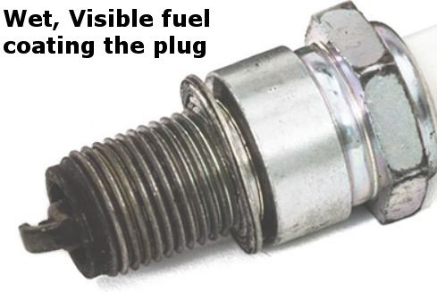

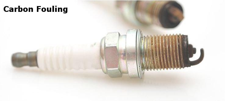

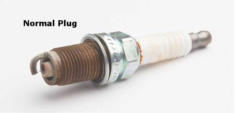

The first thing I would like you to do is "read" the plugs. I know you replaced them recently so we can rule them out as the culprit but we need to read them so we can start diagnosing the problem.
See the attached pictures, or if you want, you could take pictures of your plugs and I can read them for you, just label them 1, 2, 3, etc.
Let's start there and see what is going on with your engine.
