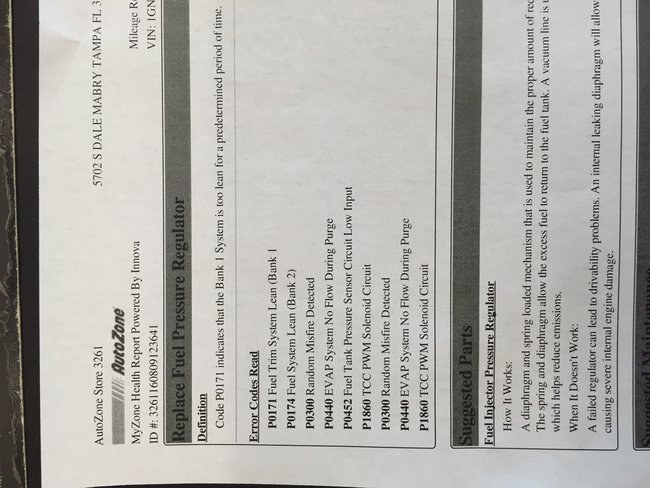

Here are the error codes.
Aug 9, 2016 at 3:46 AM
HMAC300
  • 48,601 POSTS
check fuel pressure with a gauge if a tbi engine it will be 9-11 psi you will need an adapter for this. auto parts rent it. check for a vacuum leak under tbi unit. then have a transmission professional scan for the other codes after you have had the evap canister leak more than likely smoke tested for leaks.

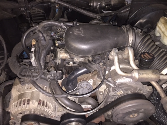

Here is another picture if it helps.

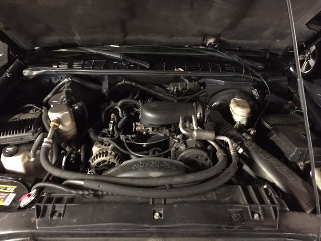

and one more.

does the VIN number say W or Z? that will let us know better I think it is the eight digit.
Aug 9, 2016 at 8:02 AM
BRENDONK22
  • 9 POSTS
This is the VIN: 1GCCS1440R8127906 but it will be for the frame/truck which is 94 S10 but the engine is a 2002 Blazer 4.3V6. Do I need to look for a VIN on the engine block?

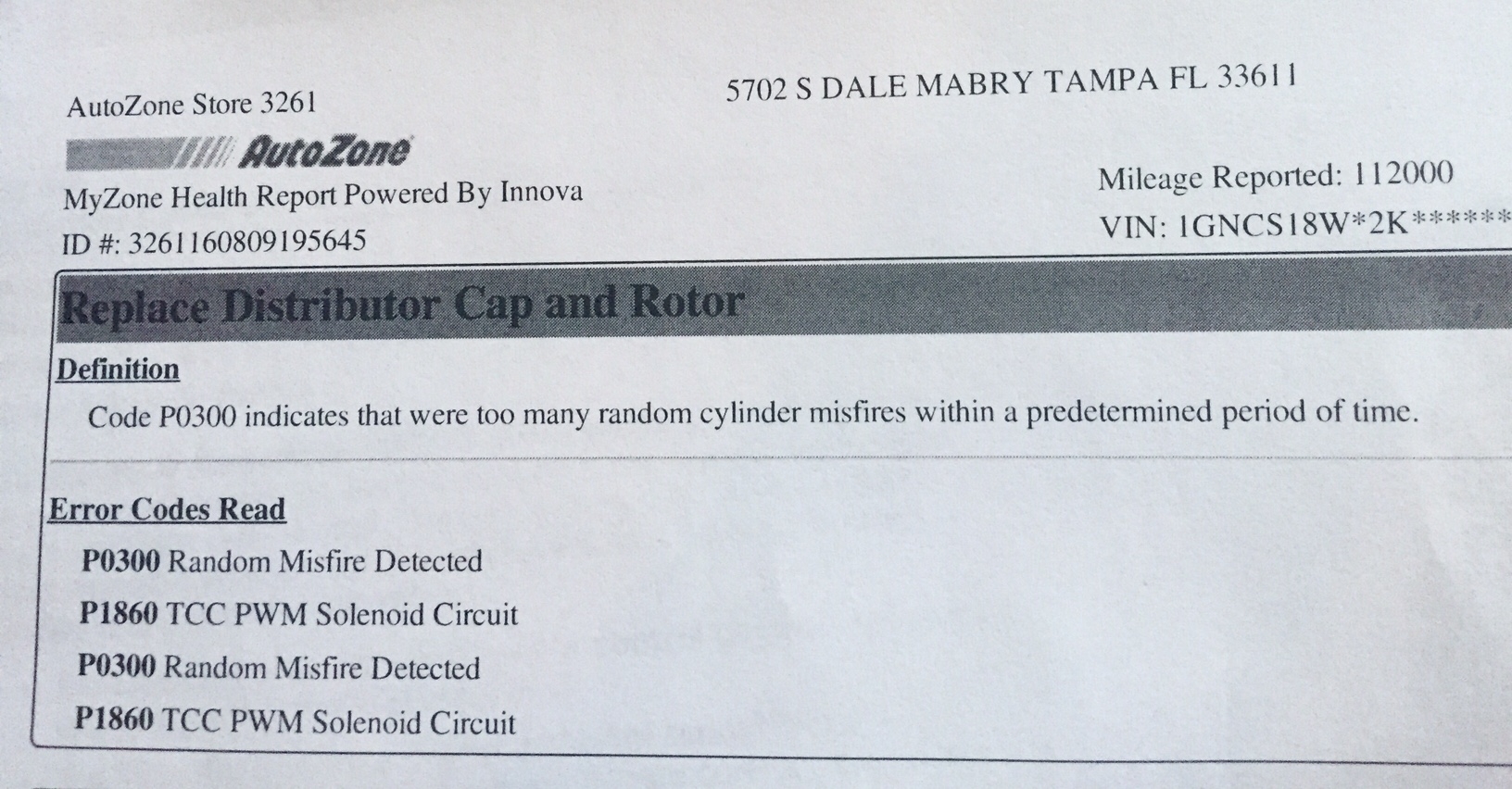

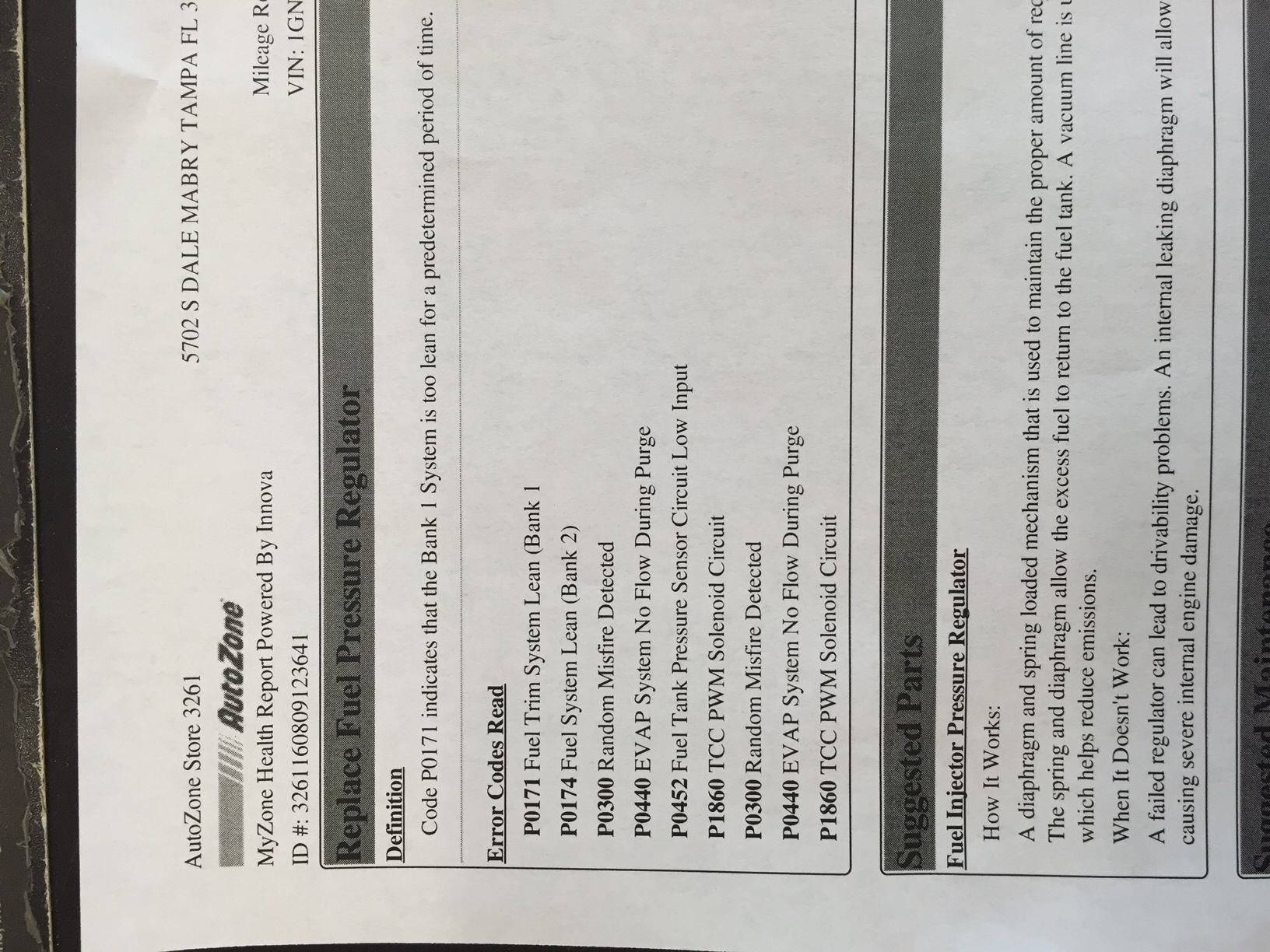

Cleared the codes and this is the new reading.
Aug 9, 2016 at 11:24 PM

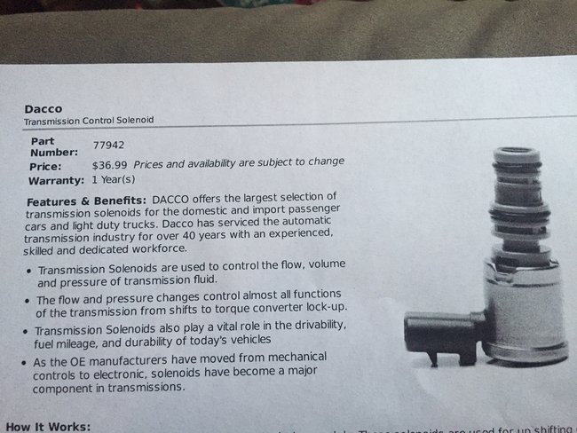

This is what the autozone guy said to replace first.

Sorry wrong image this is the new codes after I cleared it.

if the engine is a 2002 and set up like a 2002 then it should be 60-66 psi with key on only for fuel pressure. the misfire can be a vacuum leak, dist gear and any other sensor or injectors. it needs to have at least 60 psi to run as well as maybe be the cause of a misfire. it should have a pro do a freeze frame on it. If you are running the 94 system on the 02 engine then that may be your problem because the computer is different and will not adapt to a 02 system which is OBD2 the 94 is OBD1try to get a freeze frame done locally by a mechanic.
