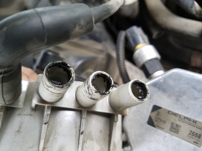

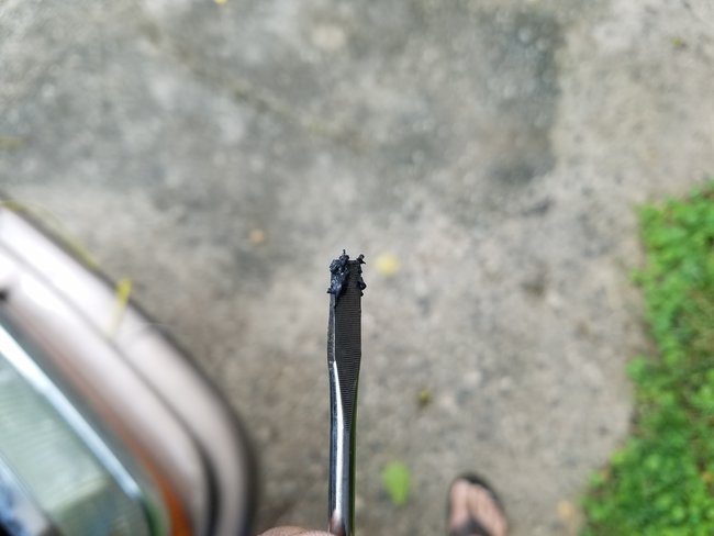

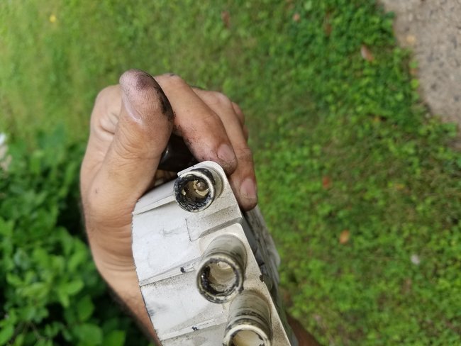

So I hadn't touched it in a few days. Raised the hood today and took the distributor cap off. Looking at the even side of the cap, I see this gunk down in the where the plug wires connect. I think the plug wires are getting hot on that side and melting in there. Would that be because the resistance in the wires is too high? I went ahead and ordered new wires and creamed the contacts inside the cap.
Jun 25, 2017 at 7:23 PM
  • 54,832 POSTS
Good find, please order AC Delco stuff, you can find it on Amazon for cheap.
Jun 28, 2017 at 12:12 PM
THEMAILMAN
  • 102 POSTS
My wires came in yesterday. I put them in today, and it runs like a new car now. I swear it feels like I'm driving a Camaro compared to how it was. Funny thing is it finally threw a code this morning (before I put the plug wires in) for a random misfire (P0300). Anyways, thanks for all the help. I'll be back when something new pops up.
