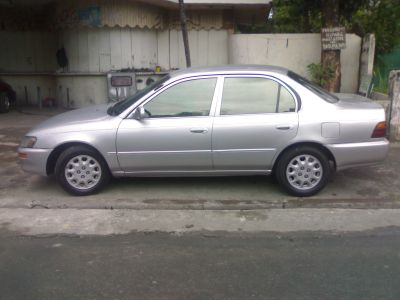

Good day! My Corolla GLi 1993 model EFi 4afe engine has a very low RPM gauge level 100 almost down to zero. When I turn on the a/c the rpm level is steady to 100 and the engine never stops even in full stop. I hope you can help me with this problem, Normally the rpm should be in 800 in normal idling condition but my corolla is down to 100. When I revolution the rpm hardly goes up. Thak you so much for your help.

Remove and clean the idle air control valve, and clean the throttle body.
It would be unusual for a car to idle steadily at 100rpm.

Thanks for answering to my queries, I just finished removing and cleaning the throttle body and the IAC valve attached to the TB. I removed all the dirts, carbon and oil with a 3M carb cleaner and it did a good job. My RPM had gone up to 600 but I feel like I have a high idling even if the rpm level only says 600. The engine is not idling normally. Please advise on what to do next.

Normal idle speed would be 650-750rpm.
The IAC controls idle speed by moving a pintle in and out of the TB allowing more or less air into engine.
If you are using the instrument panel tach. to gauge RPM, your tach may be off.
Best thing is to find a scan tool and read what the ECM is seeing as the RPM.

Thank you for your prompt response. I tried to test drive for an hour and observe the RPM, I observed that when the engine is thoroughly heated up, the idle speed is 800. Now I think I have to bring my car to a service center coz I dont have a scan tool and check the timing as well.
Is there a fuel injection cleaner? What would you recommend? please advise also on how to apply it.

Most FI cleaners will do the job, added to gas tank according to instructions.

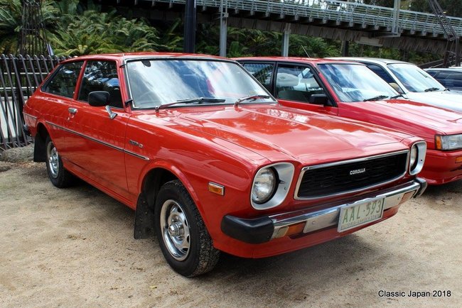

Hi, I have noticed that lately, the tachometer needle twitches randomly, during idle only (usually at stop lights, etc. so she's been driven and is warmed up). The twitch is usually only between 1,000-1,500; but sometimes jumps to over 2,500. I'm not noticing a big difference in how the engine operates when it's jumping up, but on a few occasions it sinks a little below idle, and the engine feels as if it might stall... So I'm keeping my foot gently resting on the throttle, and an eye on the needle. just in case! I've read it could be the igniter, sparks, battery, distributor? My veteran mechanic thinks it's just an electrical glitch and not to worry, but as I can't see him at the mechanic to try an alleviate the issue? Thanks in advance! Cheers! JS ;)

I recognize this car! LOL I hope you are well during these trying times.
As far as the needle, there is a tachometer drive module, but it isn't something that is serviceable. Is the engine at all affected when this happens?

HI Jacob/Nicholas, we're doing okay over here in Australia. hope you're well in the US! Thanks for the reply. as mentioned in the original post.."I'm not noticing a big difference in how the engine operates when it's jumping up, but on a few occasions it sinks a little below idle, and the engine feels as if it might stall." As I'm not a mechanic, I would like know if there are easy checks I can make to rule out anything potentially disruptive? JS ;)

The idea that it is erratic does seem as though it is an electrical issue. The only thing that could be checked would be the tachometer drive module, and in all honesty, I don't think it could be done at home.
I hate to say it, but I suspect you will need to wait until it gets worse to honestly determine what causes is. I don't feel it is anything to worry about at this time. Let me know if it gets worse or if yo have other questions.
