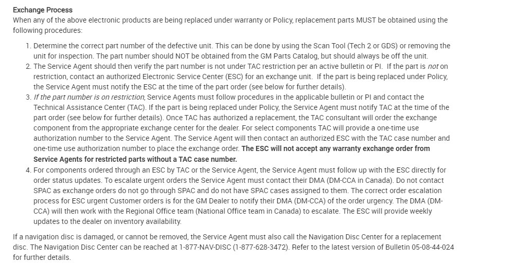

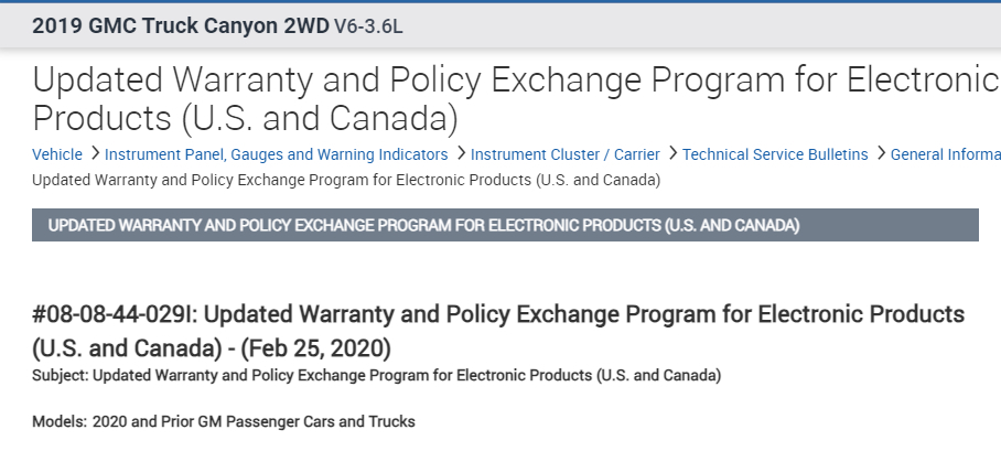

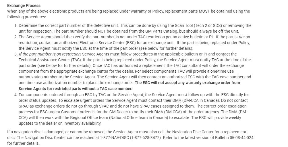

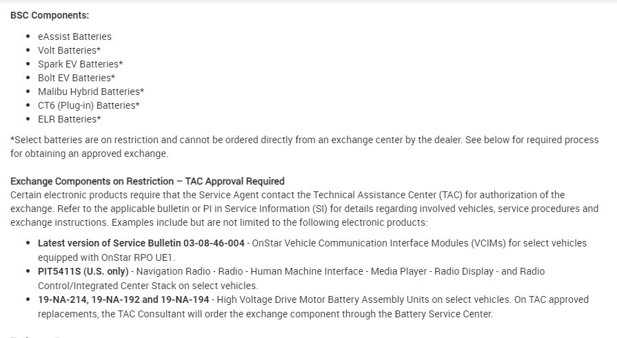

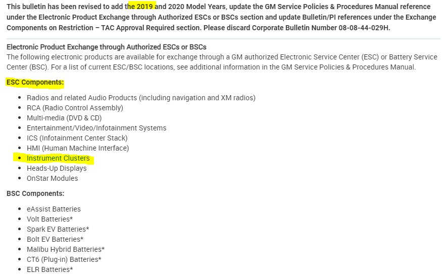

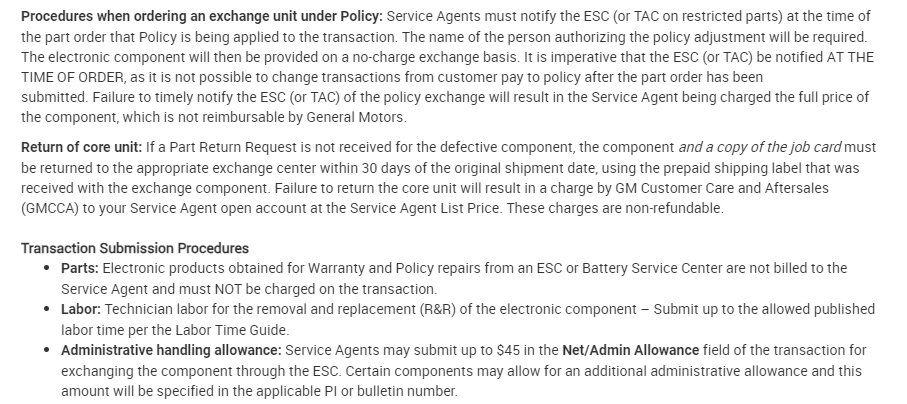

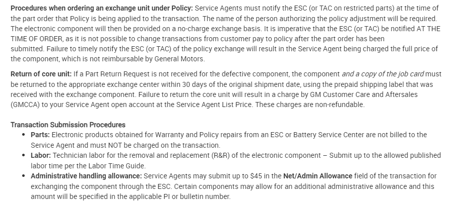

Next, I found an interesting technical service bulletin I would like you to review. I attached it below. I don't work for a GM dealership, so I'm not familiar with the issues. However, the bulletin indicates an updated warranty and policy related to certain electronics. The instrument cluster is on the list.
Take a look through the pics below. It may be worthwhile contacting a GMC dealer to see what they say.
