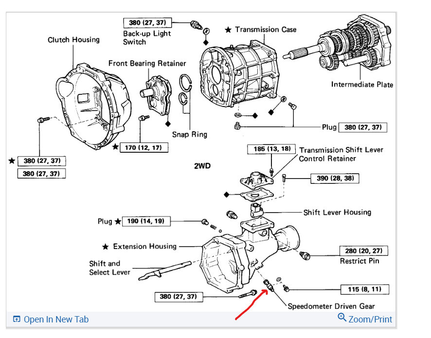

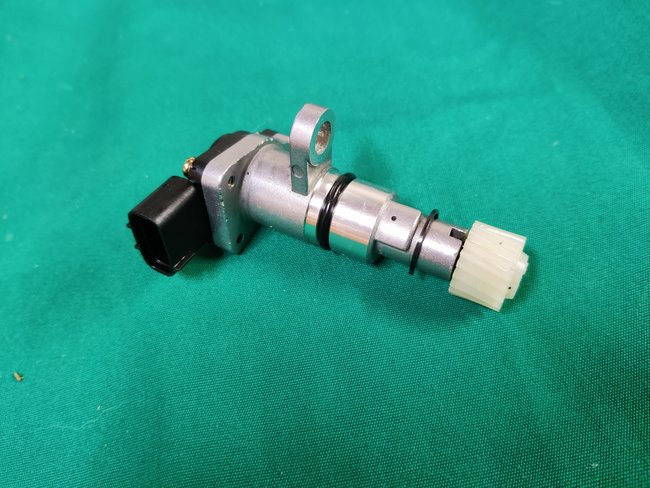

This truck says it has a gear and cable which I would replace to fix the problem. can you get an image of the tail shaft so I can see if there is a sensor? Check the images below to see what I am talking about.
Aug 31, 2022 at 12:53 AM
DWMACKE

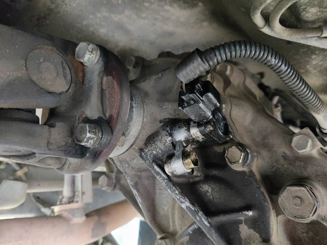

Apparently, part way through the 1993 model year Toyota changed from a cable to a sensor. Mine has a sensor and it's located on the rear of the transfer case on the passenger side of the truck.
Aug 31, 2022 at 4:40 AM
DWMACKE
I bought this cheap ($18) sensor off of Amazon. I had to swap nylon gears because the replacement had the wrong number of teeth and pitch. Once installed, it worked for a few miles and then, like the original, stopped working. I put the original back in. I have to figure that if my Toyota Dealer in Anchorage is selling the Toyota OEM part for $415.00, the cheap Chinese knockoff might not be built to the same standards.

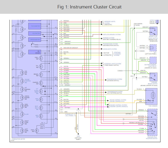

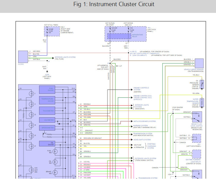

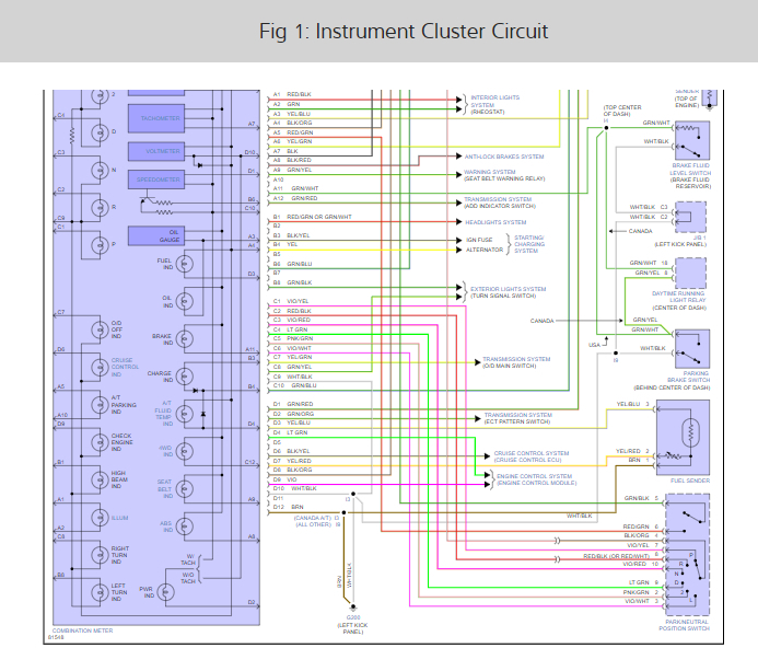

Yep, good call. I looked at the wiring diagrams for a 94 and there is nothing in-between the sensor and the cluster in case you were wondering. So, it could be the speedo head is going bad FYI. You can get a used cluster and try it.

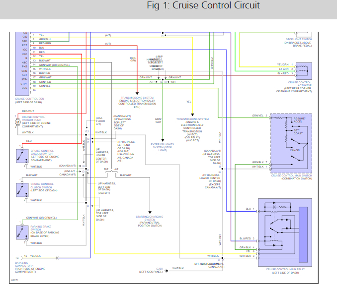

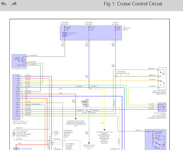

Thanks, Ken. I did some further testing and found OBD1 Code 42 "Vehicle speed sensor circuit" when I jumped the TE1 and T1 terminals in the diagnostic connector. I guess I'm not understanding how this circuit is laid out. From where does cruise control get its signal input? Does it receive it from the Speedometer cluster? How does the ECM figure in all of this?
Sep 2, 2022 at 2:58 AM
  • 55,267 POSTS
Sure, the speedometer input is brought from the sensor and fed into the cluster and then from the cluster to the ECM. here is the wiring diagram so you can see the way the system works. Check out the diagrams (below). Please let us know what you find.
