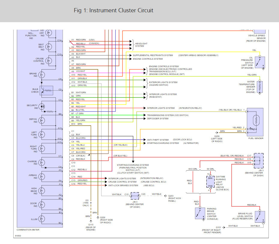

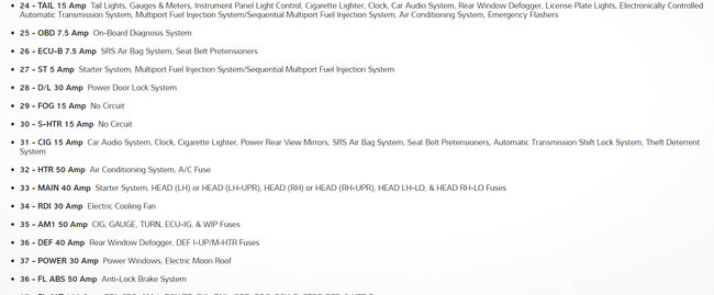

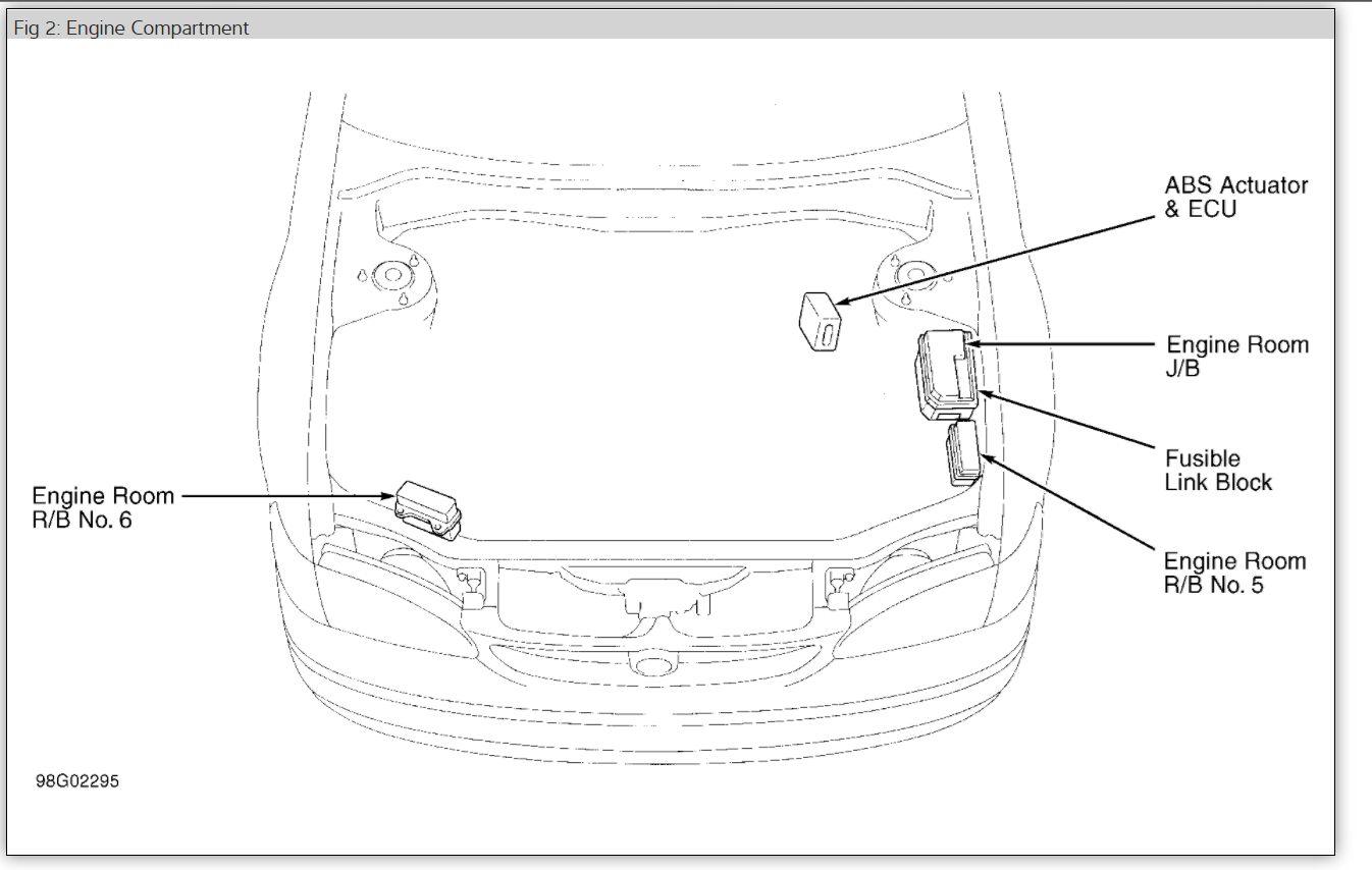

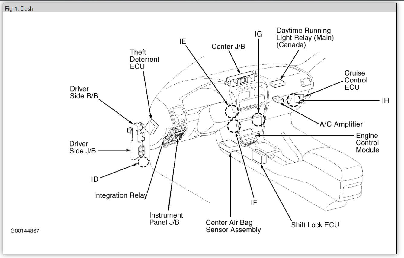

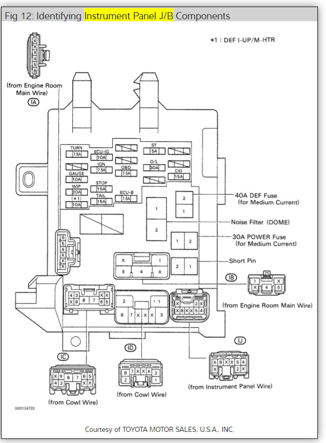

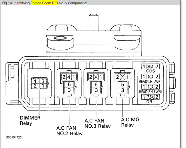

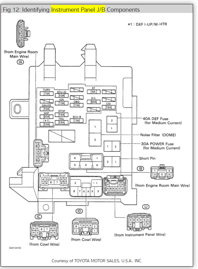

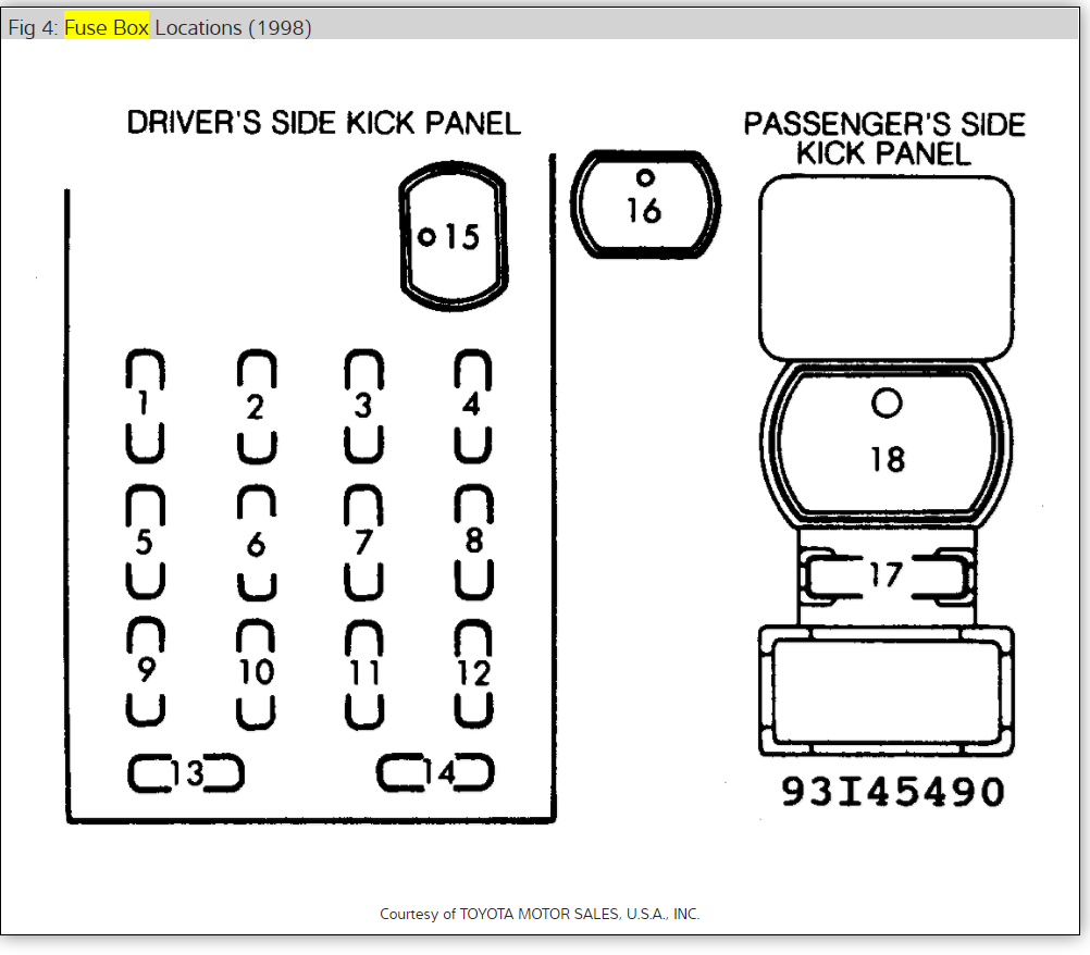

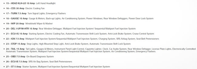

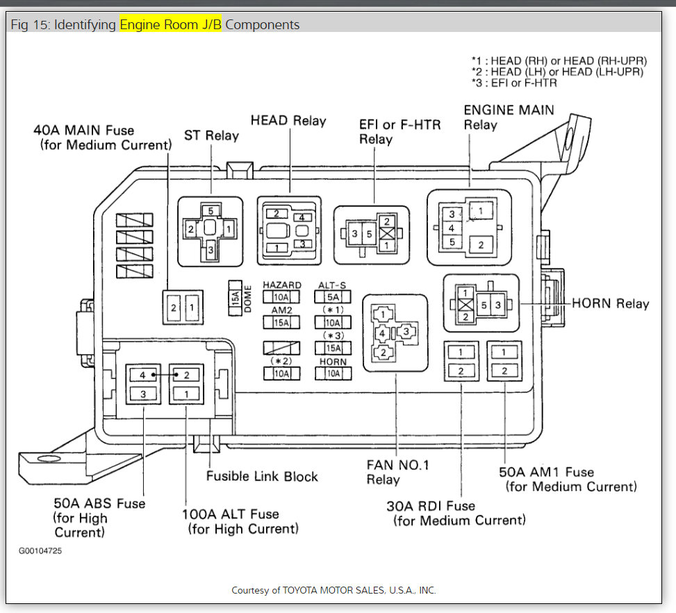

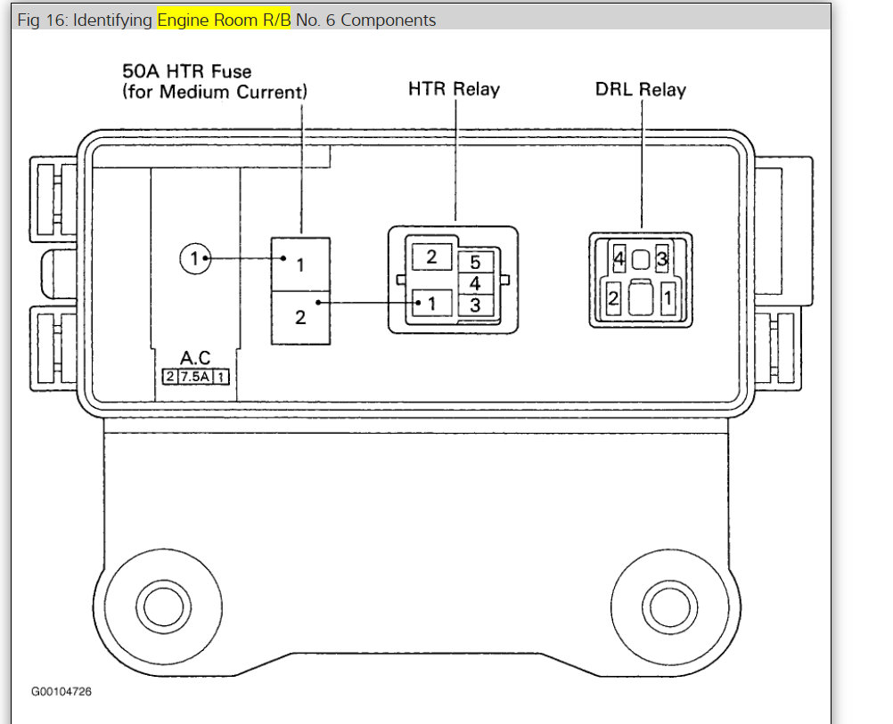

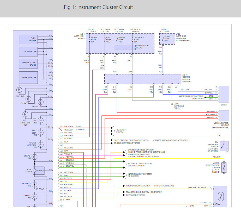

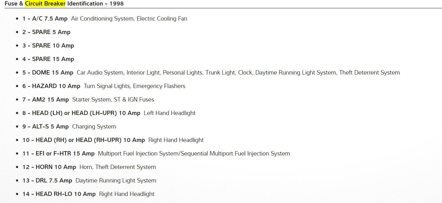

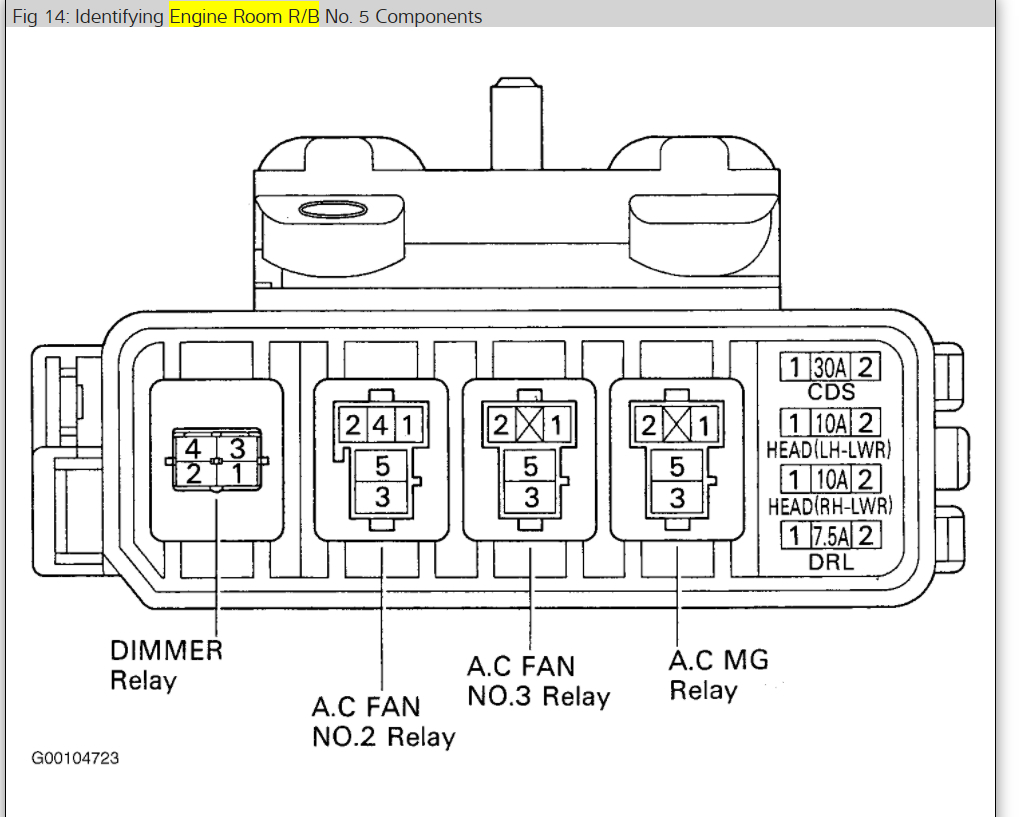

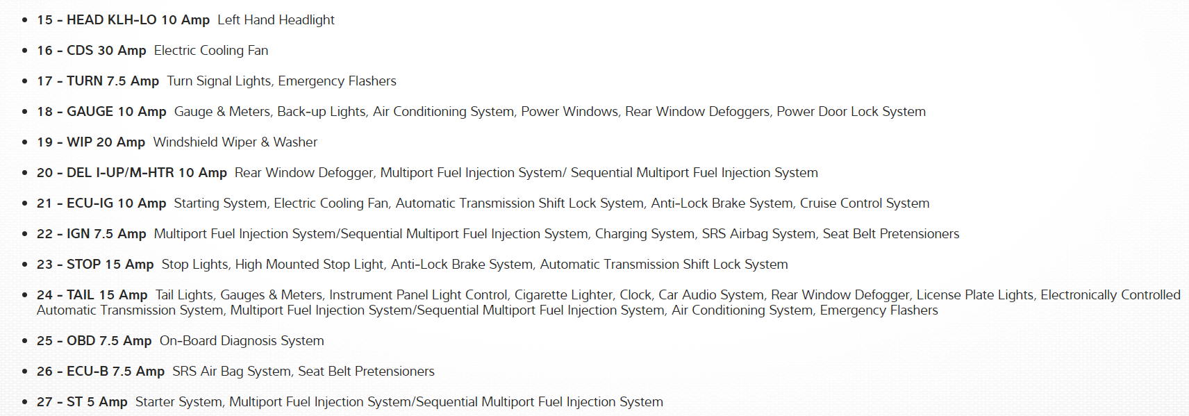

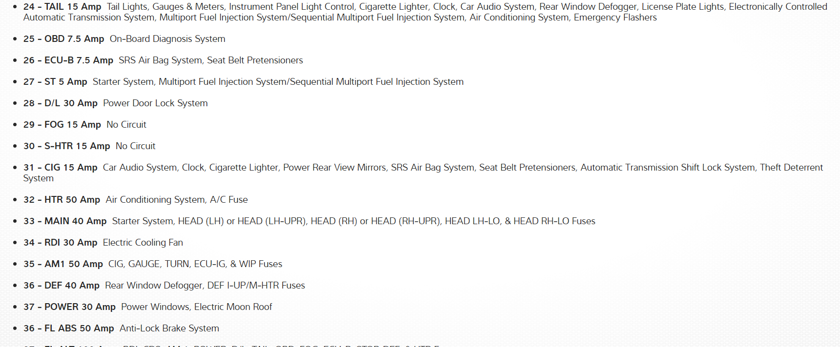

There are five fuses that run the cluster. use this guide to check for power and the cluster wiring diagrams to see which fuses need to be checked:
Jun 25, 2019 at 6:06 AM
HONUGIRL2591
  • 7 POSTS

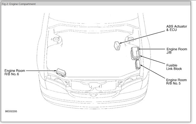

Mahalo Ken for your response. Fuses in the interior and under the hood were checked and are operational.

I would check for power and ground at the connector and if okay I would replace the cluster with used/rebuilt.

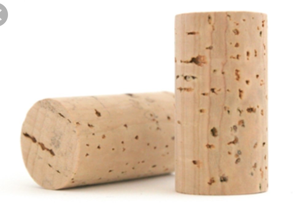

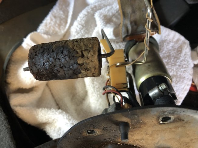

Okay, so checked the sender and cleaned it funny thing though there is a cork for the float like a wine cork. Is that even normal? Okay, so here’s the stupid question, how do I ground that wire?
Jun 30, 2019 at 12:32 PM
  • 55,433 POSTS
Cork? Can you send a video/picture you can upload it here. This could be the problem.

HONUGIRL2591
  • 7 POSTS
Aloha Ken,
I’ll try and take it back out but this is what it looked like attachéd to the float lever.
Jul 1, 2019 at 4:32 AM
  • 55,433 POSTS
lol, that's a good one. I would replace the sender but while it is out connect the wiring and turn the key on and move the float up and down to see if the gauge moves. please let me know.

Aloha Ken,
Below is the photo of the cork float. Okay, so tested the sender while out of the tank. Gas gauge slowly climbed. We replaced the cork float with another float and reinstalled pump back into tank. The gas gauge continued to climb to full which is where the gas tank is currently. Then the gas gauge dropped to empty.
Jul 6, 2019 at 9:26 AM
HONUGIRL2591
  • 7 POSTS
Oh and now with pump out of the tank and plugged in when I move the arm to the full position the gas gauge does not move. Argh!
Jul 6, 2019 at 9:42 AM
  • 55,433 POSTS
It sounds like the sender is bad, can you ground the sensor wire and have it go to full, then unplug the sender and it should go to empty. Let me know.
