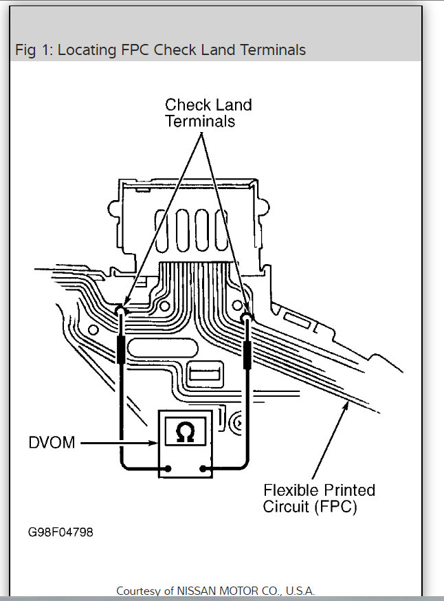

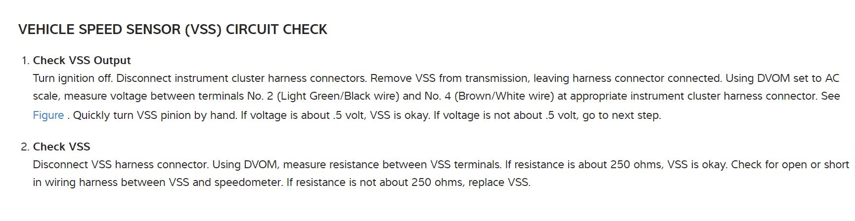

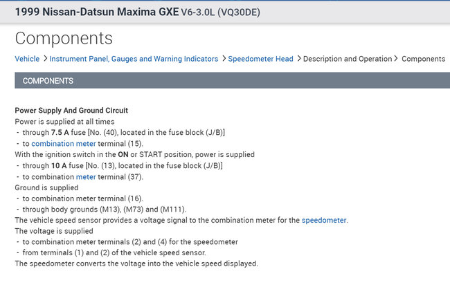

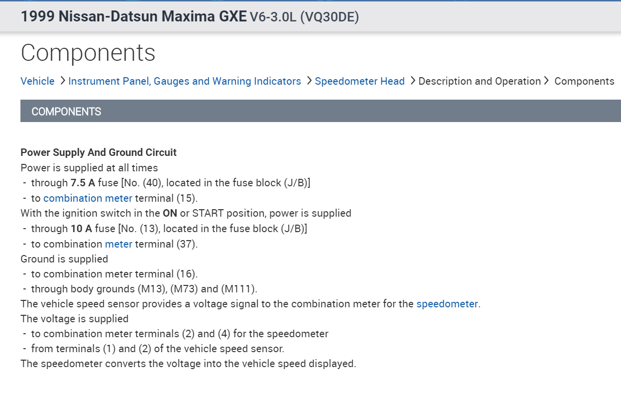

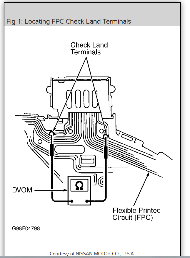

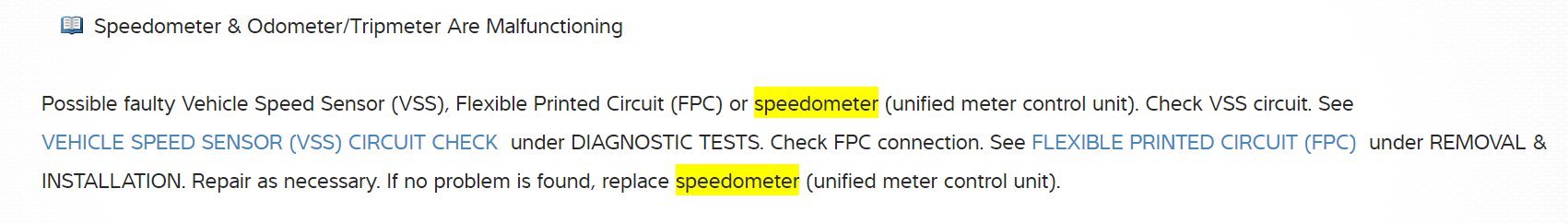

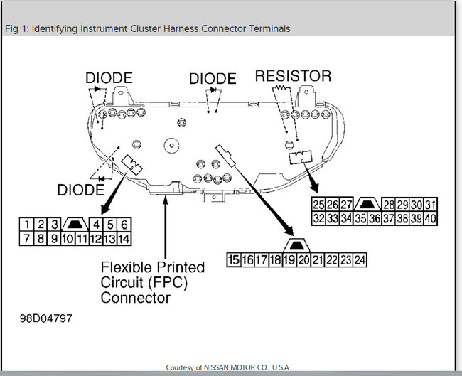

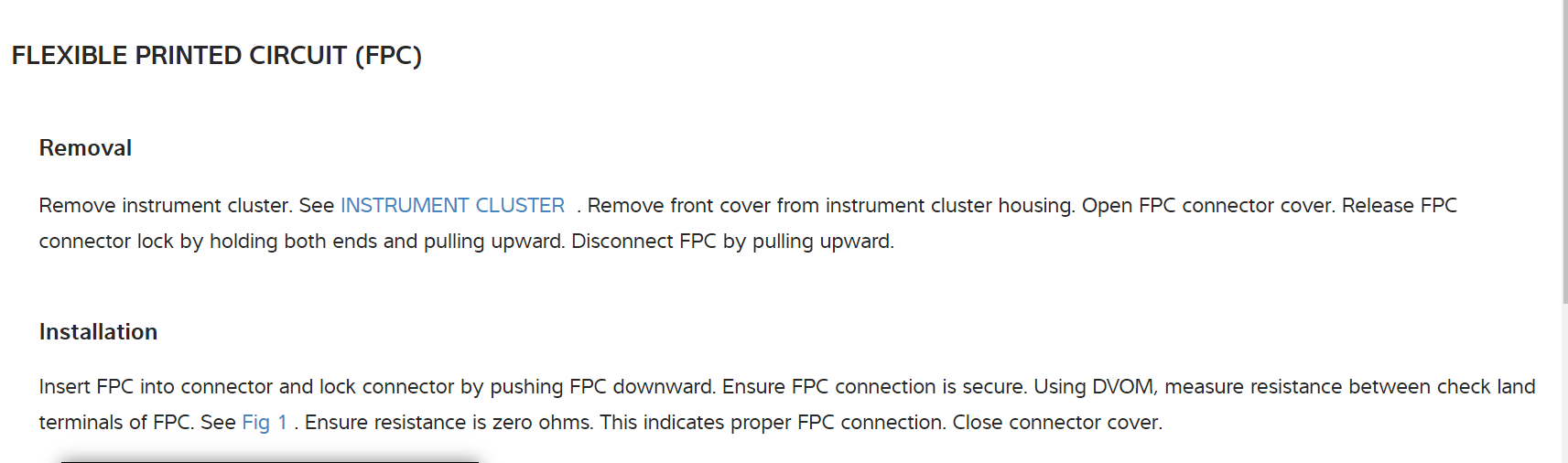

So my husband replaced the speed sensor and did the codes but the speedometer it still isn't working.
Mar 10, 2019 at 1:47 PM
SCGRANTURISMO
  • 4,897 POSTS
This could be a problem with the Flexible Printed Circuit. I have included in the diagrams down below a troubleshooting guide from the vehicle's manufacturer on the speedometer. Please go through it and get back to us with what you find.
Thanks,
Alex
