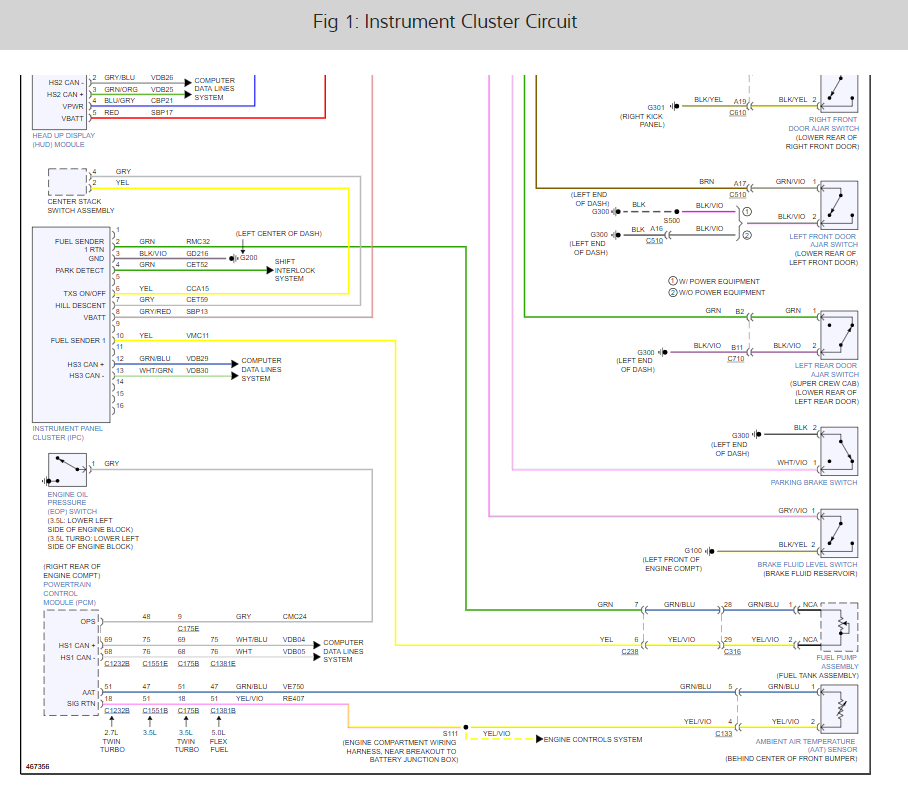

How do you fix a speedometer that is not working and the truck is shifting funny as well with a check engine light on?
Nov 21, 2020 at 10:18 AM

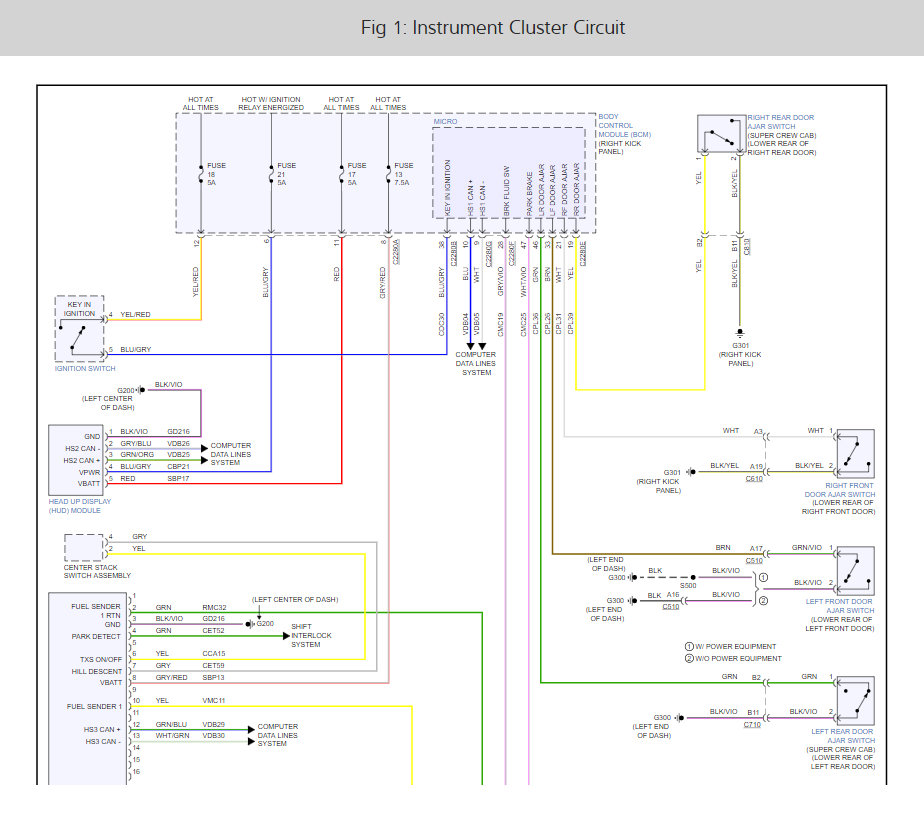

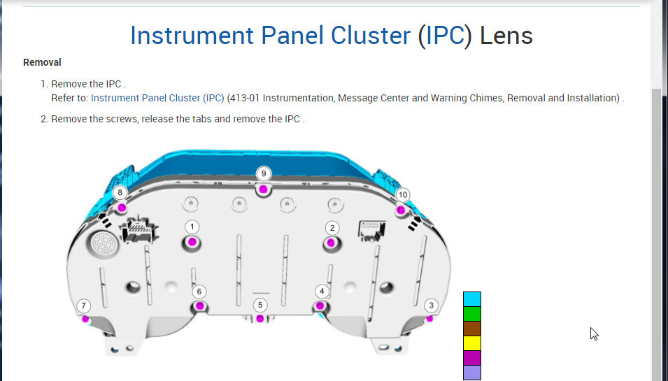

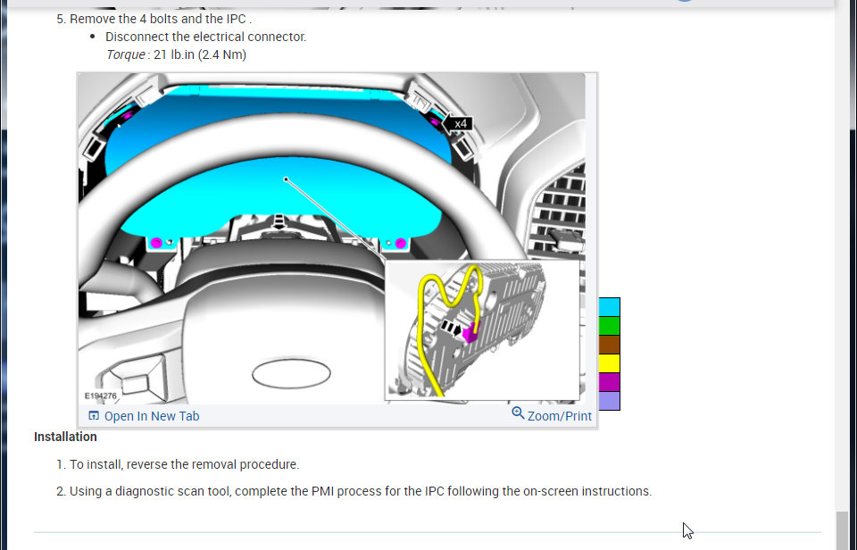

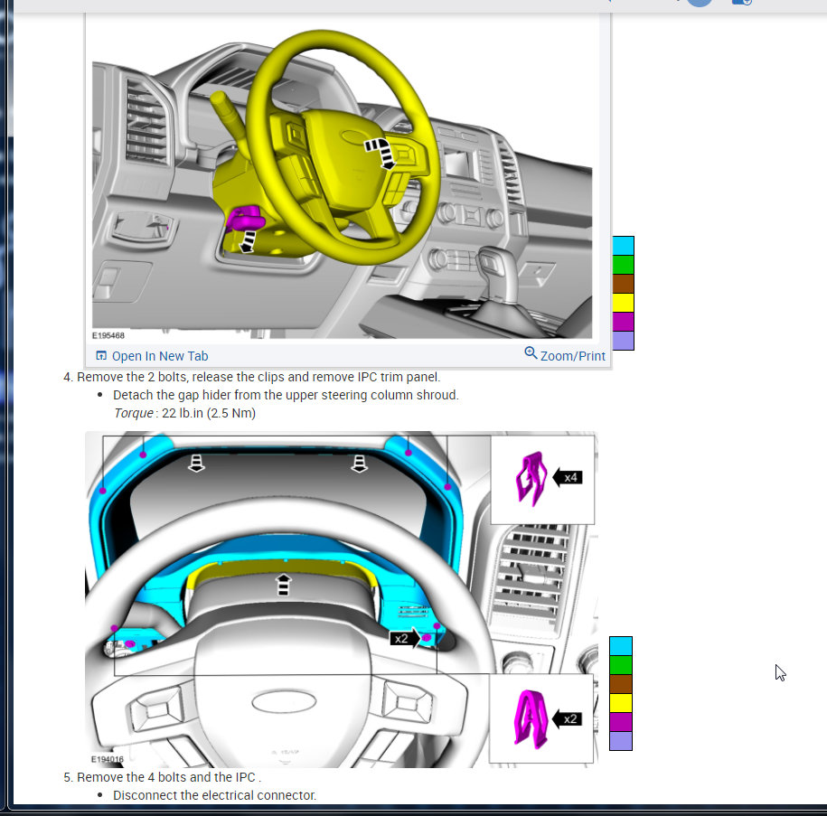

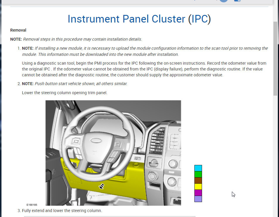

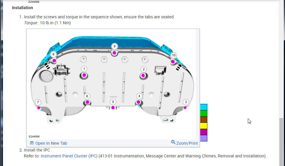

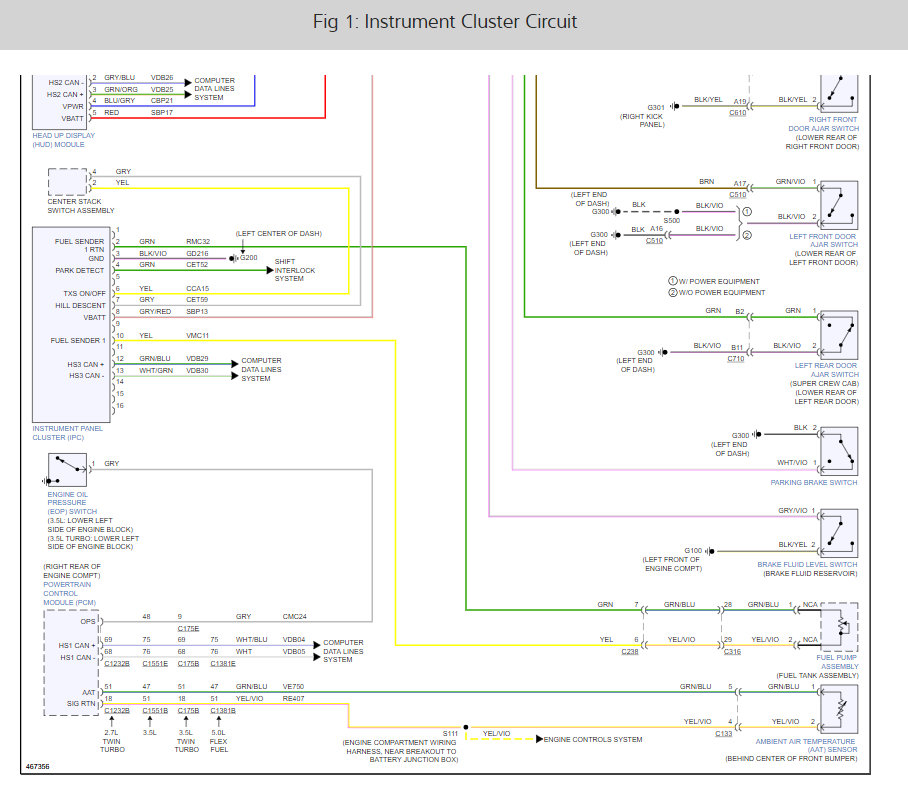

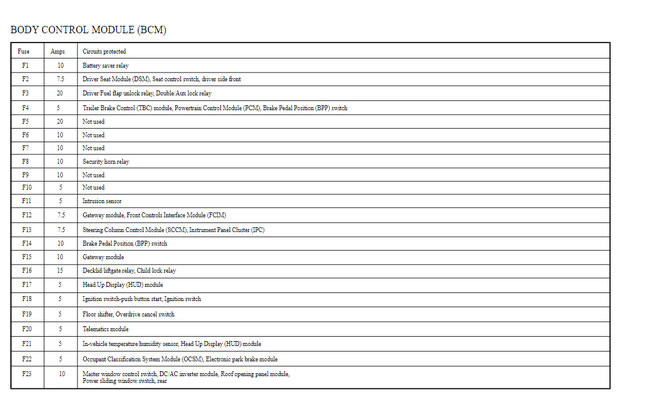

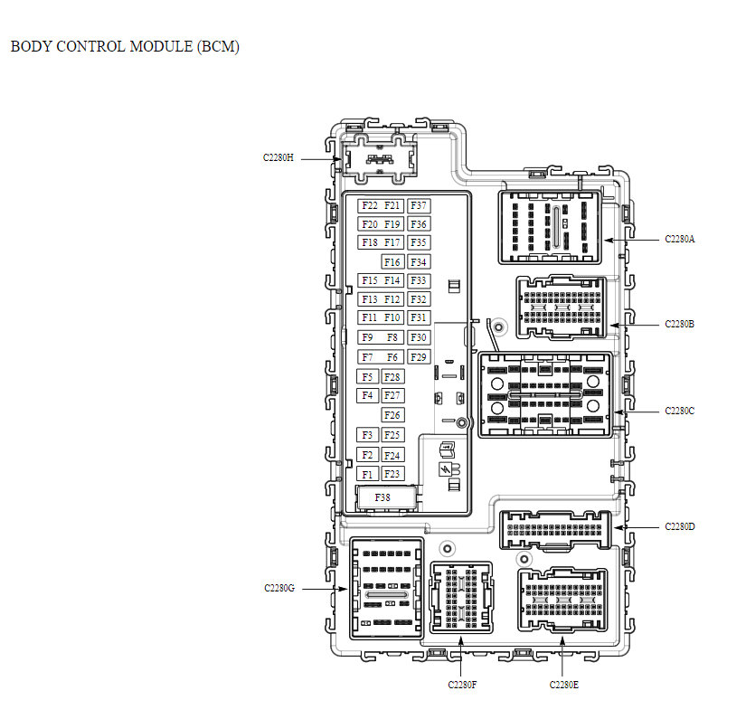

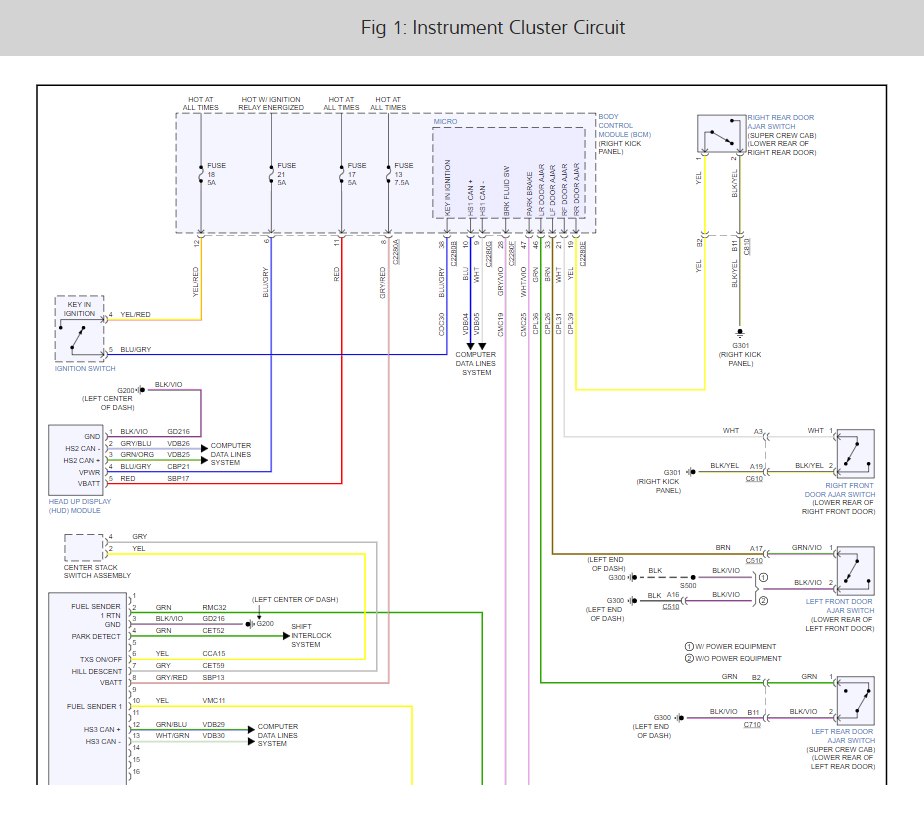

Let start by checking the fuse # f18, f21, f17 and f13 on the BCM here is a guide to help you with the cluster wiring diagrams below so you can see how the system works. I am also giving you how to remove the cluster so you can check the connection and if all the fuses are good you will need a rebuilt cluster as well. Here is a guide to show you how to check the fuses and there locations as well.
This video shows the job being done on a similar car but the process is the same.
https://youtu.be/_HEC44xENxw
Check out the diagrams (Below). Let us know what happens and please upload pictures or videos of the problem.
Nov 21, 2020 at 3:18 PM
PARTYBARGECAPT
Thanks for the quick response. It was the cluster I checked the fuses and there are all okay so I watched the video and it gave me the idea to get a rebuilt cluster worked perfect!. this site is the best.
