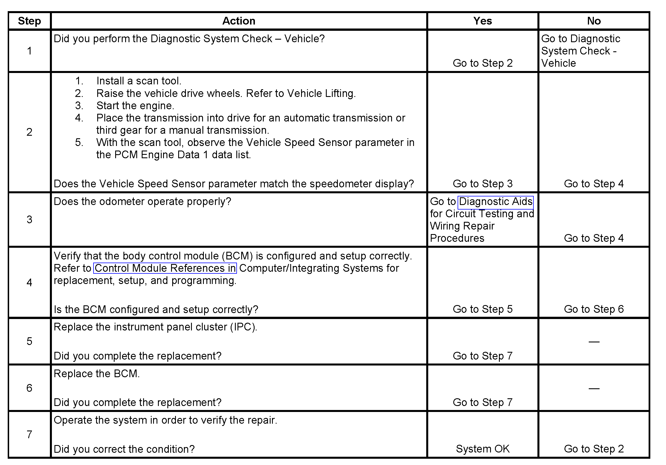

My speedometer says I am going faster than I actually am.

The speedometer in this vehicle is different than the traditional ones. Basically, the body control module (BCM) receives a signal from the wheel speed sensors. Based on that information, it sends a signal to the Instrument Panel Cluster (IPC). Now, if there is a fault with the wheel speed sensor/ vehicle speed sensor (VSS), the main computer will set a diagnostic trouble code indicating a fault. Therefore, the first thing you need to do is scan the computer to determine if there are any related fault codes stored.
Here is a quick video related to using a scanner. I realize most people do not have one, but just in case. If you do not have one, most parts stores will scan the computer for free.
https://youtu.be/YV3TRZwer8k
If there are no faults in the VSS circuit, then either the IPC is bad (speedometer and cluster) or the BCM is bad. I have attached a flow chart for diagnosing the issue. Take a look through it and let me know if you have other questions or need additional help.
Please keep in mind, before you replace any components, always confirm there is not a simple issue such as a loose connection or corrosion on one of the connectors causing issues.
