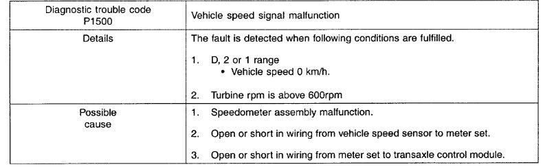

The speedometer itself may have failed, but there could be a wiring issue or a problem with the transmission control module.
What I would suggest is this. Have the can-bus scanned for codes. CAN stands for controller area network. Basically, all the different computers/modules are tied together via a few wires. This type of scan will retrieve the codes regardless of the module storing them.
Here is a link that explains how it's done:
The reason I suggest this is because although the speedometer could be bad, there are other things that can cause it as well.

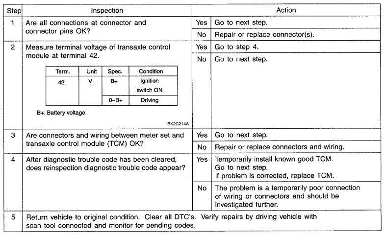

I attached diagnostics for a P1500 below which is simply related to a vehicle speed signal fault. If you scan it, there may be a code more specific to the cause.
Take a look through the diagnostics and let me know if you are comfortable performing them.

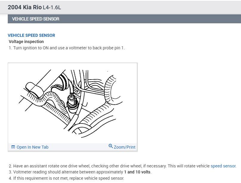

Okay, now, I checked everything again now the wires with voltage that goes to speed sensor don't have any voltage coming out! That's why I don't have a speedometer!
Aug 29, 2022 at 11:31 AM
  • 110,194 POSTS
Try the test I listed below. If there is no voltage from the sensor, either the drive gear is bad, or the sensor has failed.
See the directions below.
Let me know what you find.
See pic below.
Aug 29, 2022 at 6:34 PM
