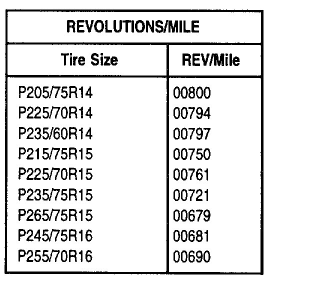

First, are you using the OEM size tires? A larger tire can cause this. If they are correct, then I can tell you there was a technical service bulletin related to a non-working or inaccurate speedometer issue. It did require the reprogramming of the select modules in the vehicle based on specific options. I will attach the TSB so you can review the problems and fixes.

5. ENTER TIRE SIZE/REVOLUTIONS PER MILE (REV/MILE)
pic 1
NOTE
THE TIRE SIZE MUST BE ENTERED AS A REV/MILE CALCULATION. REFER TO THE REV/MILE CHART FOR THE CORRECT CALCULATION.

Let me know if you have questions. Since your vehicle is not 4wd, chances are the only update needed will be to the GEM.
