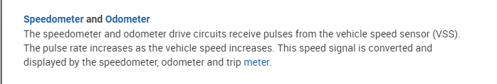

My odometer went out first. Then about a month later, the speedometer stopped working. After another few weeks, the car stopped running. It cranks but doesn't start at this point.

Sounds like you have a couple different issues, and I don't think they are related. They could be but we don't need to worry about the cluster issue if the engine won't start.
So, I am changing this title to address the no start first and then we can address the cluster issue.
