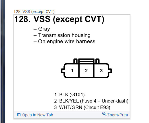

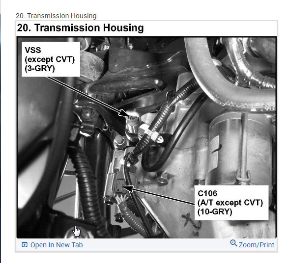

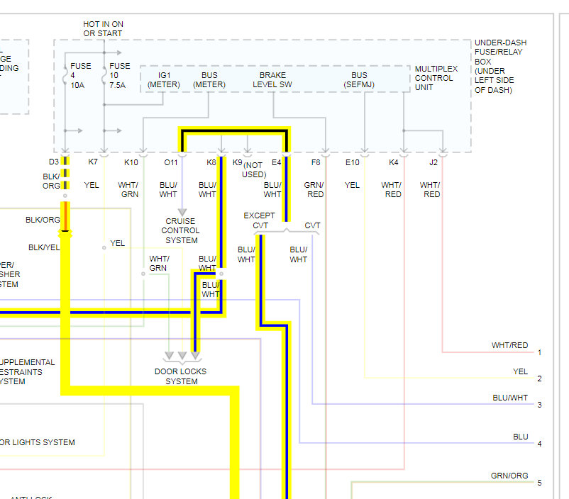

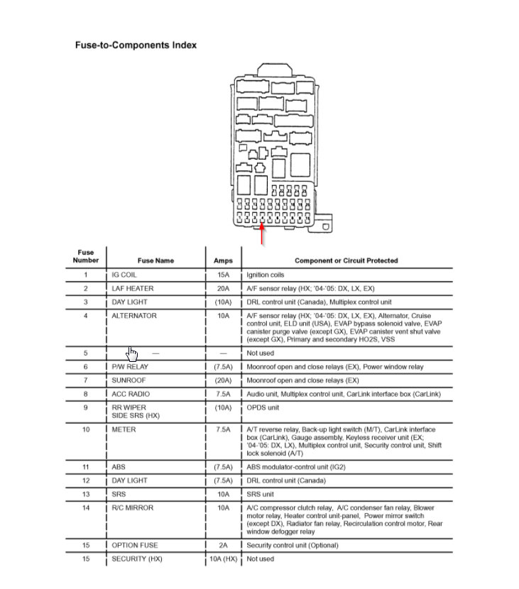

I have no speedometer. I have replaced speed sensor and trying to locate fuse for speedometer. I have the car listed above ep2 facelift 1.6 2004 .
Dec 6, 2020 at 1:36 AM

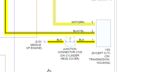

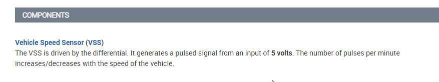

We need to start by finding out what voltage is coming from the sensor. I attached the info on the vehicle speed sensor and as you can see it is supplied voltage and has a ground and signal wire. The signal wire is on cavity 3 and we need to monitor voltage coming out of the sensor while you have the vehicle on jack stands and you put it in gear just to drive slowly. You should see the voltage go up and down.
Then we need to make sure the ground is good by checking resistance to ground.
Here is a guide that will help with this type of stuff:
I also attached the fuse location but it is a shared fuse so if you were thinking of just pulling it, I don't think it will work.
Let us know what questions you have.
