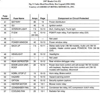

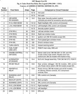

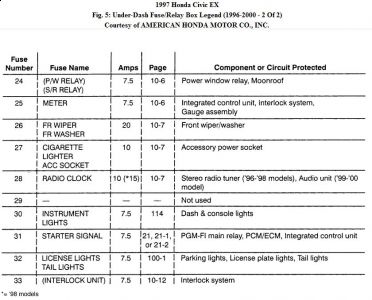

i need to know which fuses are for what in the fuse box the old cover is missing and I dont know which one is for what
Friday, October 9th, 2009 AT 8:27 AM
KHLOW2008
MECHANIC
41,814 POSTS
Hi evalle,
Here are the fuse box legend.
Underdash
Underhood.
