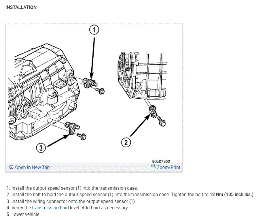

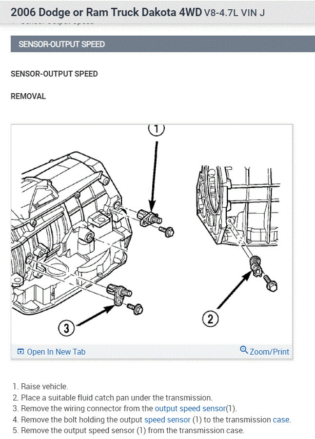

I recently purchased a older truck listed above crew cab to be exact, and I have the brake like on the dash, my speedometer twitches while driving, the previous owner said it was speed sensor, and bought part but never installed. Wondering if his diagnosis is correct and how to change the sensor out?

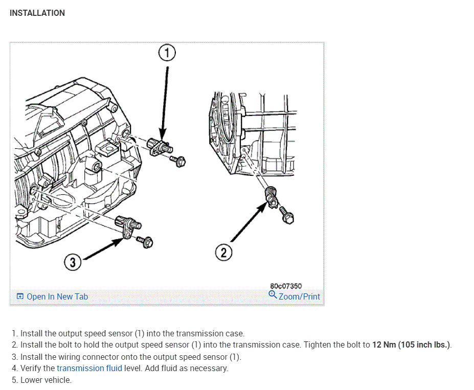

Next, the VSS can cause an issue with the speedometer. However, it could also be a wiring issue, connection issue, PCM issue, or instrument cluster issue.
If you have the new part, I would install it to see if it helps. I attached the directions below for replacing it.
If that doesn't take care of the problem, scan the computer to see if there are any diagnostic trouble codes stored. Here is a quick video showing how it's done:
